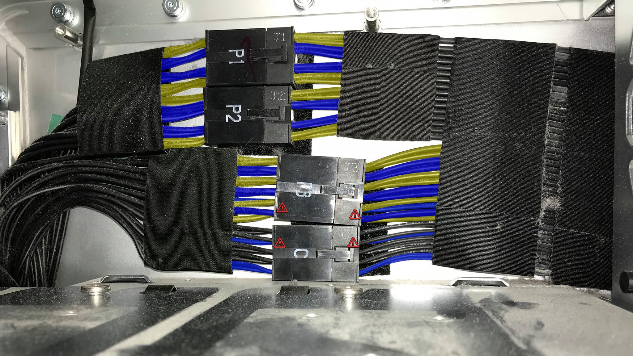

My first goal is to try to establish the pinout of the PSU. It uses 4 large plugs (behind the optical drive bay).
The top three I know are 12V and ground only thanks to this photo
In this article about tapping the PSU for GPU power:

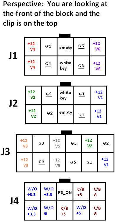

I found this diagram on a forum that seems to agree with the previous one in terms of 12V and Ground locations sbd seens to give the rest. More importantly, it also gives a location for the PWR_ON Pin that might lead me to be able to hot-wire the PSUs I have to read the voltages.

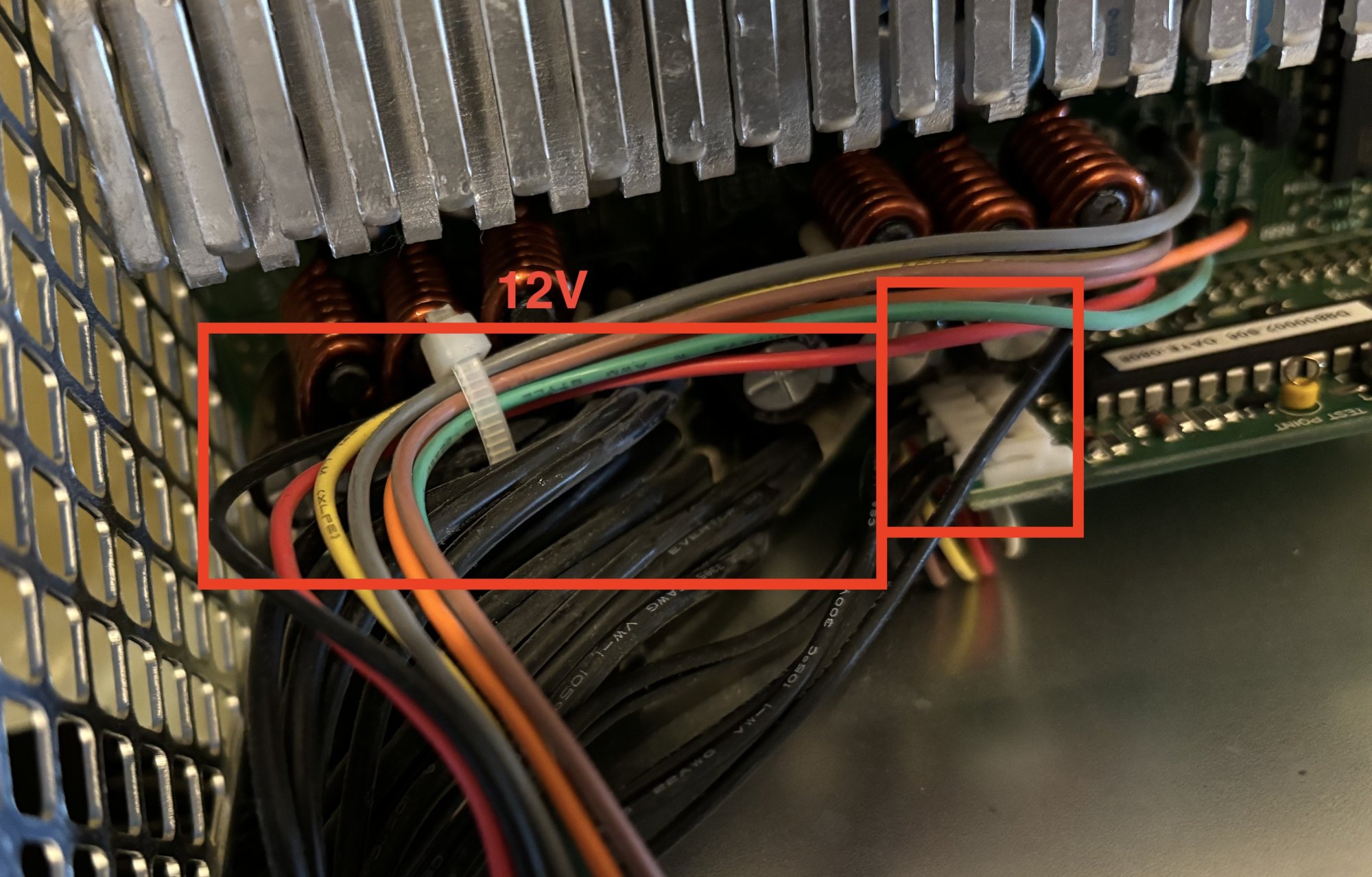

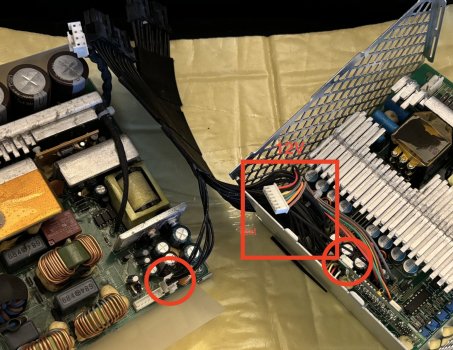

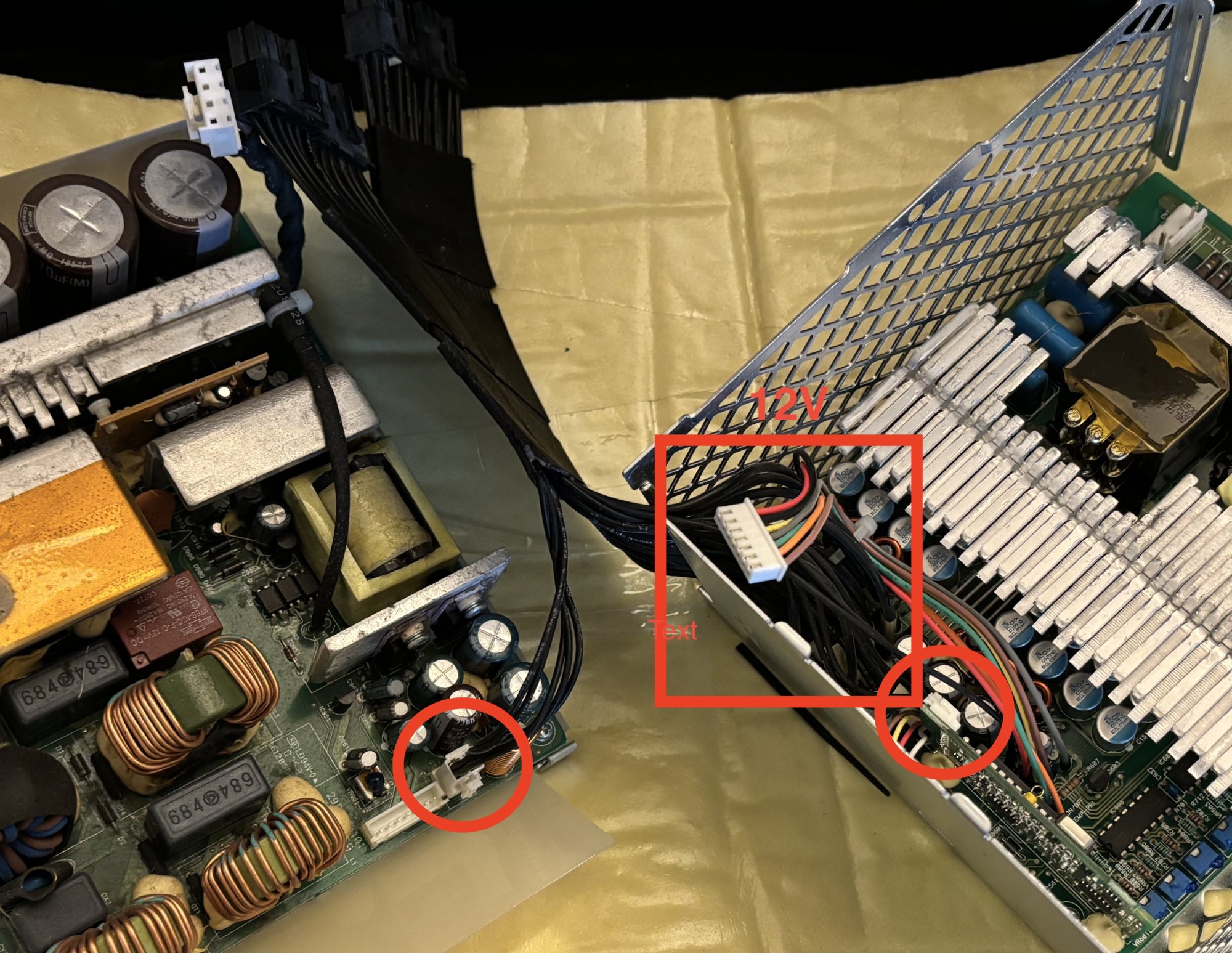

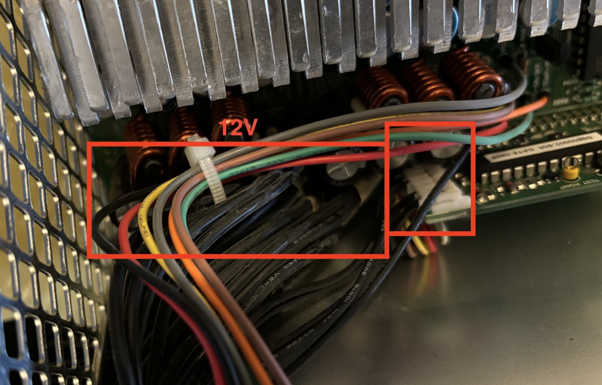

I split the PSU open and found something interesting. All the cables break up into 3 distinct groups. One small cluster attaches to the upper board alongside the high-voltage side. One group of fairly thing wires attaches to a riser board on a plug. The remainder (all 12V and ground as far as I can see) all link to the main lower PCB directly.
This would indicate to me that the three areas correspond to the three present voltages. It makes sense the large low-voltage section would control the 12V as it makes up the bulk of the power capacity. The two smaller sections would thus be 3.3V and 5V I think.
