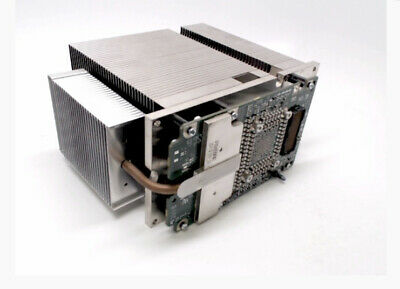

So I searched on eBay and found a pair of air cooled PowerPC (probably single core) processors clocked at 1,8 ghz.
Now, here is my plan.
I thought that I could try my old cpu cards with the new air cooled heatsink. And if that heatsink wouldn’t be able to cool the two core beasts, then I would use the new 1,8 ghz cpus and their appropriate coolers.
Do you guys and girls think that one of these options could “work”?

Today, I found these CPUs. They claim to be compatible with Late 2005 G5s, which is my case.
I should rather buy these than the old ones I found, right?

Which CPUs?
As far as I know, you will need late 2005 dual core CPUs. They come at 2.0, 2.3 or 2.5 ghz speed. The heatsinks from the 2.0 and 2.3 variants are too large to fit a dual processors setup (unless you do some serious modification). Theoretically, you could turn your quad 2.5 into a dual 2.0 or 2.3 (single processor / dual core) or repair the liquid cooling and make it a quad 2.0 / 2.3 (dual processors / quad core).
