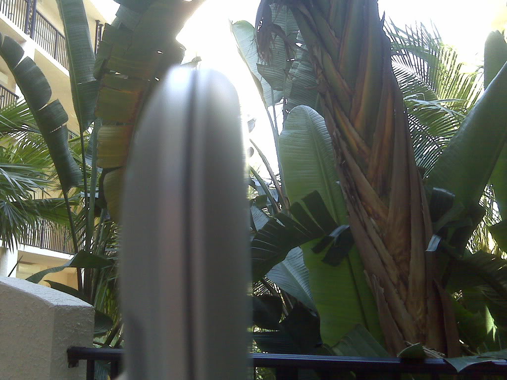

Look for the battery charging spot for reference of how I have the laptop positioned. The battery charging spot is in the bottom left of the picture, you can just see where it starts to indent. The guy put a shim in the corner space and pried the bend up. He pried pretty hard from what I could tell, but I really can't speak to the exact pressure he put on it. All I know is that it worked. Does this give you a better idea of what I'm talking about?
- Put the shim in the black space at the corner in the picture.. pry towards the monitor, or up if you have the laptop sitting on the table ready for use...
