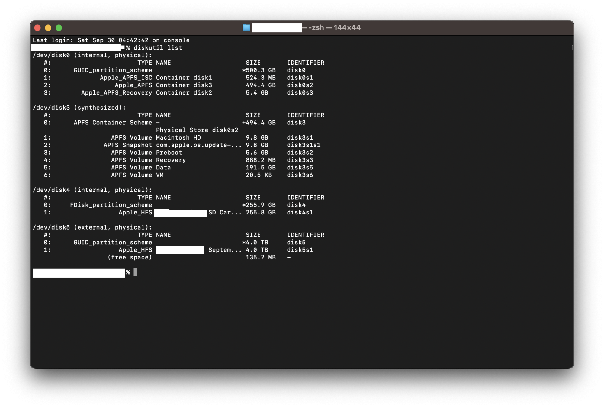

What does it say in the Terminal, running diskutil list?
I ran that (deleted my name from the picture where it's in the HDD names, etc):

This is weird, your SD Card seems to be listed as an internal, physical device with a FDisk_partition_scheme, it should be neither, the scheme is associated to Linux disk commands. Maybe this app SecuritySpy did that, but IDK. My advice is to save the SD Card's files and then reformat it.
