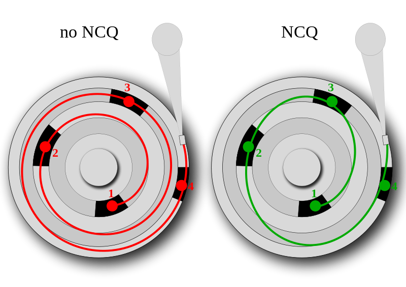

SATA 6GBit/s brought native command queuing, which is intended to speed up hard drives. It's not about the bandwidth limitations.
