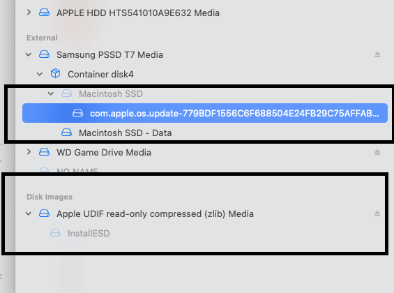

By the way, after a clean install is this a normal look

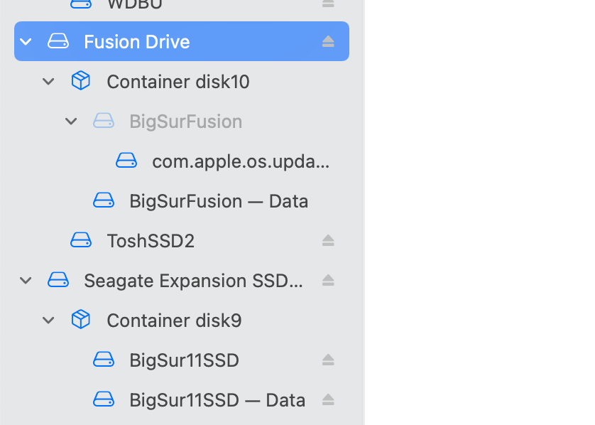

It certainly does appear to be normal. Top drive is a Fusion drive after update to 11.1. The Seagate below that is still on 11.0
If the installer disk image was mounted at the time you opened up Disk Utility, it shows up like that.
Sometimes it may even show up if it had been mounted when Disk Utility was running and later ejected.
