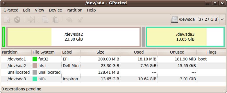

In the past, I have used the "hdparm" command via a Linux LiveCD according to the following guide to trigger a SSD Secure Erase on various Intel machines, including a MBP.
