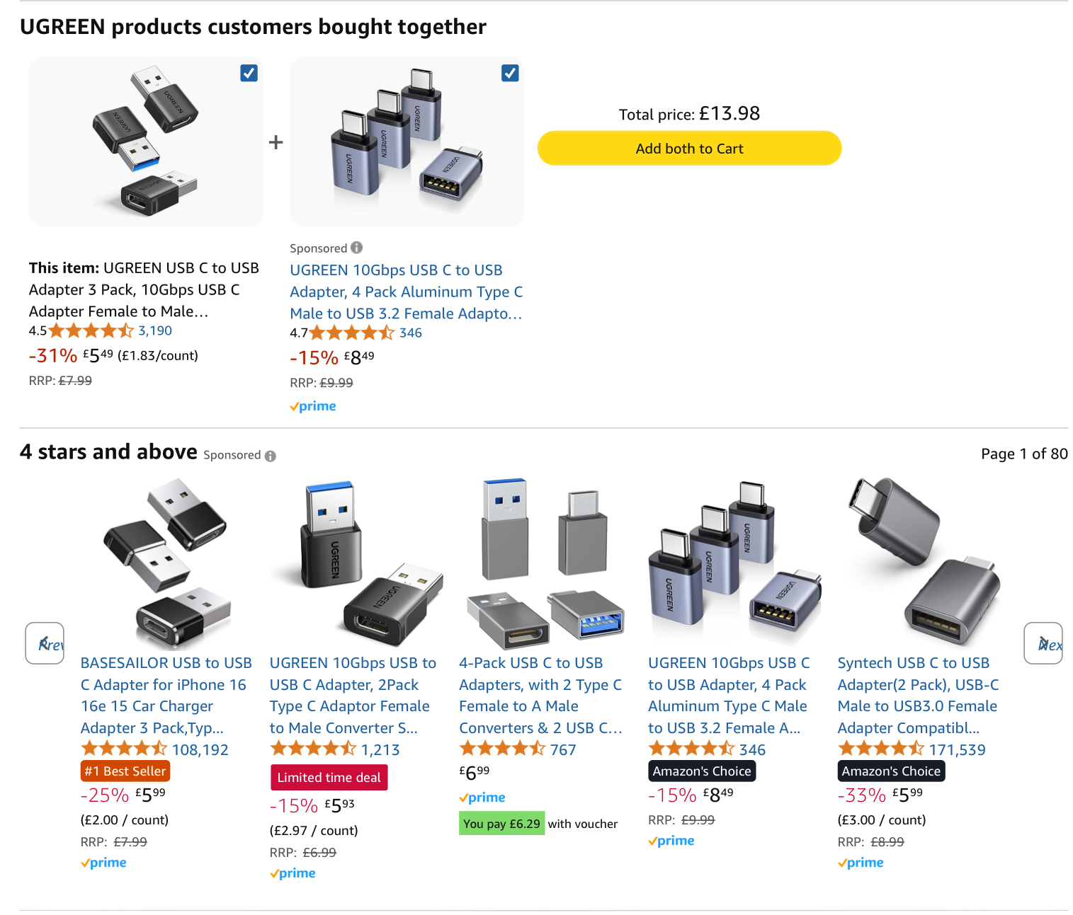

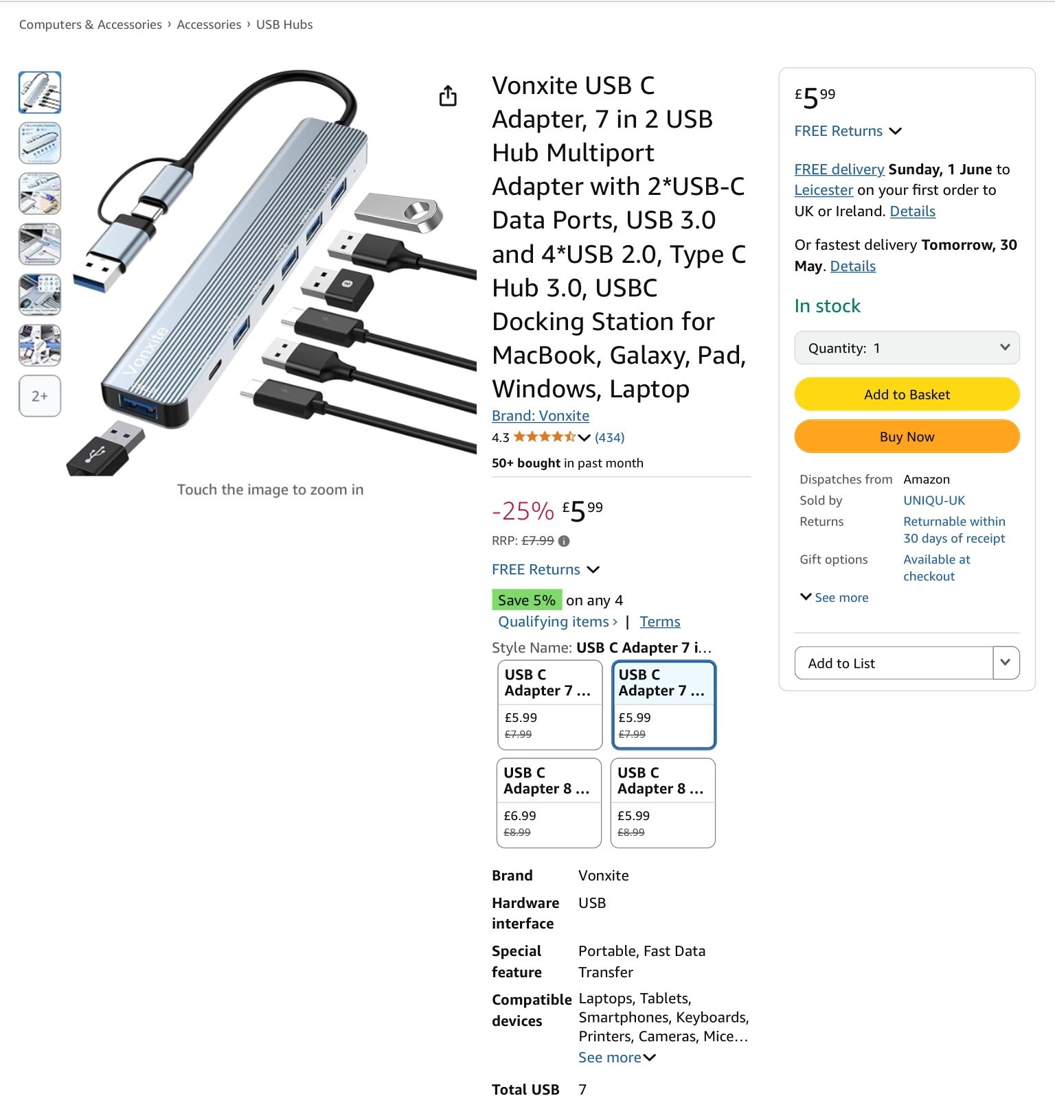

Certainly, I will report my results here, but I am more confused now than before. First, the USB-A to C adapter can cost anywhere from £10 to £5 for 6 adapter. I also found a USB-C hub similar to mine for £9, which includes the USB-A adapter.
USB 2.0 ports are limited to 500mA (2.5W) Output, while USB 3.0/3.1 ports can provide up to 900mA (4.5W). How can all of this work? USB-C can deliver up to 65W, which makes more sense.
My USB 2.0 socket in the MacBook Air can only “feed” the hub, and nothing will come out of the USB ports, not to mention the USB-C.
I have to think about what to do. It doesn’t look as good as I had hoped....
They are not expensive. You are wondering why one is £10 and another is < £1 pounds? I don't know. You did not post a link. You need one that supports USB 2.0 speed. Maybe more expensive ones also support USB 3.x speed?
That probably would be more convenient for those with USB-A ports.
I did explain that this would probably only work if the USB-C hub was self powered (i.e. if it has an external power connection). You didn't post which USB-C hub you are trying to use.
I'm not sure what "feed" means in this situation. Does the hub not appear in the USB tab of System Information.app? All the USB 2.0 functions should work if the USB-C hub is self powered.
To didn’t put links in my post because I thought that wasn’t permitted... here some pics which are self explanatory... my Hub is similar to the one in the pic (not powered with c-cable attached:
You can understand my confusion!?
