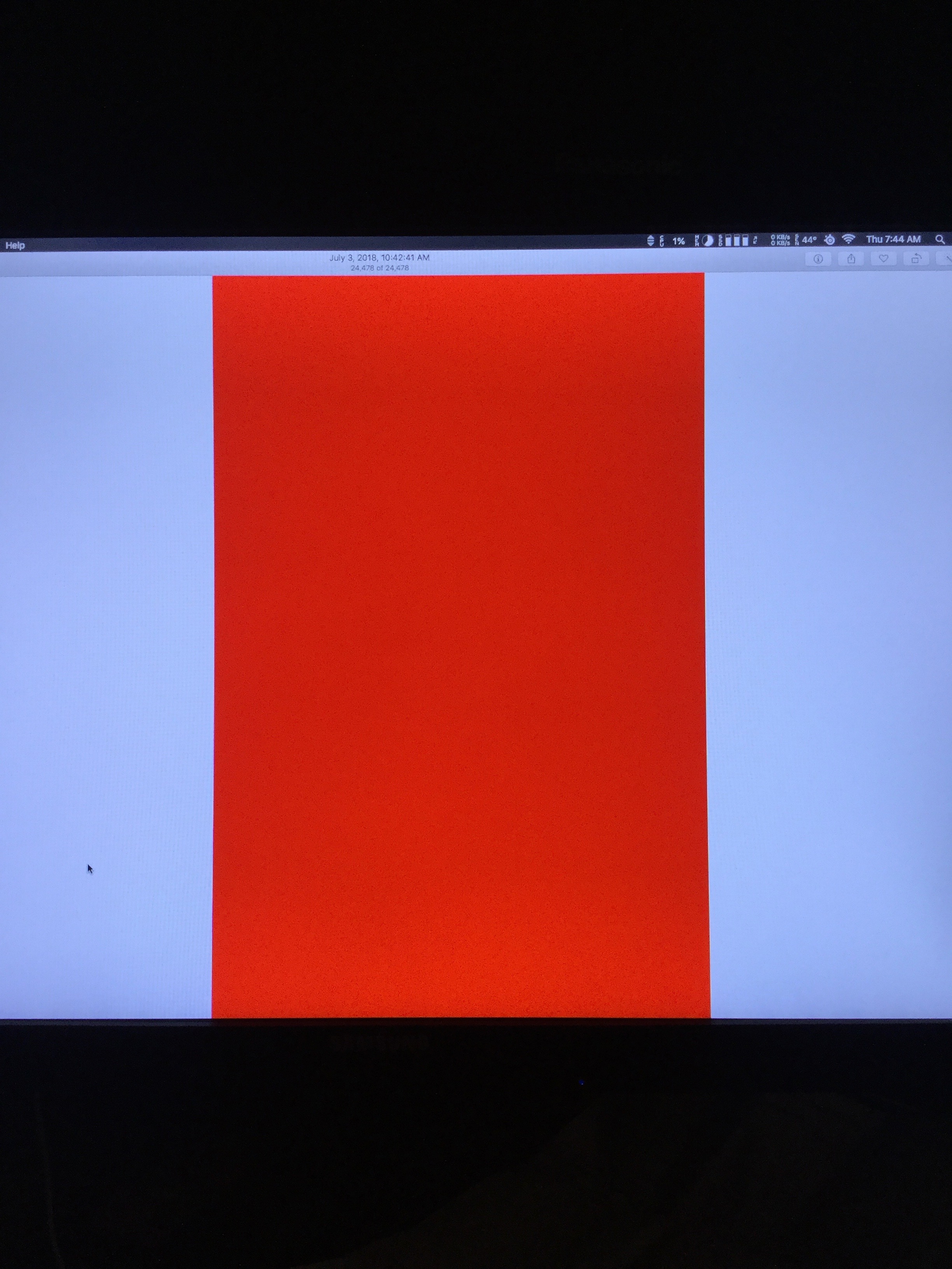

The Photos app on 10.13 works fine with my new RX560 except when I double-click on an image to see it full-screen. When I do that, it only shows a solid block of red pixels (see uploaded picture).
Any ideas?

There were a couple of other people with the problem and some suggested solutions. But if any of them worked, nobody bothered to come back and say so.
Reactions: MarkC426
Thanks for the tip about filtering.
But as you said, the two posts who mentioned it never came back with a solution. And none of their solutions worked for me.
Luckily, I found the solution. At least for me. I can't see how it could help the guy with the iMac. When I have both GPU cards in my Mac (GT120 and RX560), I get the problem. And I get the problem on both cards. But when I remove either of them, everything works.
Strange problem. Thankfully I only use the GT120 when I need boot screen, which isn't often. But it's clear that there's some kind of conflict between them.
If anyone here knows a bit more about how Photos work, I've discovered the precise moment when the red block appears. If I browse images in full screen quickly enough (using arrows), they all appear. But as soon as I stop browsing, the one on the screen goes red. (On the GT120, it turns into a pixel orgy) Clearly, it's the last "pass" that Photos does to optimize the image that is broken.
