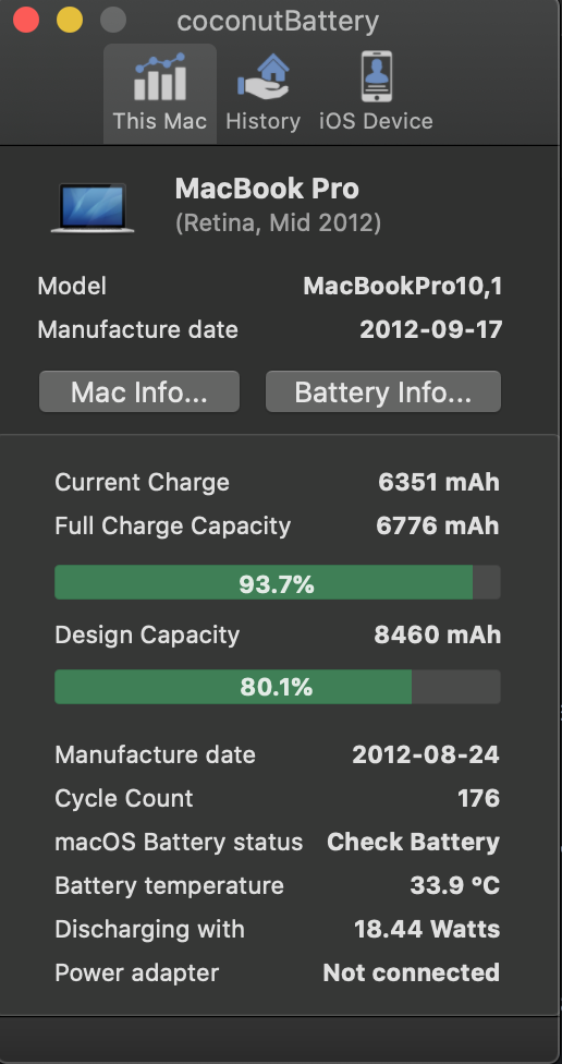

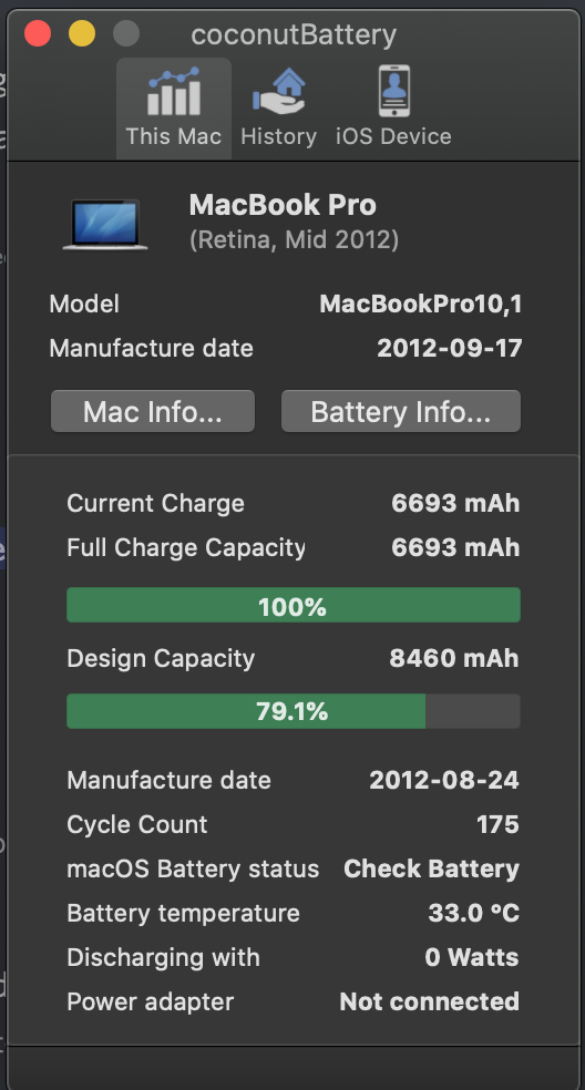

Here is what CoconutBattery says:
Is it simply a matter of Design Capacity being at less than 80% that's triggered this alert? I thought these batteries were good for 1000 Cycles?
Its probably failing yea?
Should I get a new one, They want $130 Canadian for a battery kit from iFixIt or OWC. The Laptop still goes for 3+ hours like I said, The unit is only worth $500.00 on the used market, these days...
Do you think Apple would still service this unit with a new battery - we have 2 Nearby Apple Stores in my city here in Canada.
The "Design Capacity" or MA H capacity rating seems to be slowly creeping up, in one direction now that Ive been cycling the battery... Is this just going to get worse or what?
Is there any chance I am okay or is this going to get worse and worse, Imagining there have been a few users out there who have had false notices. Although Apple would say the battery needs to be replaced, I feel it is very premature.

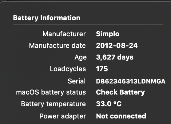

Here is the information from "Battery Info". I have another MacBook of the same model, which had its battery serviced in 2017, I'm curious to see the battery information on that, age and capacity wise. I will post back here with comparison.

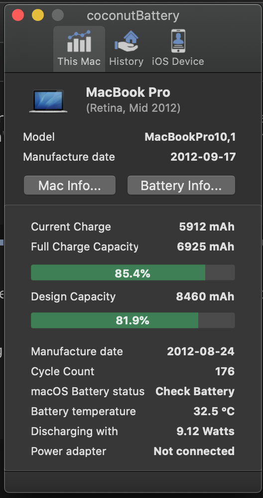

5 Minutes later after unplugging MagSafe since I posted this thread.... You can see the Full Charge Capacity has inched up slightly.

It keeps inclining, Inching up, while running on battery power. Would love to hear if anyone has seen this behaviour before, and the conclusion. Edit: It appears to be slightly reversing in capacity as well, its now 80.1% - The highest its been was 81.9% (Above).

The alert is simply based on 80% health. The battery now in the threshold borderline You may get alert on and off for a while until it stable below 80%. Just ignore it, it’s just indicating it’s time to replace your battery.
Also, there is no direct cause between battery health and cycle. I suspect the cycle is still low due to most of the time it was docked in charge station, which is not good for battery.

It's service battery message because you're below 80% at health at far fewer than 1000 cycles. Both conditions need to be satisfied for service warning to appear. This is likely because you've used it connected to power so you have calendar aging but not cycle aging. Seems fine to me otherwise, likely safe to ignore however note that because you've likely kept it connected to the charger you have a risk of battery swelling.
