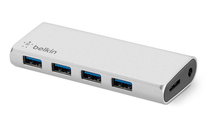

I need to use a few external HDDs I'm having around so I get this Belkin from Apple and it's working well. Got USB 3.0 speed which is much faster than 2.0 I got from my previous Air.
matrix07
macrumors G3
Jun 24, 2010
8,226
4,895
It says in the manual that it will charge but I plug 3 HDDs to it and it doesn't charge my Air, which is fine since I prefer the Air not fully charged all the time.
