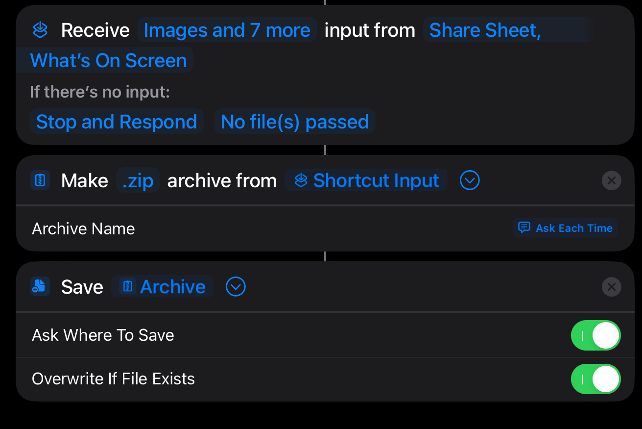

Have not done this, but pretty simple.

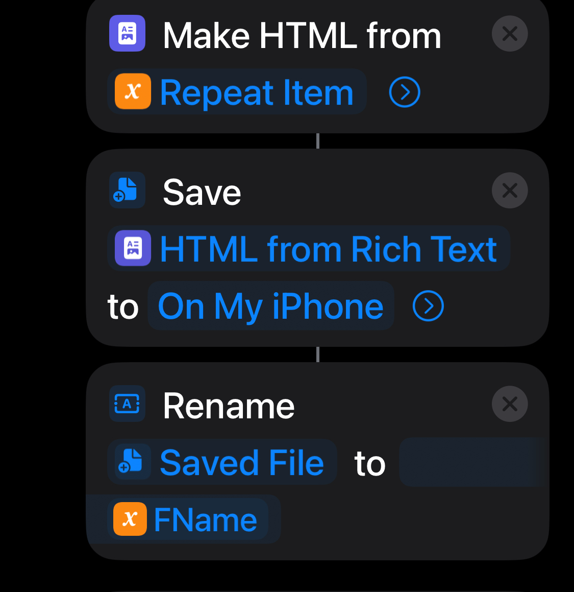

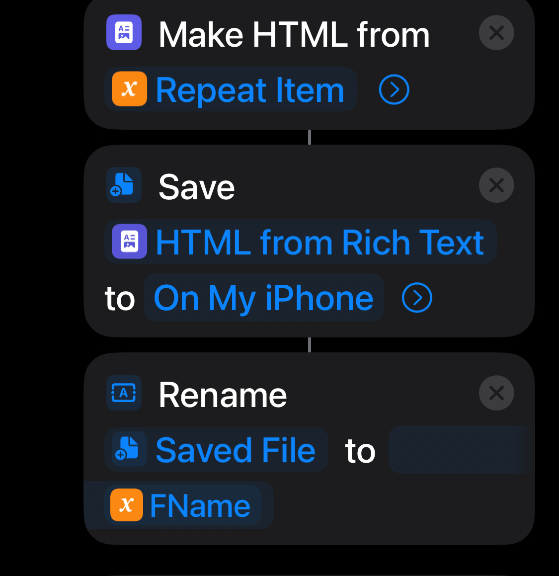

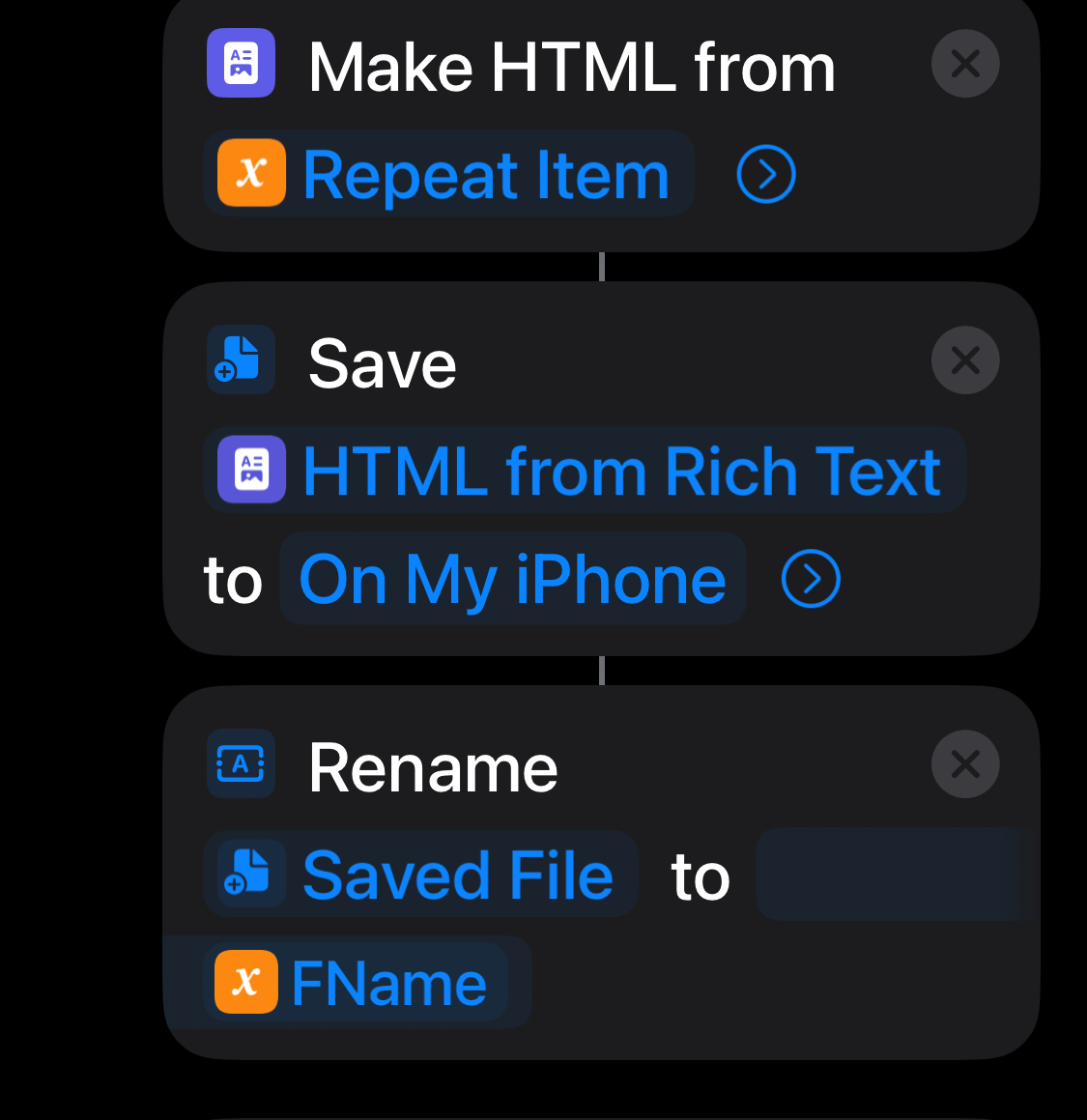

From my experience, Rename only works on an existing file, not a transient version of it. For example, a bit of code I have to create an HTML file from RTF text. Plus you did not provide any name there: can set it to "Ask Each Time" via right-click.
Never done the PDF optimization thing. Probably getting one big PDF due to multiple PDFs. Will need to do a "Repeat with each" on Shortcut Input to process each file passed.

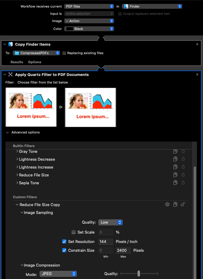

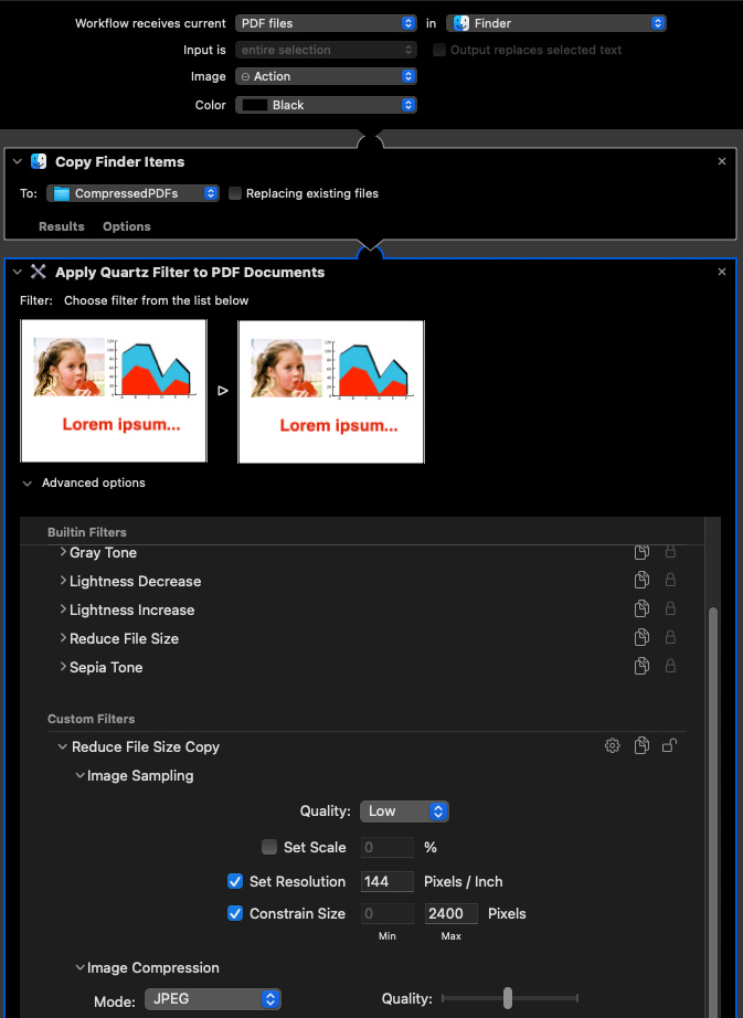

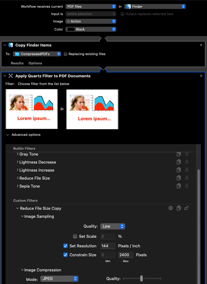

Shortcuts might be able to do what I know you can do with Automator…run "Apple Quartz Filter to PDF Documents" choosing "Reduce File Size" as the filter.
If you original is already reduced by this or any similar process then you're not going to get much out of it.

@NoBoMac appreciated!
@BrianBaughn and @bogdanw appreciated. Exactly what I was looking for. I also found more information on this here . I will add that also had to play with the Image Sampling setting to get sufficient compression. Problem solved, thank you!
