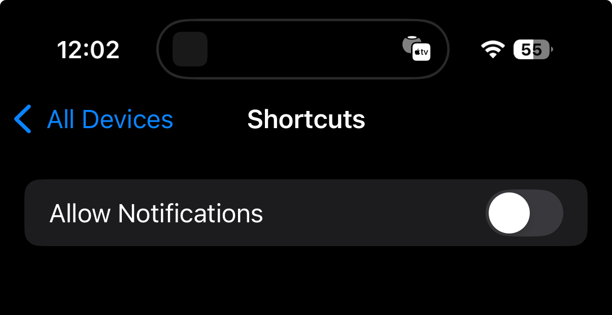

Settings > Screen Time > See All App & Website Activity > scroll all the way down to Notifications > find Shortcuts (you may need to go back a week and then forward again to make “Shortcuts” tappable > turn off Allow Notifications

thank you not quite sure why they make this so hard. But your instructions were spot on.

One item of note… at least on 18.1, this setting has been turning itself back on after restating the phone. It may be best to periodically check and make sure it’s off after each restart. Frustrating.

Yes I noticed it turned itself back on but in my case shortcuts submenu doeesn't even have menu where I can turn on/off. I'll investigate in the coming days and report back. But thanks again, at least I'm not completely crazy,

Did some Google-fu and looks like option returns to default/on anytime you restart your device. Couple of sites state this and an older thread on MR.
