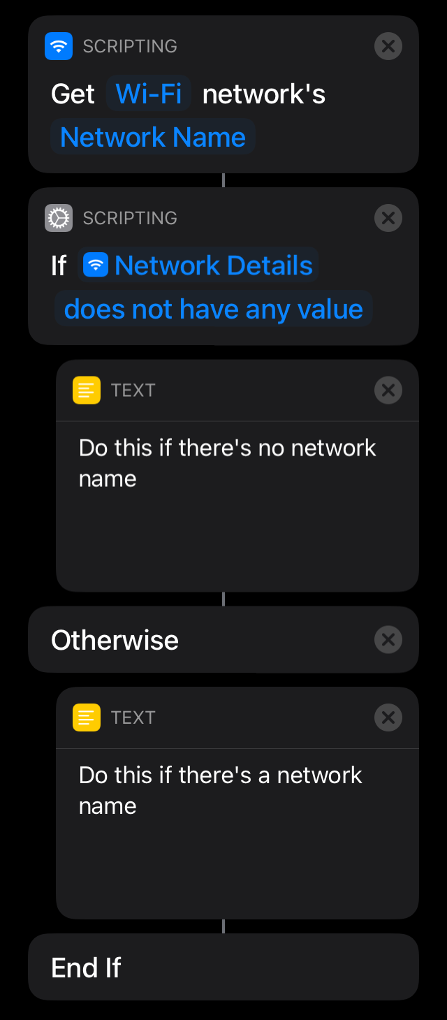

Personal automations are supposed to be things that happen based on common user actions. Like when I connect to my Bluetooth speaker, open TuneIn Radio, or like when I connect to this specific wifi network, do this and that.
You're right on using an If statement though. Looks something like this:

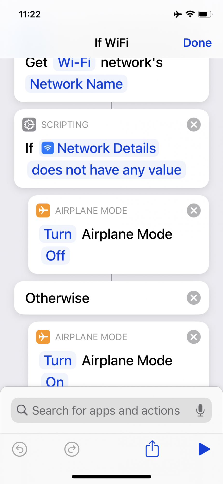

hi thanks for the example. yes thats the 'IF' statement ive been trying. while it works its not 'self-enabling' ie automated. My goal is to have this shortcut automated, if I have to manually activate I might as well use the control center's Airplane Mode toggle button.
Im abit baffled that I can automate 'when wifi joins' action, but theres no reverse of this? (when wifi un-joins)
there must be a way to add this IF shortcut into an automation.
I just tried creating an 'IF wifi' Shortcut then adding it to an automation but its only triggered by 'connecting to a network'
I need a way to automatically (with a passive trigger) turn Airplane mode off 'if there is NO network'.

I think i found a solution. still not perfect but maybe someone here could assist with it.
so as the OP says, the issue is with the trigger which needs to be one that happens and require no user intervention.
the shortcut for when wifi connects, is not enabling to toggle off the "ask before running" but i found that other shortcut does enable this option. the automation for the airplane mode. you can set the trigger to be "airplane mode on" / off and uncheck "ask before running". afterwards i put all the script inside a "repeat" loop and ask the network details, if "contains any value" (wifi) then put airplane mode on, else if the network name "does not contain any value" turn airplane mode off. between each one i've set a "wait" timer to do that every one minute and set the repeat number of times to be 3600.
it kinda works. i mean the phone automatically turn on airplane mode (and leaves wifi on) and when there is no wifi it is turning off the airplane mode. but its only works for testing, ie in short amount of time, like 10-15 minutes.
i re enabled the background app activity and asked the shortcut to notify when running. so now the app notify me every few minutes that the shortcut failed to run because it took too long and then the shortcut is restarts and repeat.
it seems to work but my guess is that shortcut never intended to run that long time thus the app terminate it and for some reason it restarts it even when there is no trigger to do so automatically.
