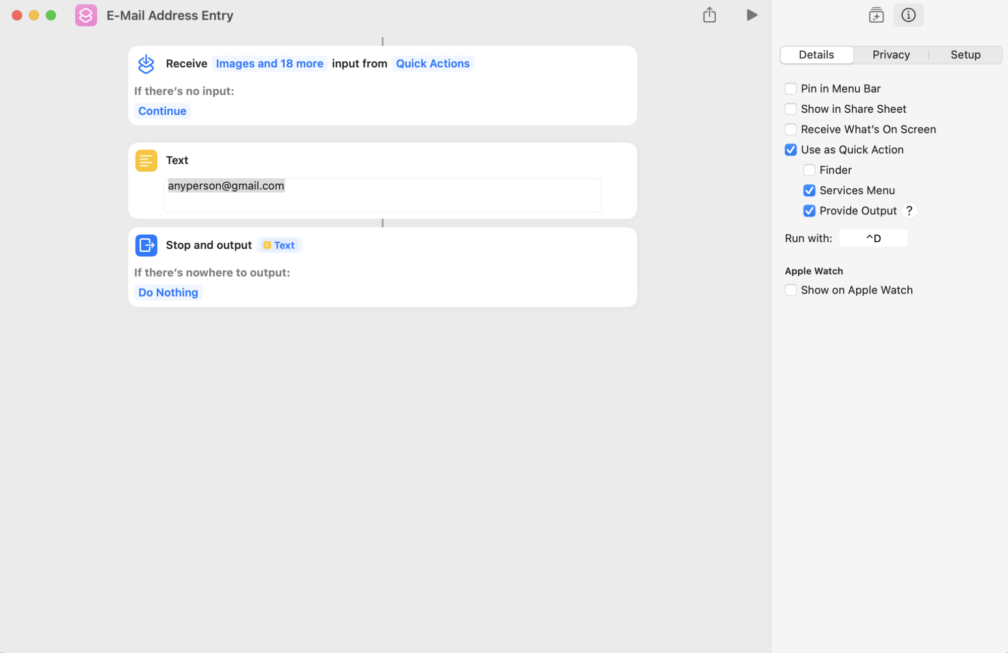

I have setup a Shortcut that enters an e-mail address.
I have setup the Shortcut to work as a Quick Action.
The problem I am having is that the Shortcut does execute / fire when the Shortcuts application is closed as it should.
Would appreciate assistance in getting this to work as it is maddening (at least to me)!

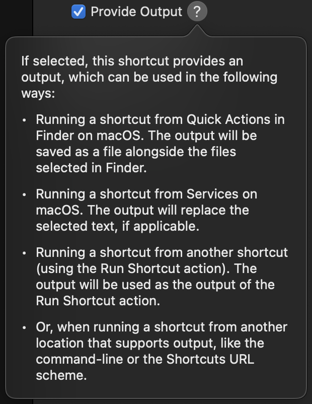

The tip below is what you can do with the output.
@BigBlur
If the Shortcuts app is open then the keystrokes ^D enters the e-mail address where the cursor is positioned.
If the Shortcut app is not then the keystrokes ^D do not the e-mail address where the cursor is positioned. The problem is that the shortcut is not "outputting" / typing the e-mail address which base don my understand it should do.

Gotcha, I re-created this and it seems to be working whether the Shortcuts app is open or closed...but not everywhere.
For example, it worked if my cursor was in Safari's address bar or in Notes, but not in a textbox on a site and some other apps. It did work if I went to App Name > Services in the menu bar and run it from there though. I also got it to work in textboxes on sites by changing the shortcut to be Control-Shift-D (instead of Control-D). It still didn't work in some other apps though. I'm guessing there's keyboard shortcut conflicts going on with those.
Not sure if that's what you're experiencing or not. Did you happen to test it in one app when Shortcuts is open, but another app after you closed it? Did you see if it works in other places, such as Notes; or from the Service menu?
Depending on how/what you're using this for, Keyboard Text Replacements might be another option to look into. You could make it so that typing something like 'eee' puts in your email address. Then you wouldn't have to worry about keyboard shortcut conflicts with various apps.
