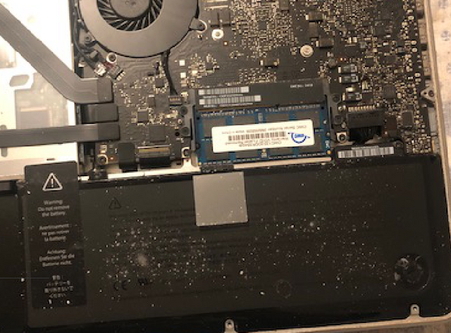

I need a new battery for 2011 MBP, as it won't turn on, despite saying fully charged, but only boots with power plugged in.
Curious as to why it's as sluggish as it is and not comparable to the SSD speed before battery died, even when running on power plugged in. Does the battery affect it running on power also?
Also have a replacement battery that I didn't get round to fitting yet, but read about expanding batteries, and this just has a very small part that can pop in and out if I press on it, where the circular mark is on them, if you are familiar with that battery part. Will it be OK, It's not bulging. Thanks for any help

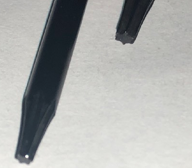

You are of course 100% correct. And about replacing it. Good advice, and pretty close to it, but I've just opened it up and it doesn't look great, to be honest. What's really annoying more than anything, is this little bag of uselessness doesn't have the tri-wing driver and I can't remove this knackered old battery to see if or even how much longer it's got. I assumed with the spudger it would have the tri, but it has the flat top, phillips to get back off, and these two heads that don't go anywhere near the tri wing fitting?
The £1000 ish lack ports don't they. And I'm not sure if I can get away with the 'Air'. I've just ordered the tri wing on Amazon and I'll see what occurs tomorrow. But as it stands, it's pretty unusable on power. But let's be honest, it owes me nothing. I've never had a laptop this long.

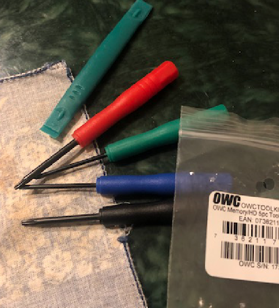

Yes, your procedure sounds like a lot more of a pain than this one, aside from them providing every screwdriver but the one to remove the battery. Boy, was I thrilled this afternoon. I looked at the ifixit video, the least detailed one of the lot, but should be pretty straight forward. The calibration looks like a pain, and a whole day's worth of messing about, but I see plenty don't bother with it. Same as setting the PRAM/SMC, but that's not mentioned as much as calibrating.
