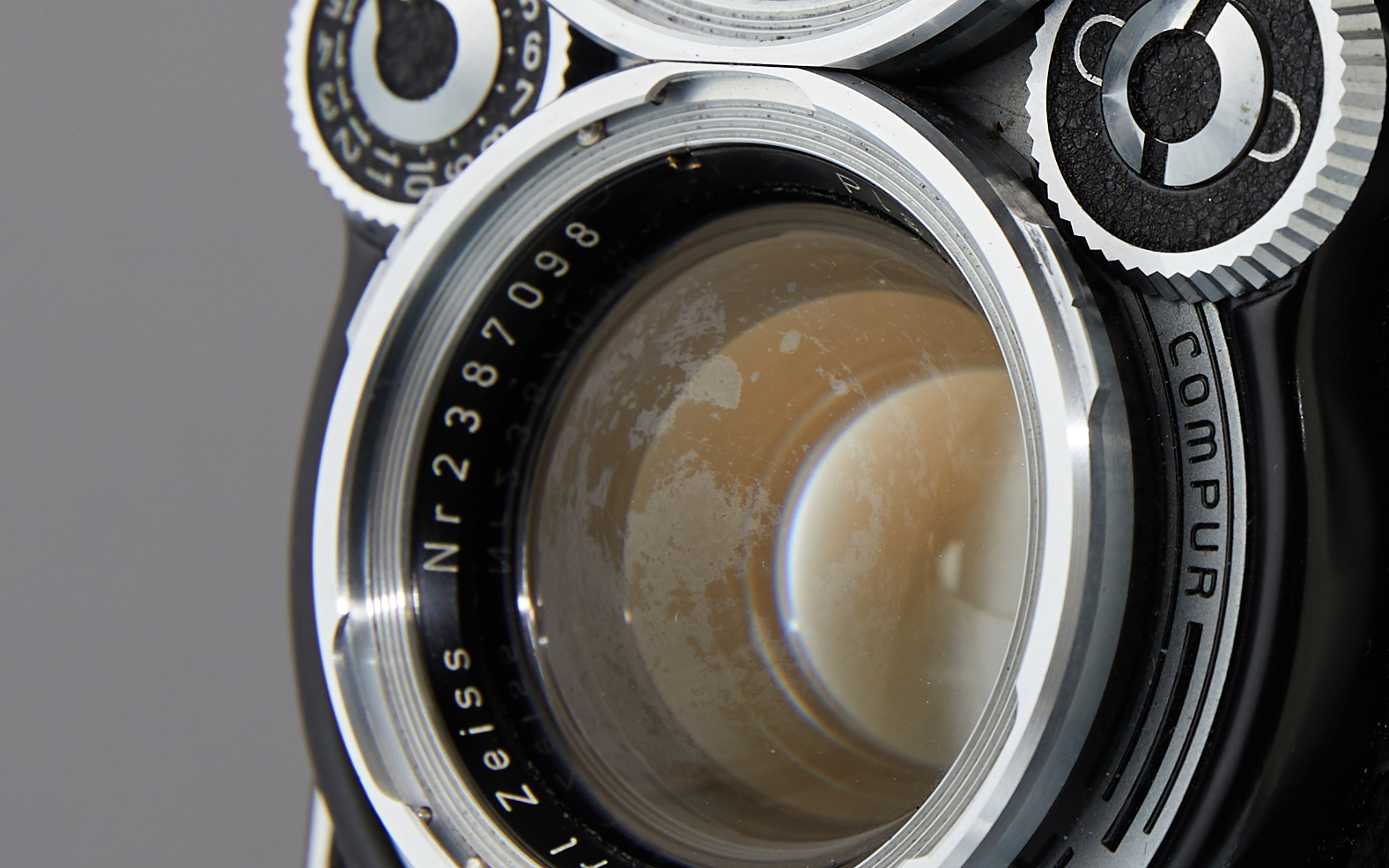

This. In a pinch, alcohol is safe to use on a lens that not weather sealed. It does, however, have the potential to ruin the lens coating. So I would go out and take some pictures to test contrast and flare resistance.

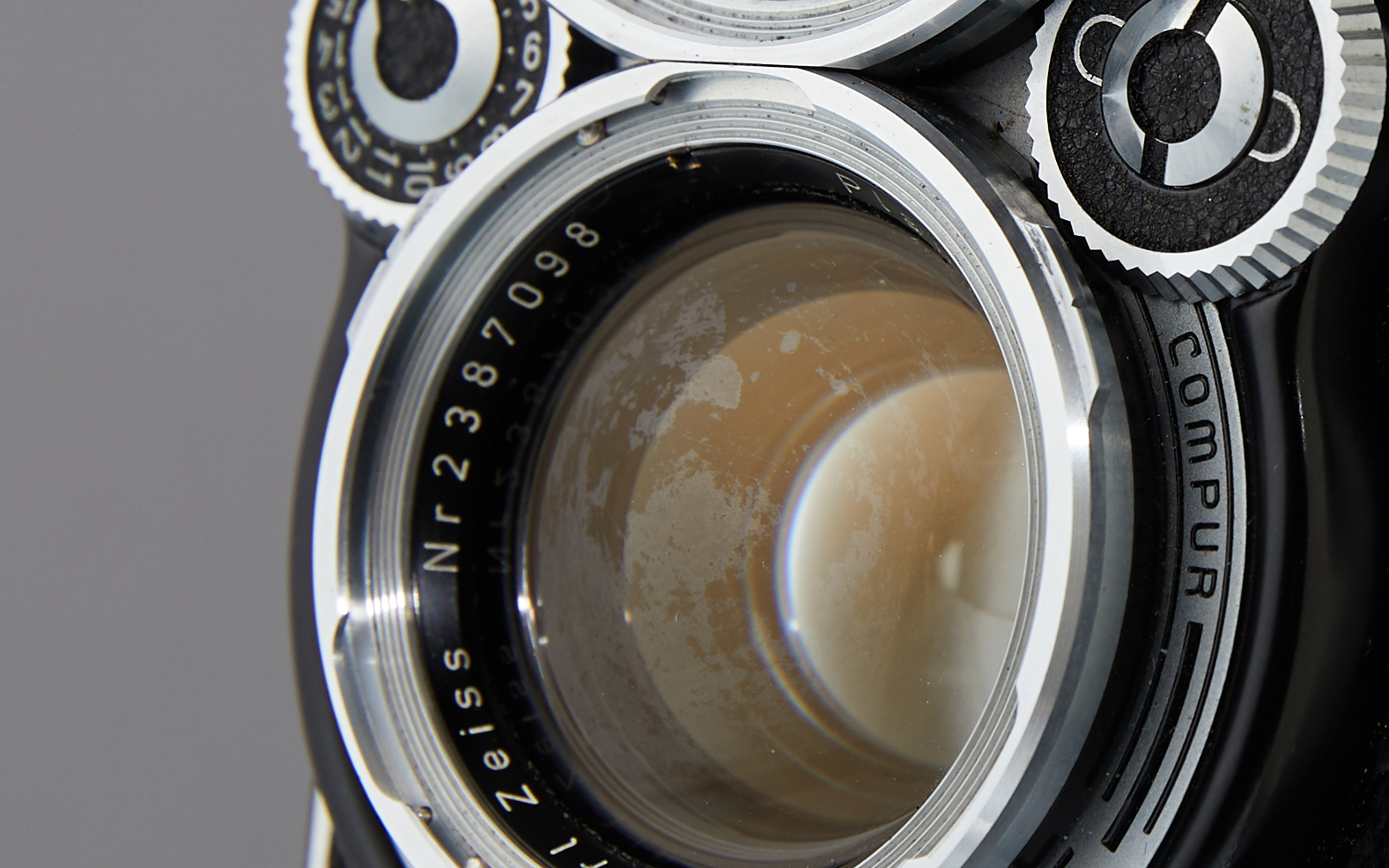

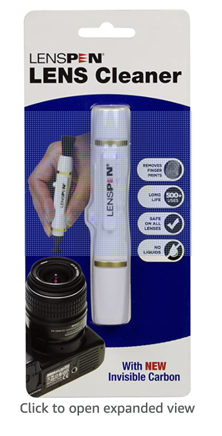

Next time might I advise putting the lens cap on when not in use. When it comes to cleaning neither of these are going to break the bank. They are always in my camera bag.
Lens manufacturers usually have instructions for solution-cleaning of their lenses. The OP can check with Sigma.
The OP created a big problem by not following these simple guidelines, and using Scotch tape to remove the dust:

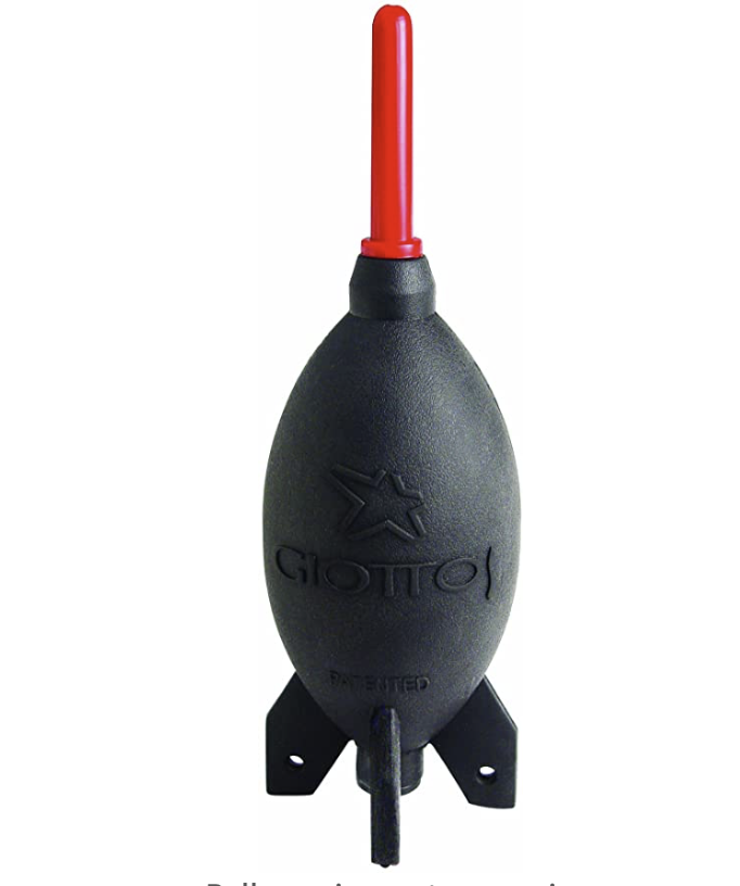

a. Remove dust from the glass using a lens brush, or a bulb dust blower as shown by another poster above. If the glass looks clean and free of smudges, etc., stop here (don't proceed to step "b.").

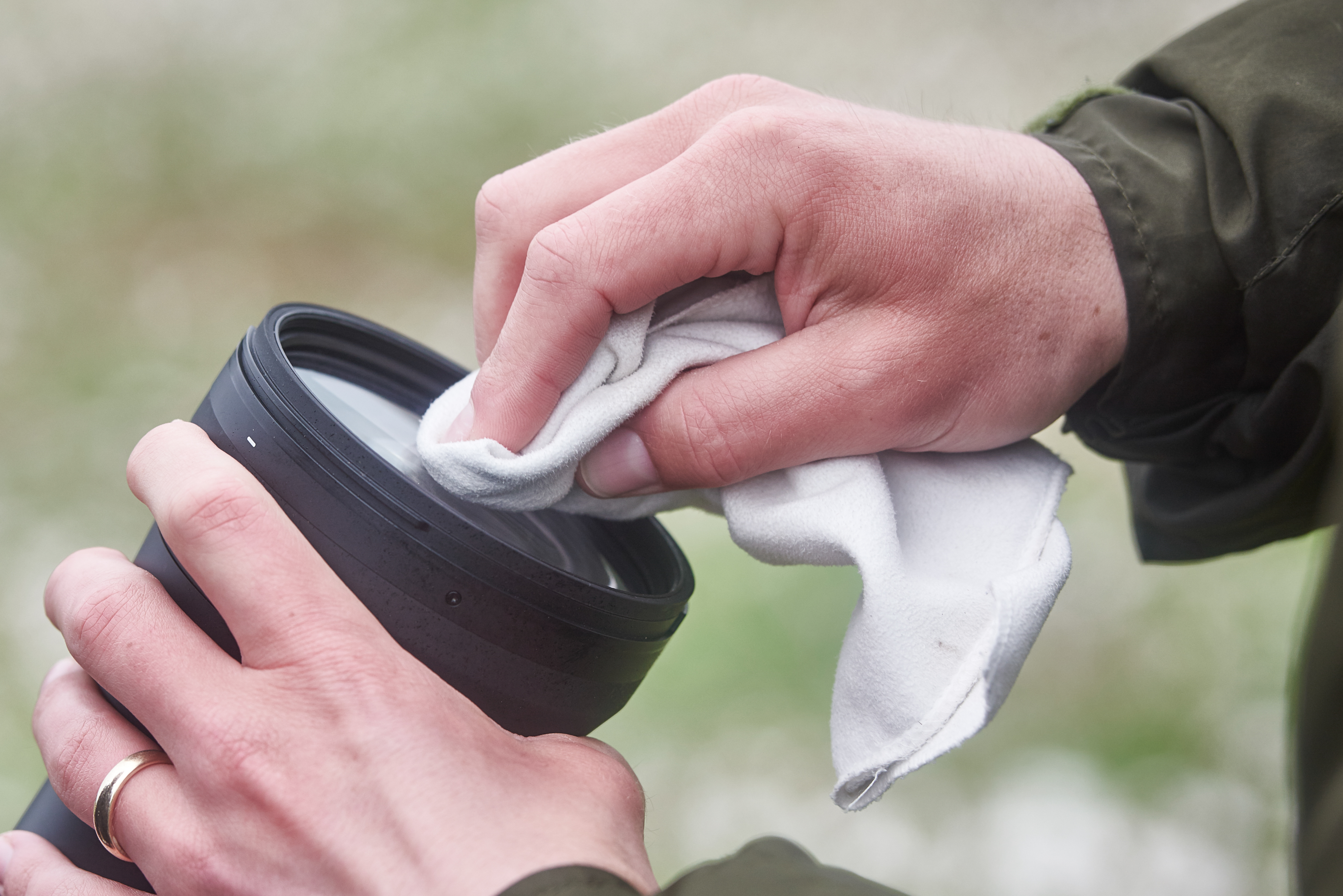

b. Once the glass is free of dust, and only if smudges, fingerprints and things like that are present on the glass, proceed with wet-cleaning with the proper solution or one recommended by the lens maker, plus a dust-free lens cloth: place a drop or two of the solution on a small section of the lens cloth, and gently wipe the glass with the moistened area of the lens cloth...in a circular motion. Then wipe the glass in a circular motion using a dry section of the lens cloth-to remove any traces of lens cleaning solution.

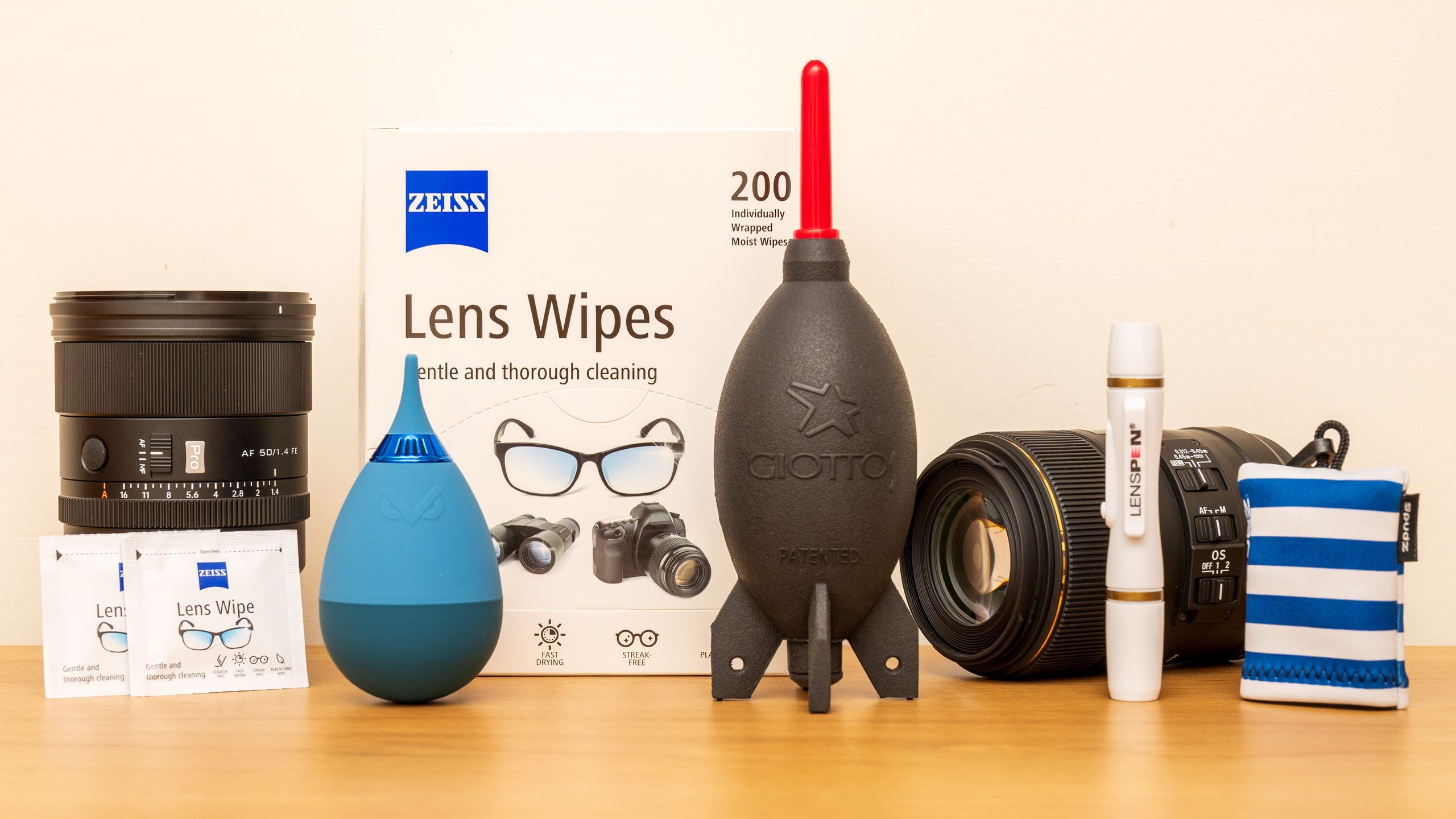

These are some non-lens specific cleaners:

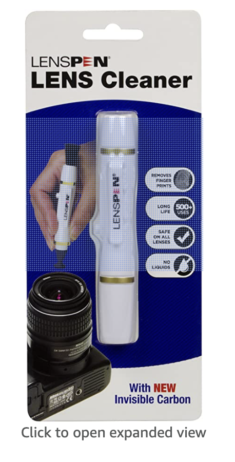

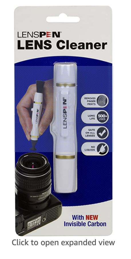

The lens pen and rocket blower are very good investments. I use my rocket blower all the time. Extremely useful.
