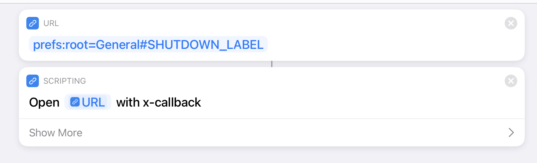

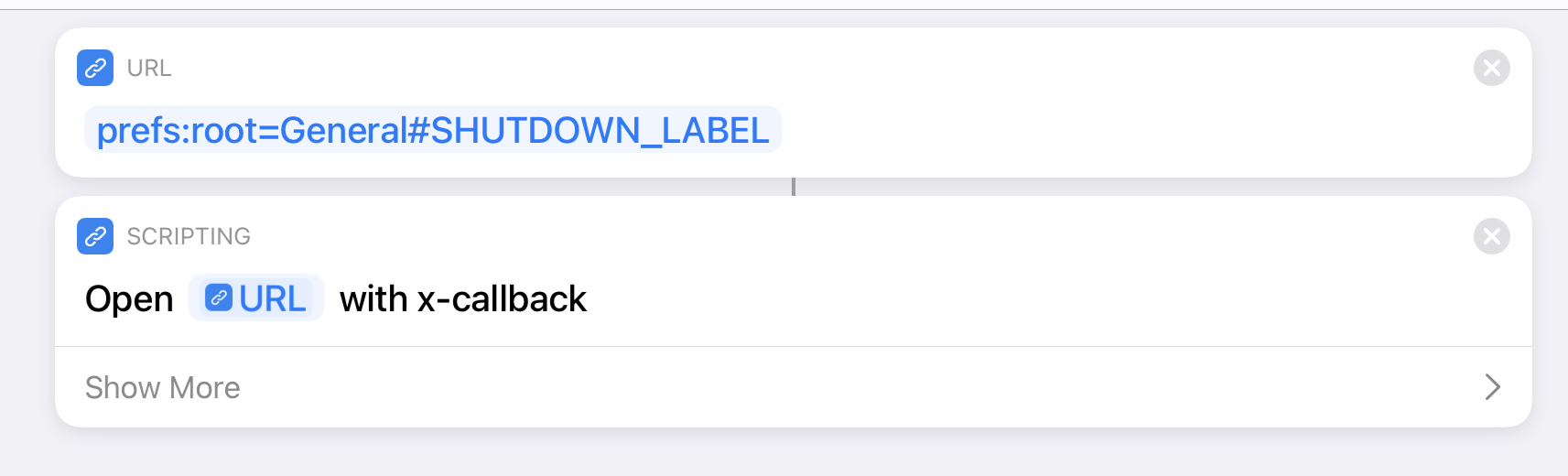

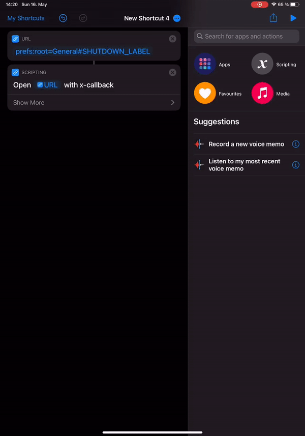

Take a look at the pictures. It's a very simple shortcut... it should look like this:
Anyway, i tried it for you. It jumps to the button, it doesn't activate it. So it basically saves you a little bit of scrolling down the general page but it won't turn the iPad off for you.

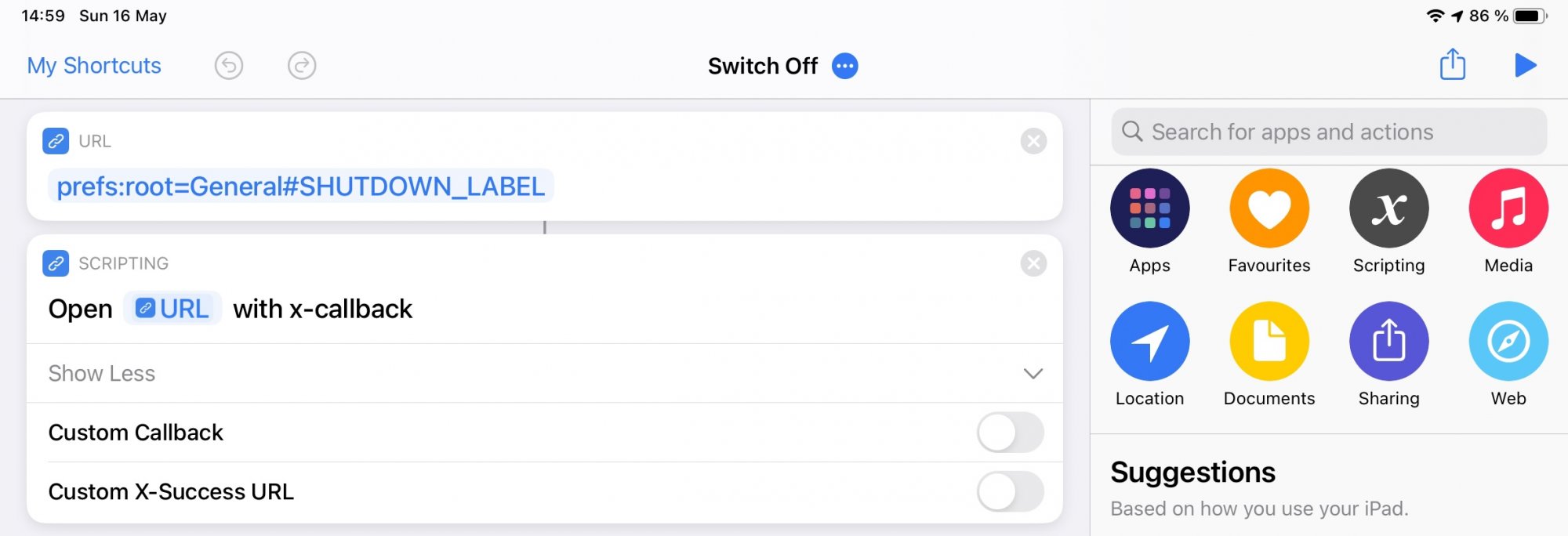

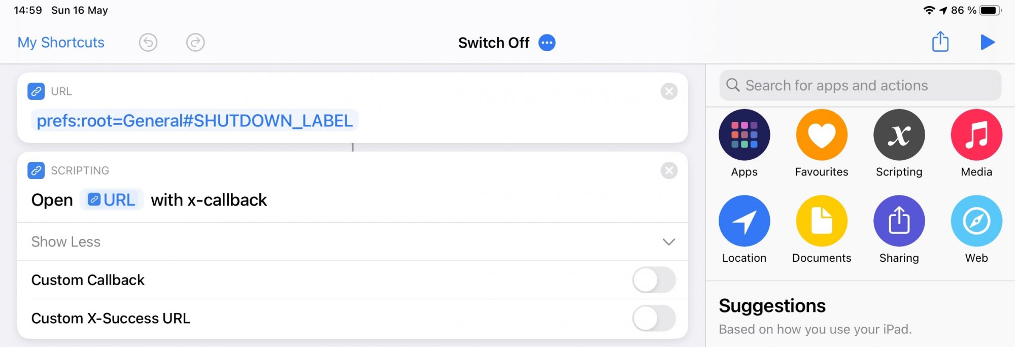

I
after saving this you can even call it from Siri. You still have to tap once and slide so…
Reactions: nicho
Well, then you did something wrong. 😎

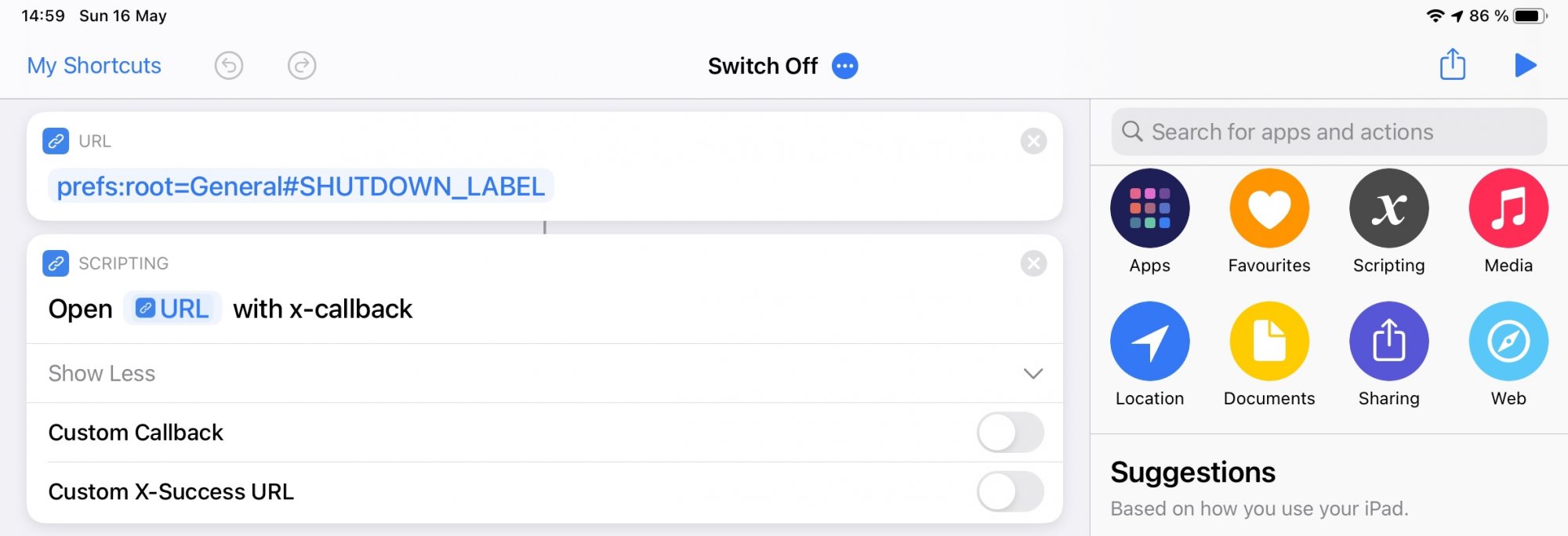

View attachment 1775443I

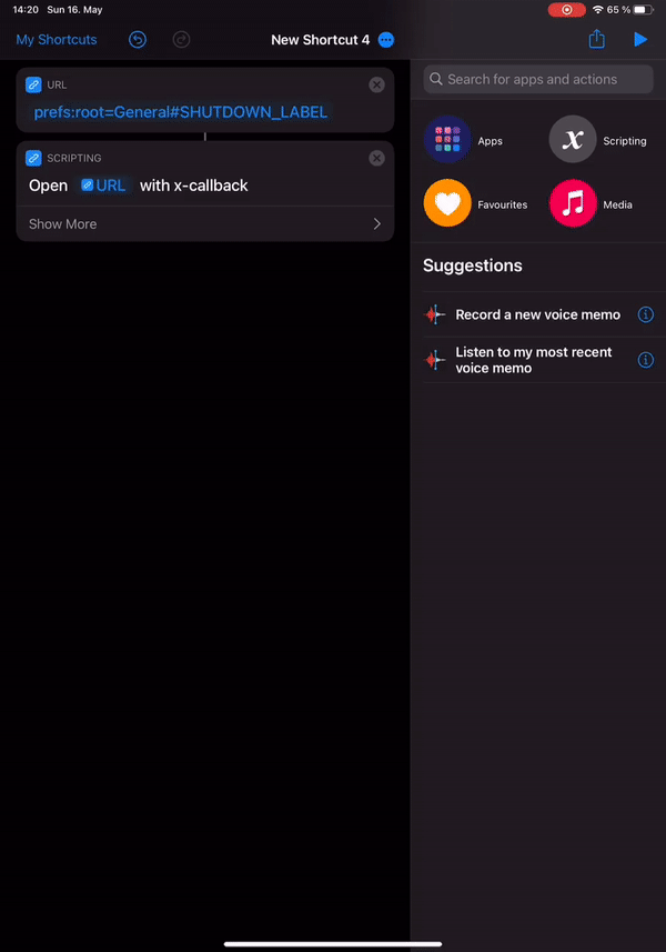

This is very strange. I have created exactly the same shortcut as yours, but when I run it, it just opens the Settings (main screen) and does not advance any further.

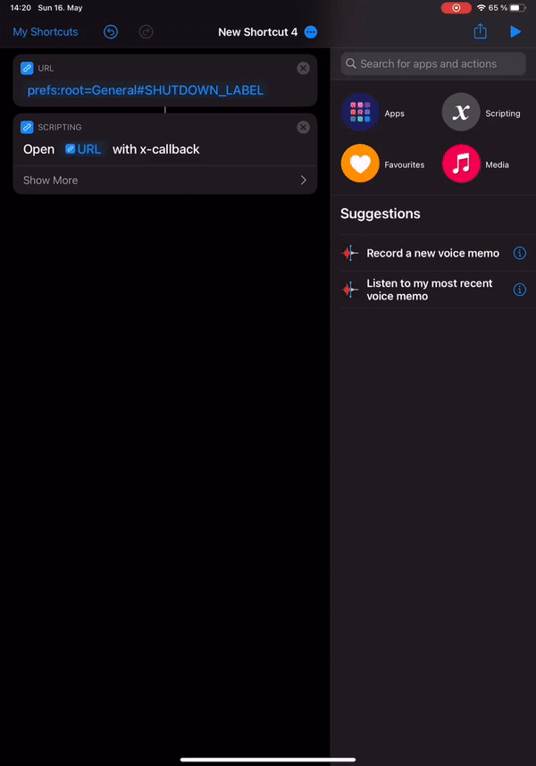

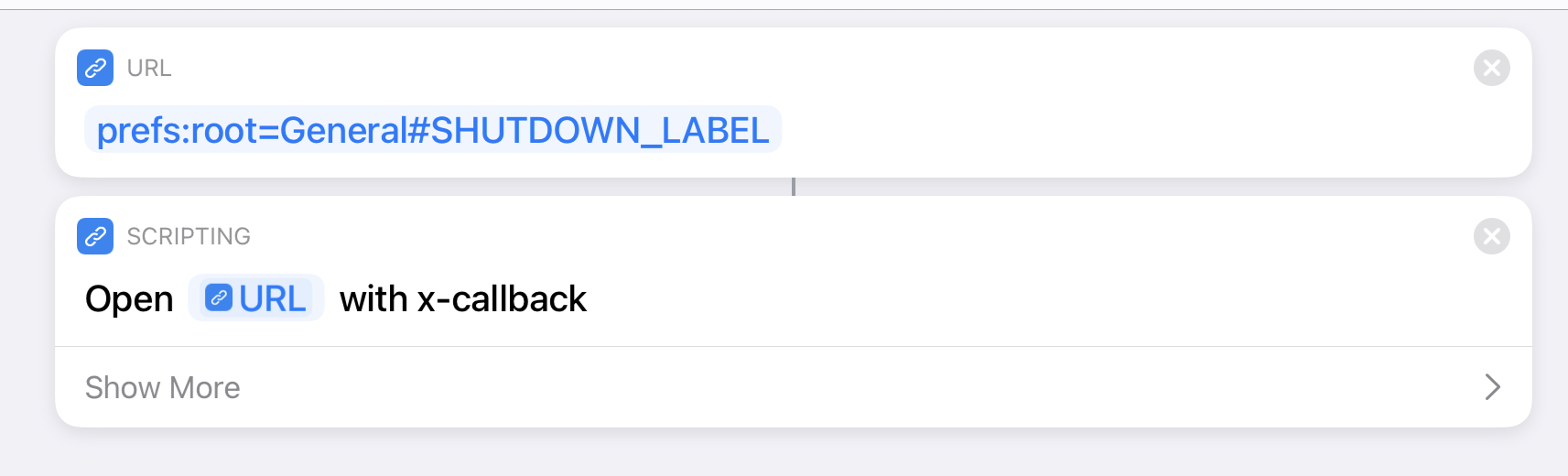

This is how it looks:
Looks fine. Go to preferences. Select General. Quit preferences (really quit). Execute short cut from within Short Cuts.
