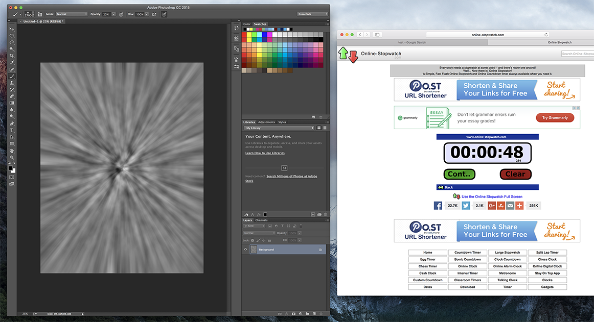

Here are my ( non scientific ) results in seconds for the Radial Blur:
48 seconds for a radial blur on a document that is only 96.3M doesn't seem that great. Is it the i5? the 395? or should i upgrade the RAM? ( Have standard 8GB installed at the moment. )

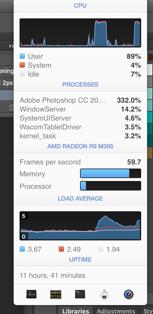

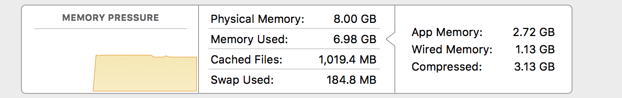

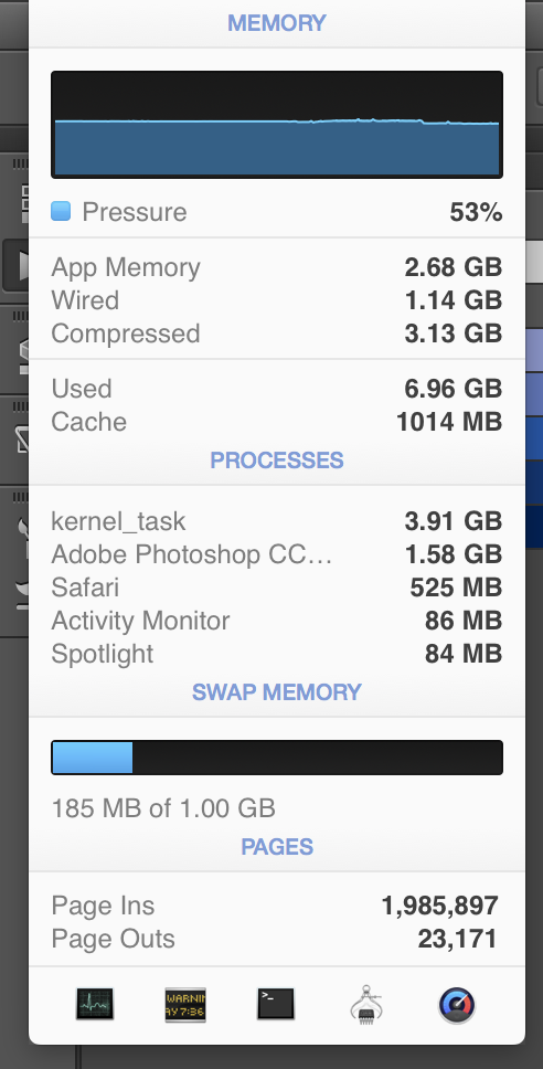

Also, i downloaded the istat menu you mentioned, during the radial blur test memory doesn't seem to be that stressed by photoshop, although on activity monitor memory pressure turns yellow; not sure if that means a bottleneck or not?
I've attached a few screens of whats happening with CPU and GPU when i run the radial blur test:

Anyway, all your 8G RAM was fully utilised, which is good, but also means the system can't use more RAM to further accelerate. More RAM means more cache in current OSX and photoshop. Which may help a lot in some case.
If you look at the numbers, the overall RAM used is more than 8G (because some RAM was compressed, so the system consider you have more than 8G RAM). And the Swap is not zero, which means the system start to use SSD rather than RAM to store temporary data. Luckily the SSD nowadays is very fast and low latency for random access files. The swap also just 185MB, most likely it's just used to store some other idle data, but not really using the SSD to replace RAM for photoshop calculation.
Yellow also mean the system push all the RAM close to the limit (with little performance degradation).
According what Apple says, as long as it's not red, your system is fine. Of course, RAM pressure stay at green is better in terms of performance. Because yellow means there is no more spare RAM to act as cache to further accelerate.
And for i5, total CPU availability should be 400%, photoshop can use up to 332%, which is also very good. But once again, it means you already push your system to its limit. An extra 10% demand will saturate your system.
For GPU, OSX is very good on fully utilising VRAM (on the red's GPU, or it's a bug there VRAM won't be released until requested by another software), so the utilisation almost always high. It's very hard to determine if photoshop push all your VRAM to limit. Or most of the VRAM was actually used by the system and doing nothing at that moment. I personally believe VRAM is not a problem in your system even it looks like the utilisation is above 80% (it's definitely not at the 100% saturated state). And the GPU almost doing nothing. By considering current photoshop is more CPU bounded than GPU bounded. I wouldn't worry the GPU itself is the bottleneck.
If this blur test is more demanding than your normal workflow. Then congratulation, you get a prefect machine to fit your needs, not much wasting / idling resources, and only minor performance hit under full load.
However, if this is just a quick test, and your normal workflow may be more demanding, then sure you can benifit from the RAM and CPU upgrade.
