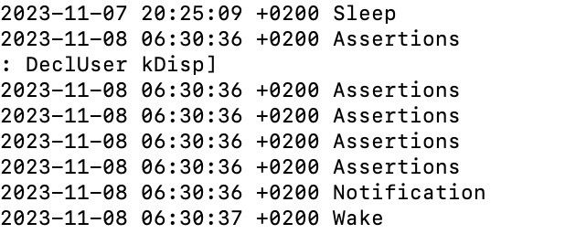

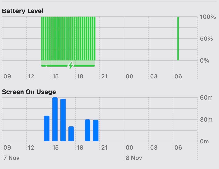

I'm having this issue on my 2019 Intel i9 MBP. When I'm not using the MBP I like putting it to sleep and disconnecting it from power. Every morning now for the past week I plug in th MBP to find the battery has drained down to zero. LAst night I put it to sleep, kept it connected to power, and yet the battery had drained down to 19%. What is going? Running Sonoma 14.1.1.
Look at the output of "pmset -g log"! It is probably the best way to find out what is going on.
Can you look out for "CSPNEvaluation" events?
Good luck!
I will if you can help me navigate to that :)
