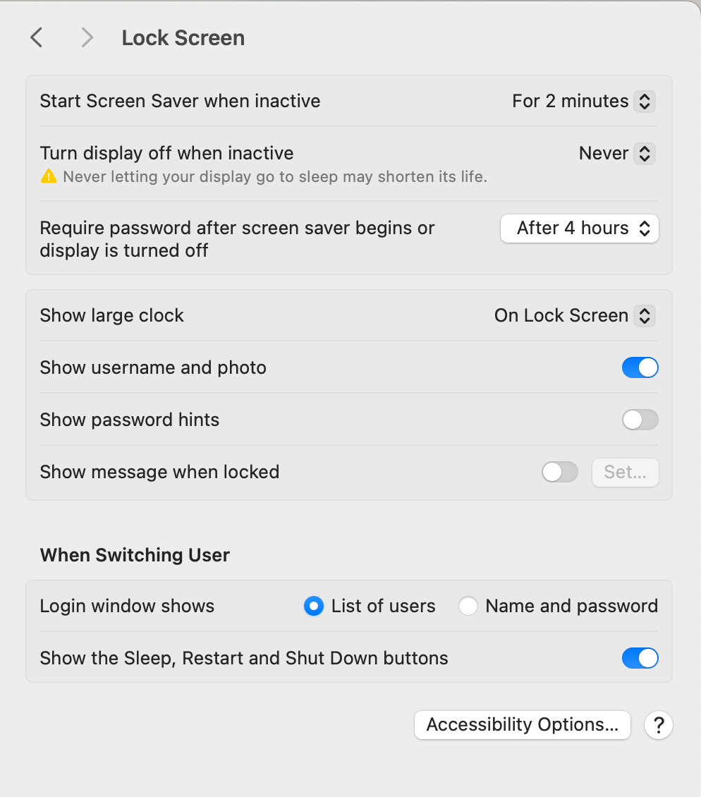

I'm having a weird issue in Sonoma when [Energy Saver> Prevent automatic sleeping when display is off] is enabled. As soon as the display is set to sleep [Lock Screen> turn off display when inactive 5 minutes] the monitor cycles on and off like it's still receiving a signal every time it puts itself to sleep (LG display attached via displayport input via thunderbolt/USB).
I can disable the Prevent automatic sleeping, under energy saver to stop this, but this means puts the system to sleep which I don't want, as it interrupts other background processes and sleeps attached external drives.
Other than switching off the monitor power I don't know what to do. I really want the system not to sleep at all. Sounds like bug to me any ideas?
After some playing I found my issue is linked to the display sleep (under Lock Screen). Even with the Prevent automatic sleeping option enabled in Energy Saver, the system will still sleep but only momentarily as soon as the display sleeps, causing any attached USB devices to power down including any drives, and human interfaces, then these flick back up. So the cycling of the monitor goes on and off 2 times in the process.
This could be potentially damaging to any external SSD drives and interrupt any system processes going on.
Solution:
I've now set the display sleep to never, and just allow the screensaver to kick in after a couple of minutes. I've also left the Prevent automatically sleeping on. I'm now turning off the monitor manually, and this seems to be fine the system does not go to sleep when the display is physically powered off - at least in the short time I tested.
