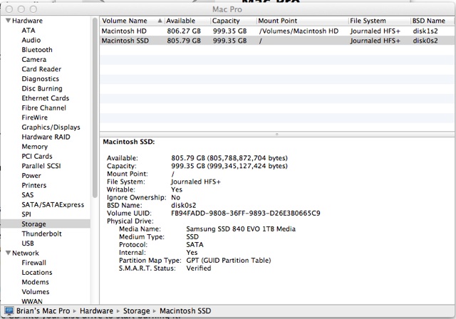

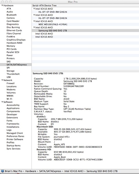

Yes, the SSD is new - about 3 weeks old with minimal use. Here are three system info images, from a previous thread that dwindled from forum apathy, that you may find useful. The firmware revision is EXT0BB6Q.
https://forums.macrumors.com/attachment.php?attachmentid=505020&d=1413464676
https://forums.macrumors.com/attachment.php?attachmentid=505169&d=1413492075
