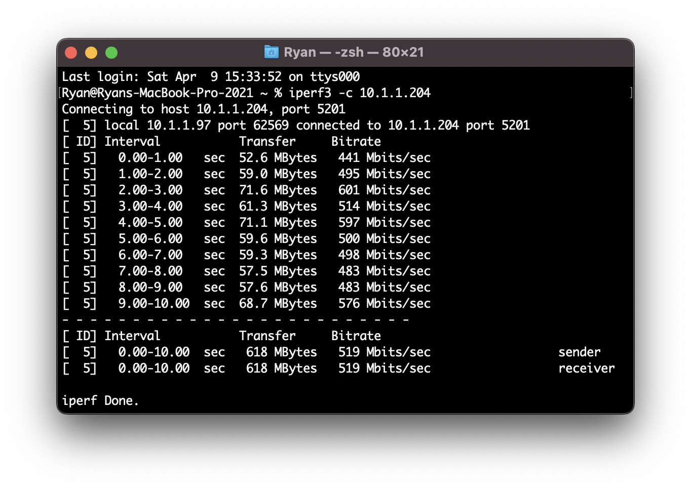

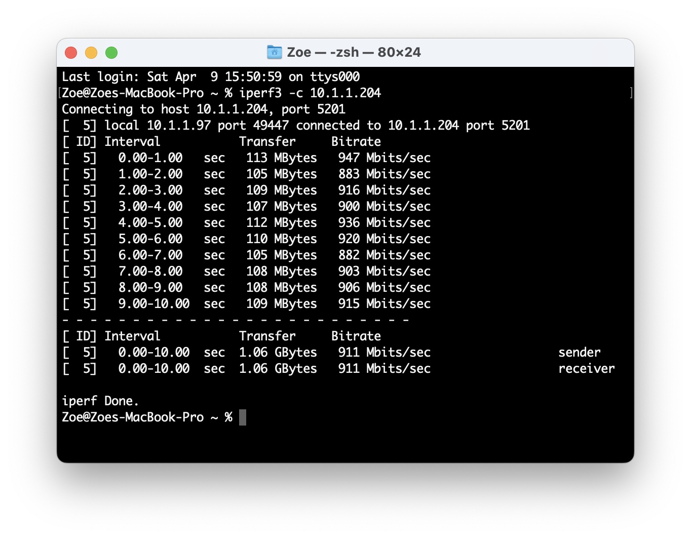

I have a 2021 16" MacBook Pro and my wife has a 2019 15" MacBook Pro, both running macOS 12.3.1. I have a UniFi gigabit network with a Dream Machine Pro and Switch Lite 16, also running the latest firmware. I ran iperf3 with my hardwired PC as the server and each MacBook Pro as clients one at a time using the same Ethernet cable and Cable Matters USB-C to Ethernet adapter. Here are the results:
  • 2019 MacBook Pro: 911 Mbits/sec
  • 2021 MacBook Pro: 519 Mbits/sec
I also got the same results with:
  • A spare Cable Matters USB-C to Ethernet adapter using the same Ethernet cable
  • A Uni USB-C to Ethernet adapter using the same Ethernet cable
  • Each of the three adapters with another Ethernet cable
  • Each of the three adapters with another Ethernet cable on a different port on my switch
  • Repeating the above steps with all three USB-C ports on my 2021 MacBook Pro

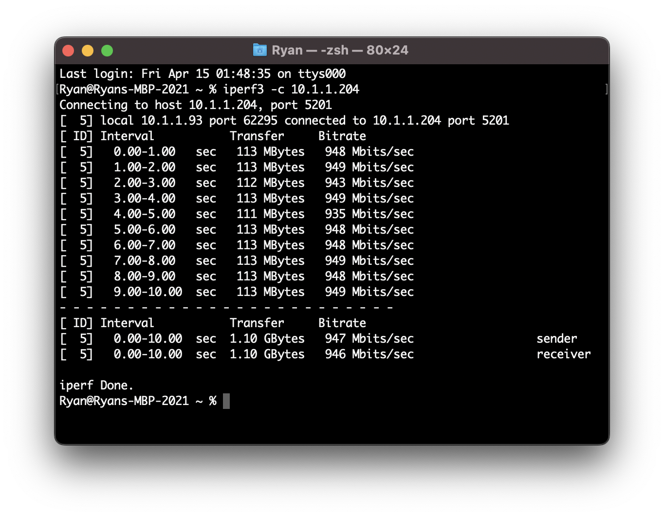

UPDATE
Thanks to @lcubed and @glenthompson for solving the problem.
The issue is that macOS does not have the gigabit USB Ethernet drivers to support the Realtek RTL8153 chipset that is used in the USB-C to Ethernet adapters that most brands use (and that I tried).
The solution is to purchase a USB-C to Ethernet adapter with a Realtek RTL8156 chipset because macOS does have the drivers to support these adapters. These are usually 2.5Gbps adapters (not 1Gbps).
I purchased the Plugable 2.5Gbps adapter - https://plugable.com/products/usbc-e2500
Hallelujah gigabit speeds via iPerf3!

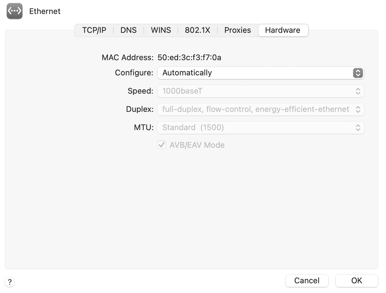

To see the speed of your wires connect while holding 'option' key while clicking the Finder Menu Wi-Fi icon in Finder Menu! A drop-down will give the information of the connection speed is at and frequency and other thing too!

OK! you made you point! Like others have said an bug in the Ethernet isa if you go into System Preferences->Network, Advanced button and look at the tab to make sure your set to max speed! Plus as former Network Engineer more and more people are still stuck in CAT 5E cables! The cutting edge is 10GH speeds CAT 7 cables! His networking speed would go way up!
