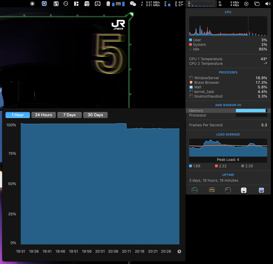

For VRAM, Big Sur use VRAM very aggressively. Even my Radeon VII has 16GB VRAM. The usage still stay at above 90% most of the time.
IMO, this is good. I pay the VRAM to work, not sits idle.
Anyway, VRAM usage stay high doesn't slow down my cMP in Big Sur. I can't feel any difference. If not checking iStat, I don't even know the VRAM usage is that high. However, I am with 11.2 beta (20D5029f). That may make the difference.
