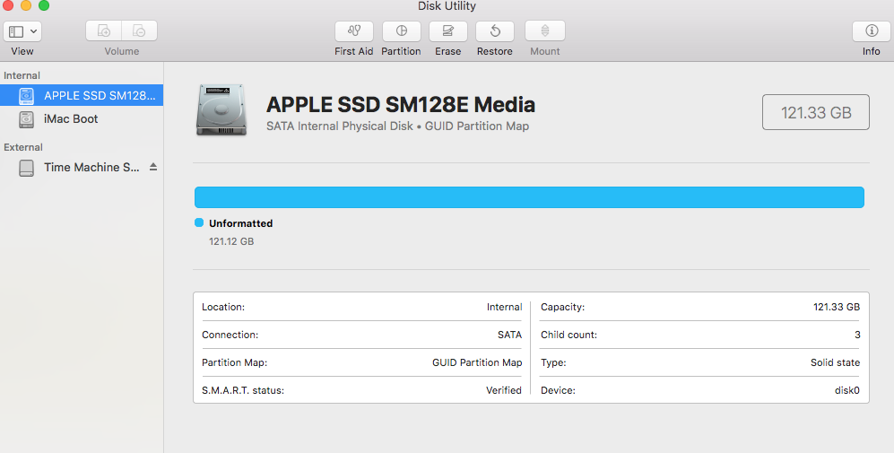

I got my iMac back from the shop (we don't have Apple shops here in Thailand, but it is an authorized service center) with a new WD Black 1 TB drive installed, and I used the Migration Assistant to restore the computer to its previous state.
Everything restored just fine, however, the computer now seems quite sluggish. It seems to take a long time to boot and to load apps. I'm wondering if this has to do with the fusion drive not being properly configured or perhaps in conflict with the cache on the WD drive.
Here is a capture from the Disk Utility. Is this OK or do I need to do some configuring?
Looks like you have an SSD, and a hard drive.
I suspect it is not configured as a fusion drive.

Just what I expected.
You have an SSD, and you have a hard drive. (and the two are not combined into the logical volume group that you would get after creating a fusion drive)
You appear to be booted to the hard drive, which easily explains why your system seems so slow and sluggish.
Search for "create a fusion drive". Something will come up to help you get your drives configured properly.
Be sure you have a good backup on an external drive before you begin (but from what you said, I think you have that already!) The combining process would wipe both the SSD and the WD hard drive.

I did, in fact, re-fuse, following Apple's instructions. It was really much simpler than I imagined. The whole process -- re-fusing, High Sierra install and Time Machine backup restore. -- took under 3 hours. The computer is now fast and responsive once again. Thanks to all for your help!
