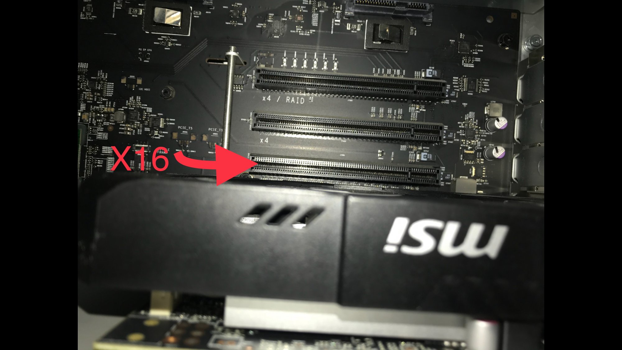

tsialex: since you’re just amazing, one more question that I’m having trouble getting a solid answer to:
I have 3 open PCIe slots open (in order from bottom to top going from video card up): (1) X16 then (1) X4 then at the top (1) X4 RAID (see pic)
My plan is to add (2) ssd drives mounted on (2) PCIe adapters
Which slots are best for these 2 drives? (One will be for system and audio software, the other will be for audio sessions and samples)
I’m worried because in any case I will either be mixing a combo of x4 and x16 slots OR I will be mixing x4 and x4 RAID slots
What is best for (2) PCIe adapter ssd placements in this case where only 3 slots are open?
Thanks!
Thanks!
Won't matter, all M.2 blades are x4 or less. M.2 connector is a miniaturised version of a x4 PCIe slot.
Use one x16 slot, if empty, and one of the shared x4 slots.
I just attached pic, wait, not m.2, I’m talking actual ssd drives mounted on OWC pcie adapters :
With more than 500 MB/s of throughput, the Accelsior S dual-lane PCIe 2.0 card delivers flexible storage expansion - with a speed boost - to your Mac or PC. Accelsior S is the perfect complement to OWC's Mercury family of high-performance SSD's, allowing for super fast storage expansion.
Since it's a x2 card, you can even use the x4 shared slots.
Ok, awesome as usual
So I can put these 2 in any combo of open slots shown in pic?
Ok to put one of the 2 in the one x4 that seems to be reserved or meant for “raid”?
Thanks!
Thanks!
Like I said, yes. RAID slot is a standard x4 slot + the RAID card connections and can be used as a normal slot for other cards.
