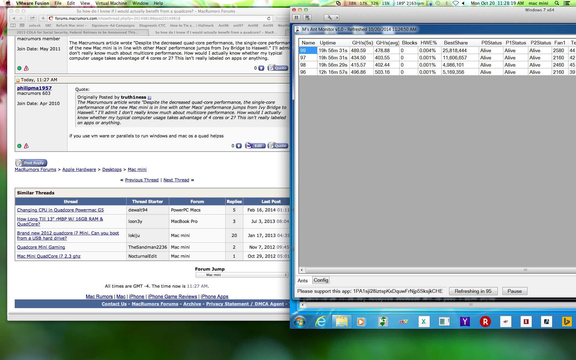

if you use vm ware or parallels to run windows and mac os a quad helps.
the thumbnail shows a vm run windows with a btc mining app. This mini is a dual core 2011 with the discrete gpu. I do very lite vm windows 7 in the background so I get away with a dual core mini
