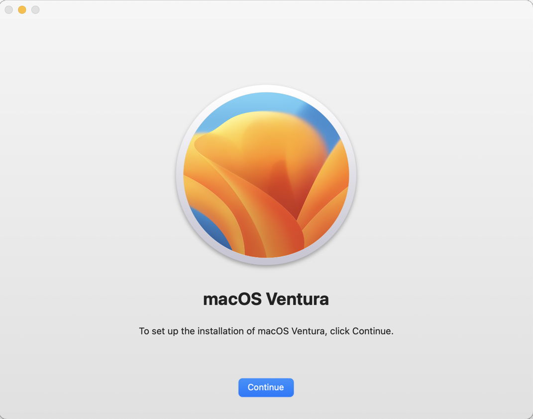

I had trouble installing as a second boot on a Thunderbolt drive. Had to install Ventura on the second drive first, then update that to Sonoma.

It seemed to install fine but then failed to boot. Then the drive disappeared. Restarting on the main disk all looked ok. Install on the external disk with Ventura worked without a hitch. The upgrade using the full installer worked fine. I did not try the switch-to-beta mode.
There is an occasional hiccup switching between system disks where it will not properly boot from Sonora on the external disk. Turning it off and back on fixes it.
If I would do it over again, I would have installed on another volume on the main disk, but I would have had to juggle disk space. I have invested too much in having my full system running dual boot. I have a lot of stuff on this environment - apps, Xcode dev with repos, Logic Pro and Final Cut with a bunch of midi.
