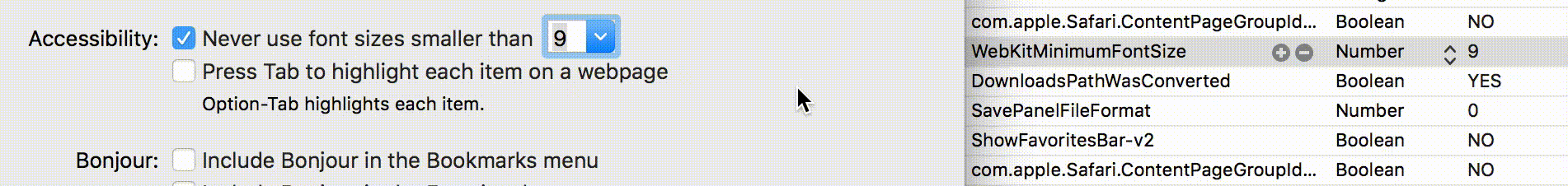

Can't you do this from Safari / Preferences / Advanced : Accessibility : "Never use font size smaller than..." ?
No.
This would affect the view of the webpage itself and would basically just mess it up and make everything look horrendous. It has nothing to do with solving the issue in question.
No.
Dude, it's the same thing. The fact it says com.apple.Safari.plist should've told you that.
Many apps or widgets uses the same WebKit framework that Safari also uses and if you change the setting in Safari, it can affect these apps as well. Because this is an accessibility option, Apple is probably telling Lookup to read the Safari plist for the size.
In fact, just change it in Safari and you'll see the number changed in the plist file as well.
0 means the option is turned off in Safari. Enable it and change it to 12 in Safari, changes it to 12 as well in the plist.

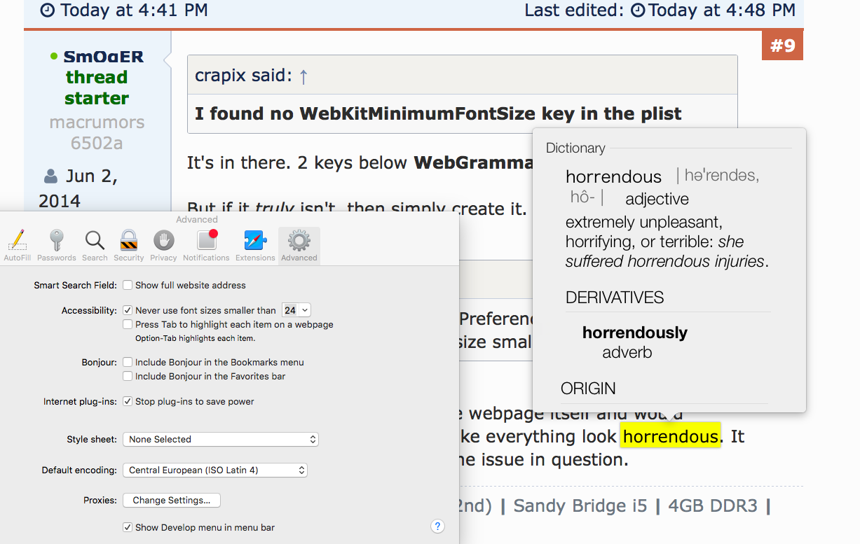

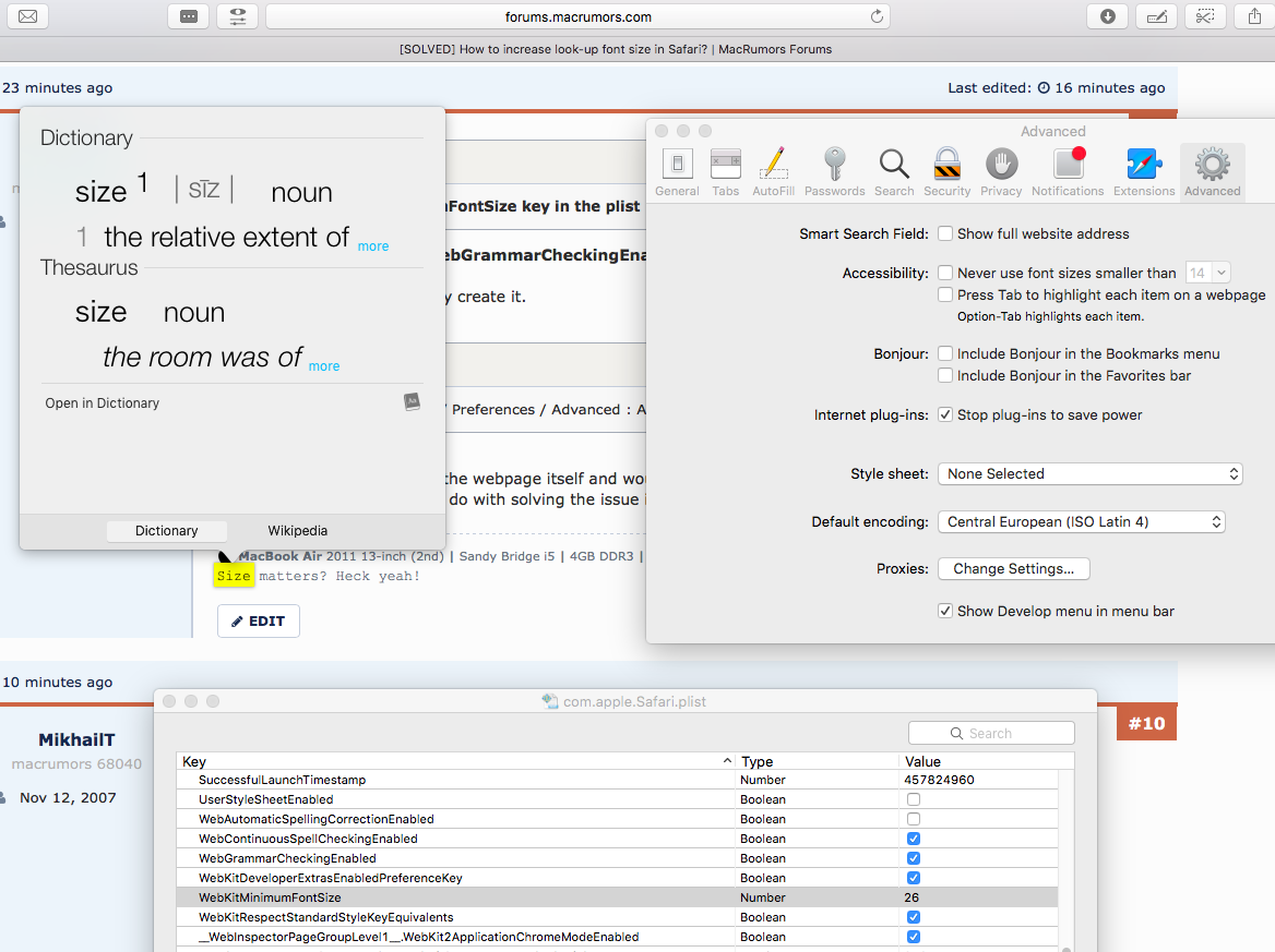

You are wrong.
It does change from the GUI, but in GUI there is the global setting which affects several keys related to the font size, therefore the end result is that you won't be able to see ANY fonts smaller than that number.
Now my solution is isolated mainly to the lookup popout:
1. Safari GUI option remains disabled.
2. Unlike the GUI option, webpage fonts remain MUCH smaller than 26 (used it that big to make it even more obvious) maintaining their original scale.
3. look-up description is just about the only thing which gets affected.
If I was to set ~26px as a minimum font size in Safari preferences, you wouldn't see any text in website screenshot smaller than the font size in that look-up description.
Now try to set global minimum font size ~26px in Safari GUI and see for yourself how awful it would look like:
