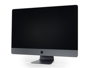

I found this iFixit article. It's about installing Mac Pro SSD modules into the iMac Pro so the info is probably applicable to the Mac Pro. People report that the SSDs don't work if you switch them into the wrong slot. So if they don't work one way, switch them. (The person who posted that later found they had them reversed and the Mac Pro SSD modules do work in the iMac Pro.)
Someone also asked if iMac Pro SSD modules can be used in the Mac Pro and someone said no, but I don't know the technical reason. Maybe they don't work if they're used from another system. If they're new I would think they would work.

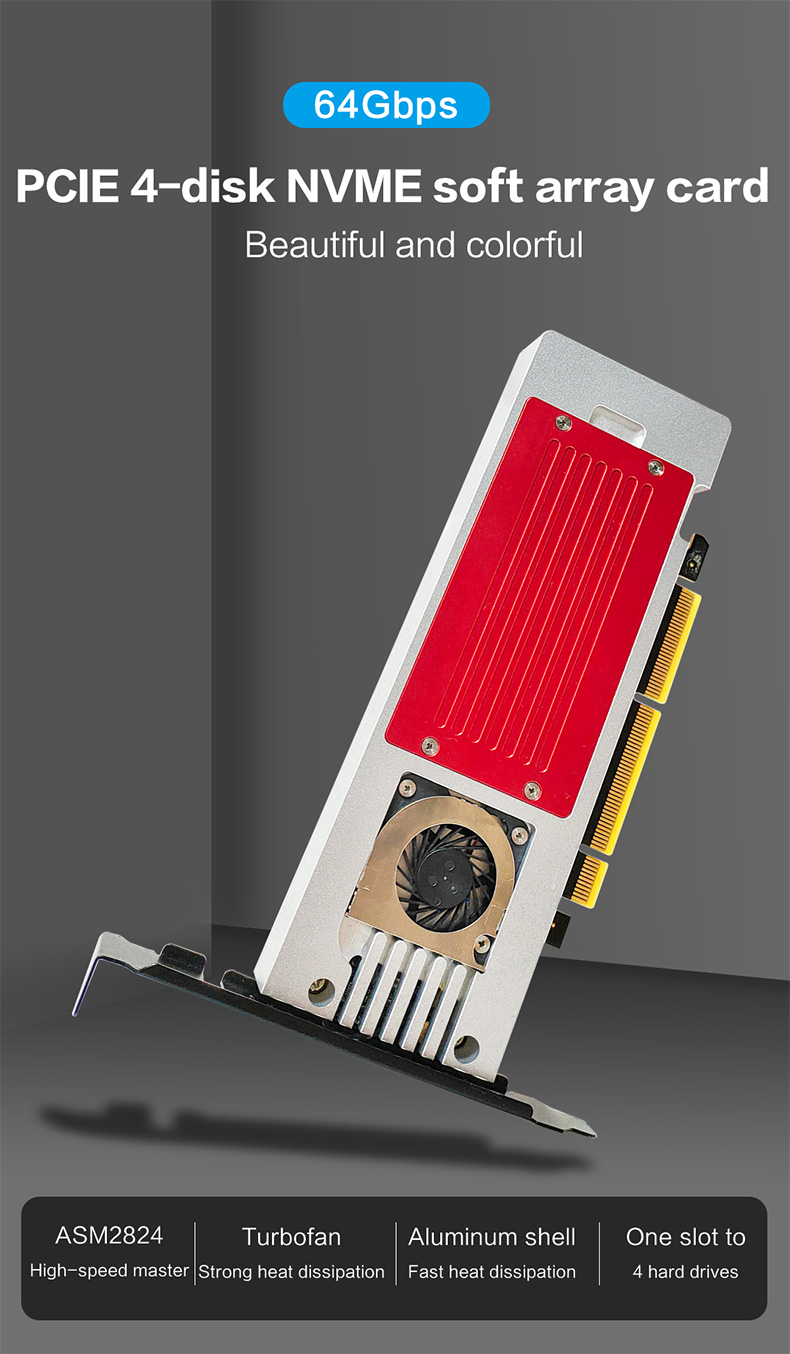

A PCIe x16 card with 4 M2 slots (capable of gen 4 x4 nVME) is around 100$. Much more versatile than the upgrade kit offered by Apple.
I think you are mistaking PCI Express Lane Partitioning (aka bifurcation) cards for PCs with the Mac Pro required PCIe switched cards.
The cheapest ASM2824 two blade PCIe switched cards compatible with Mac Pros are around $140 from AliExpress and almost $200 for a very basic and ugly as hell 4-blade card.

Thank you for the knowledge.
It seems to me that a cheap single M2 slot nVME adapter with 4TB vNME blade is still a better solution than the Apple ugrade kit.
This one cost 250$ (4 M2 slots for non-bifurcation motherboard)
