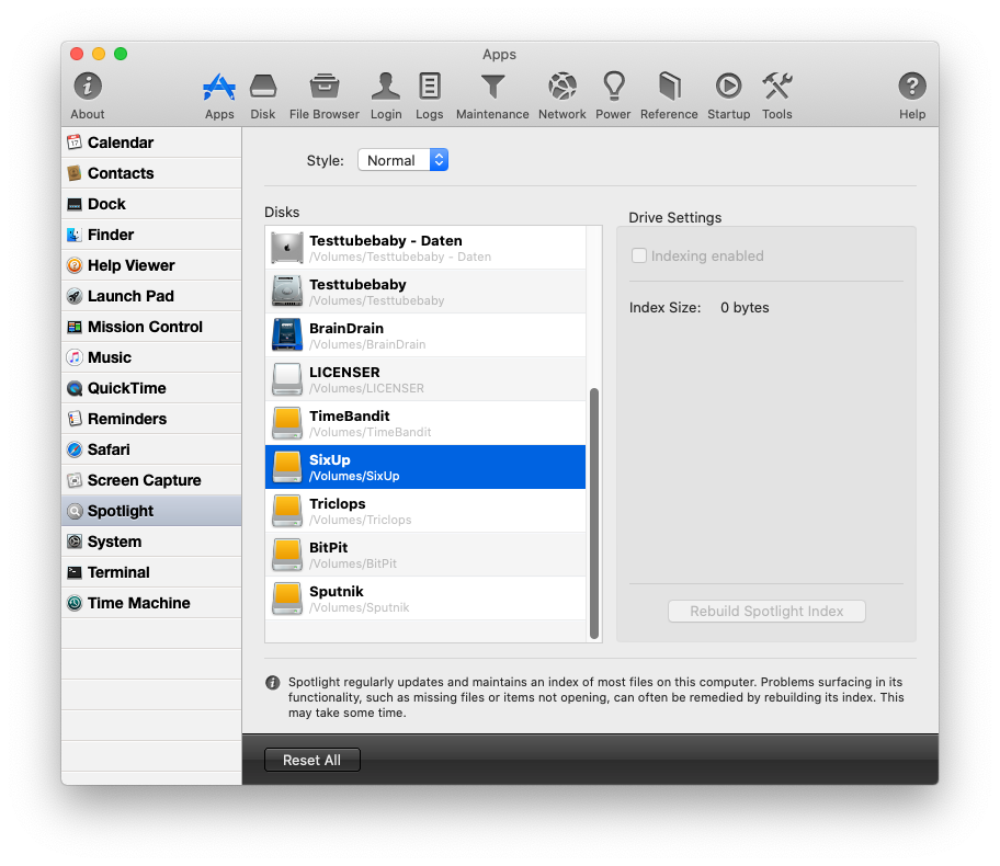

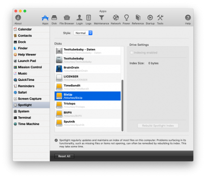

I have the same problem with my external USB drives on my Mac Pro 5.1. with Opencore
mdutil -s /Volumes/* gives for all 4 external drives, including a new one, just bought and newly formated
Error: unknown indexing state.
Indexing of the newly formated drive only worked until the next restart.

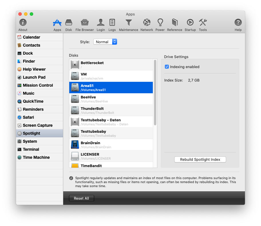

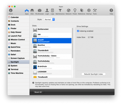

Checking the disk with a tool that gives more information like Macpilot shows indexing for the external USB-drives is disabled and can't be enabled (greyed out). This only happens with my external drives and only booted in Catalina. Under HighSierra and Mojave everything is ok. I Think its useless to copy 16 TB to another drive and format the drive only to find out that indexing is again disabled after the next restart
I couldn't find a solution up to now. Something is wrong with Catalina and my external drives
Bildschirmfoto 2021-04-09 um 17.42.06.pngBildschirmfoto 2021-04-09 um 17.41.46.png
