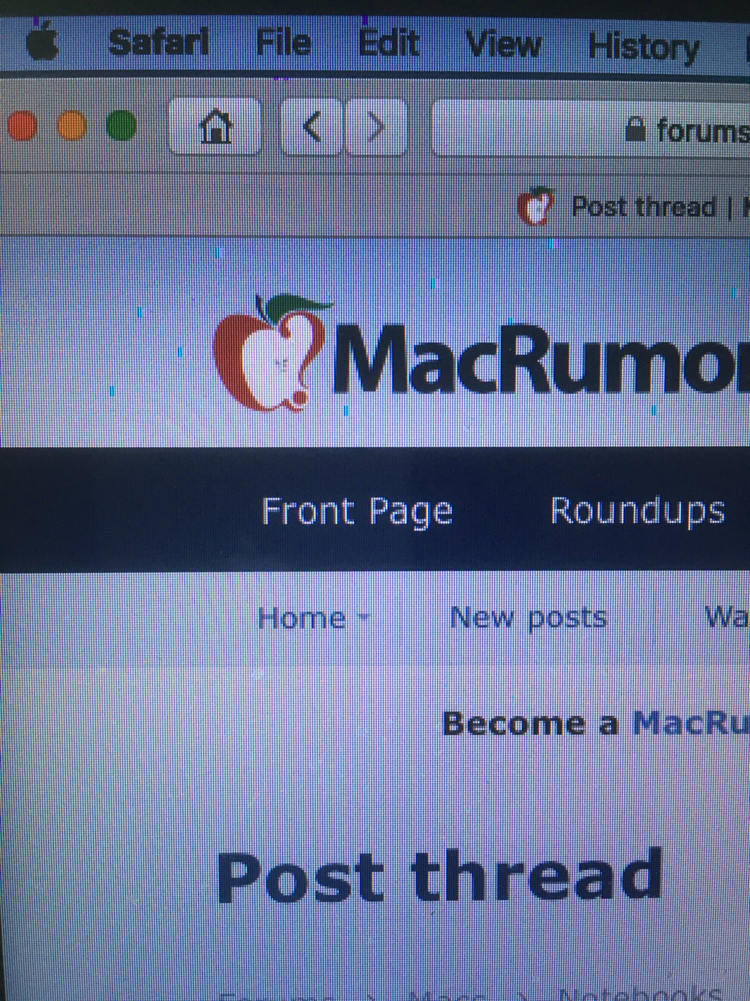

13" Mid 2012 MBP made in early 2016 with original HD and running on High Sierra, the ram was upgraded to 16gb several years ago.
When using Firefox last night, colored dots appeared on the screen and the browser crashed.
Firefox is now unusable, it crashes on the google home page which gets covered with yellow, green and blue dots.
Safari seems be usable but it gets blue or white dots on light areas of pages and red/purple/pink dots on images/media/ads.

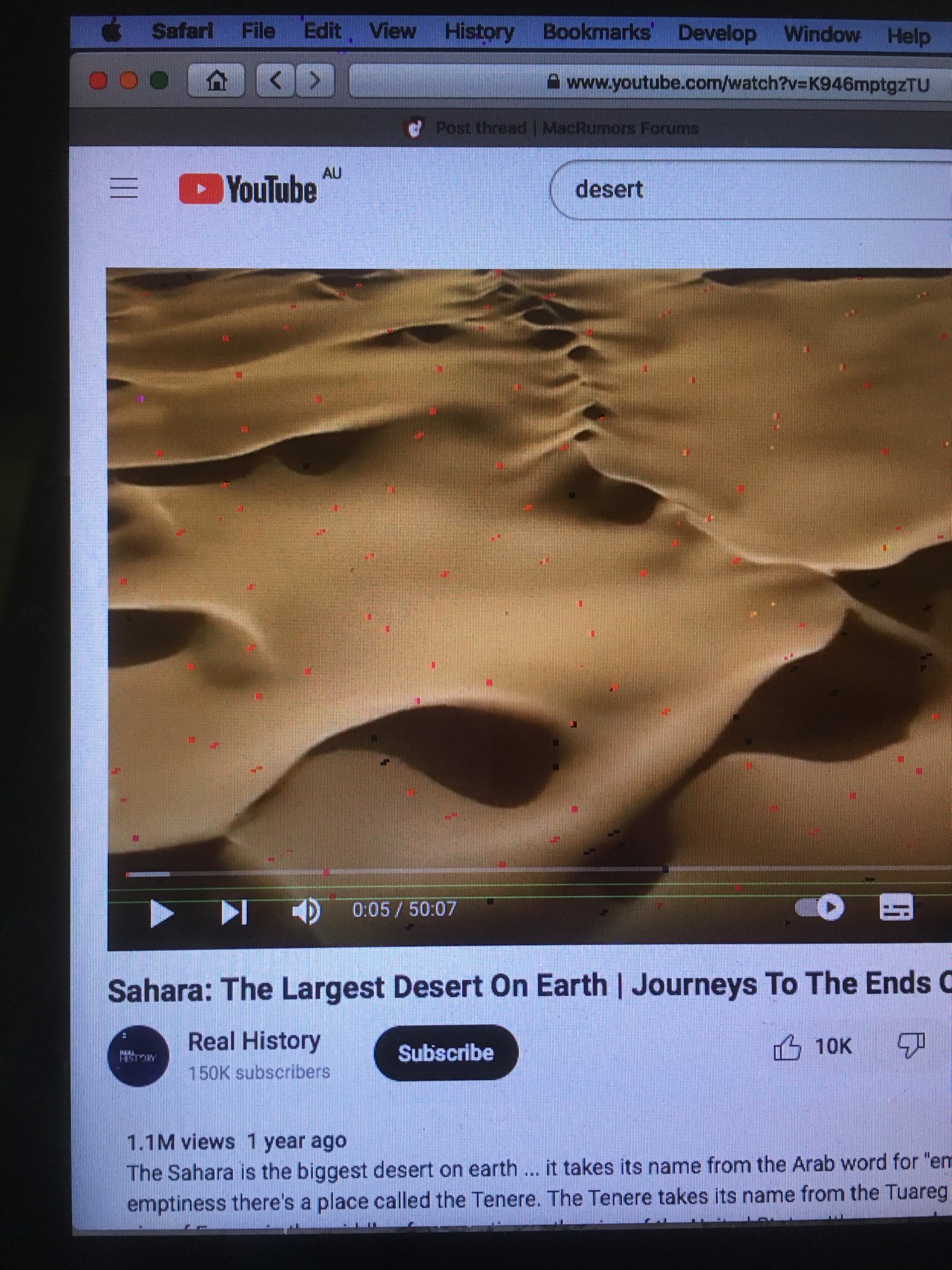

Youtube videos have moving coloured dots like rain, when the the video isn't on fullscreen, the white areas of the screen is clear of dots.

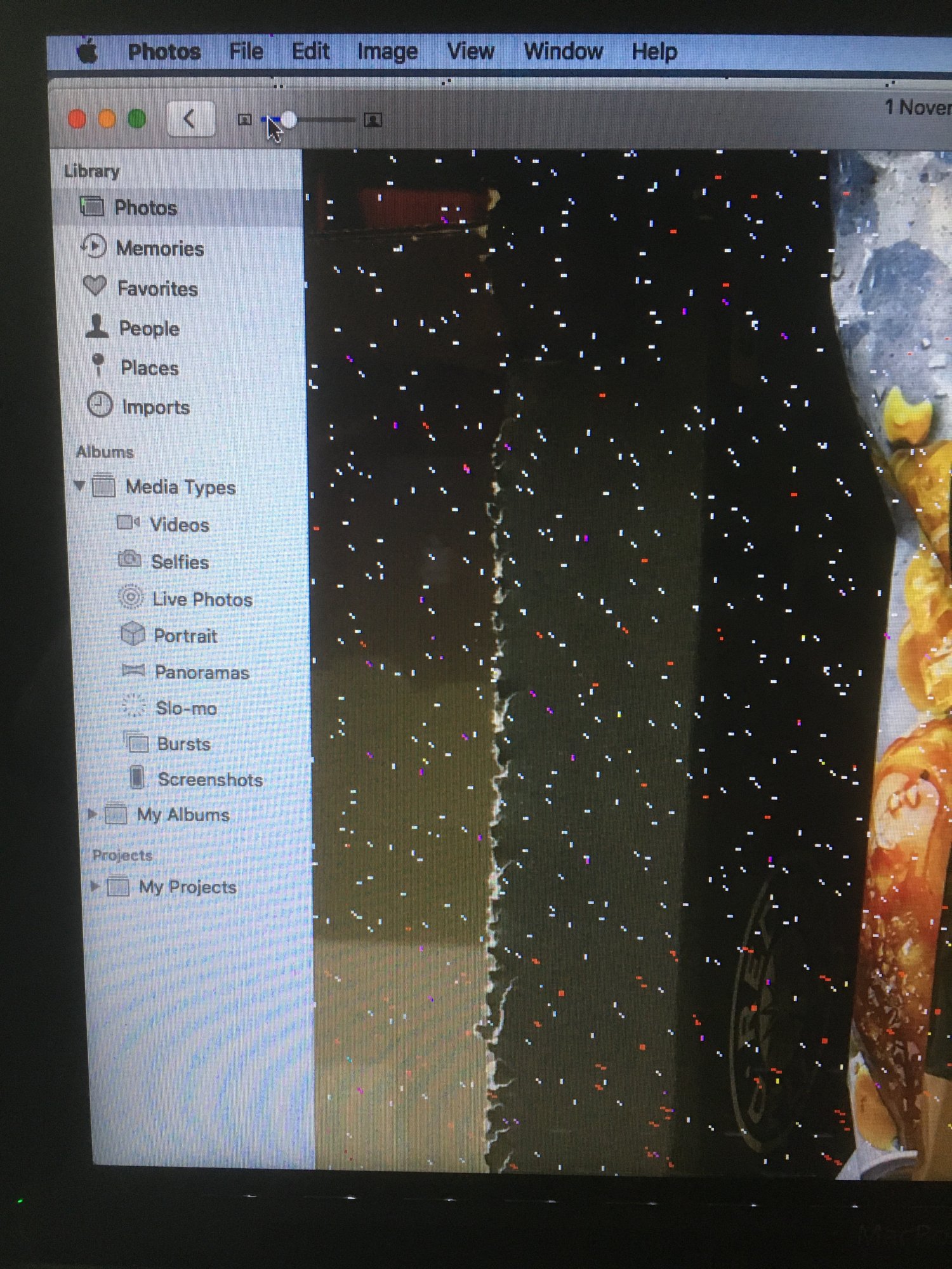

Photos are covered in dots.
The statusbar has a few purple dots.
Videos on Quicktime have the rain of dots like youtube.

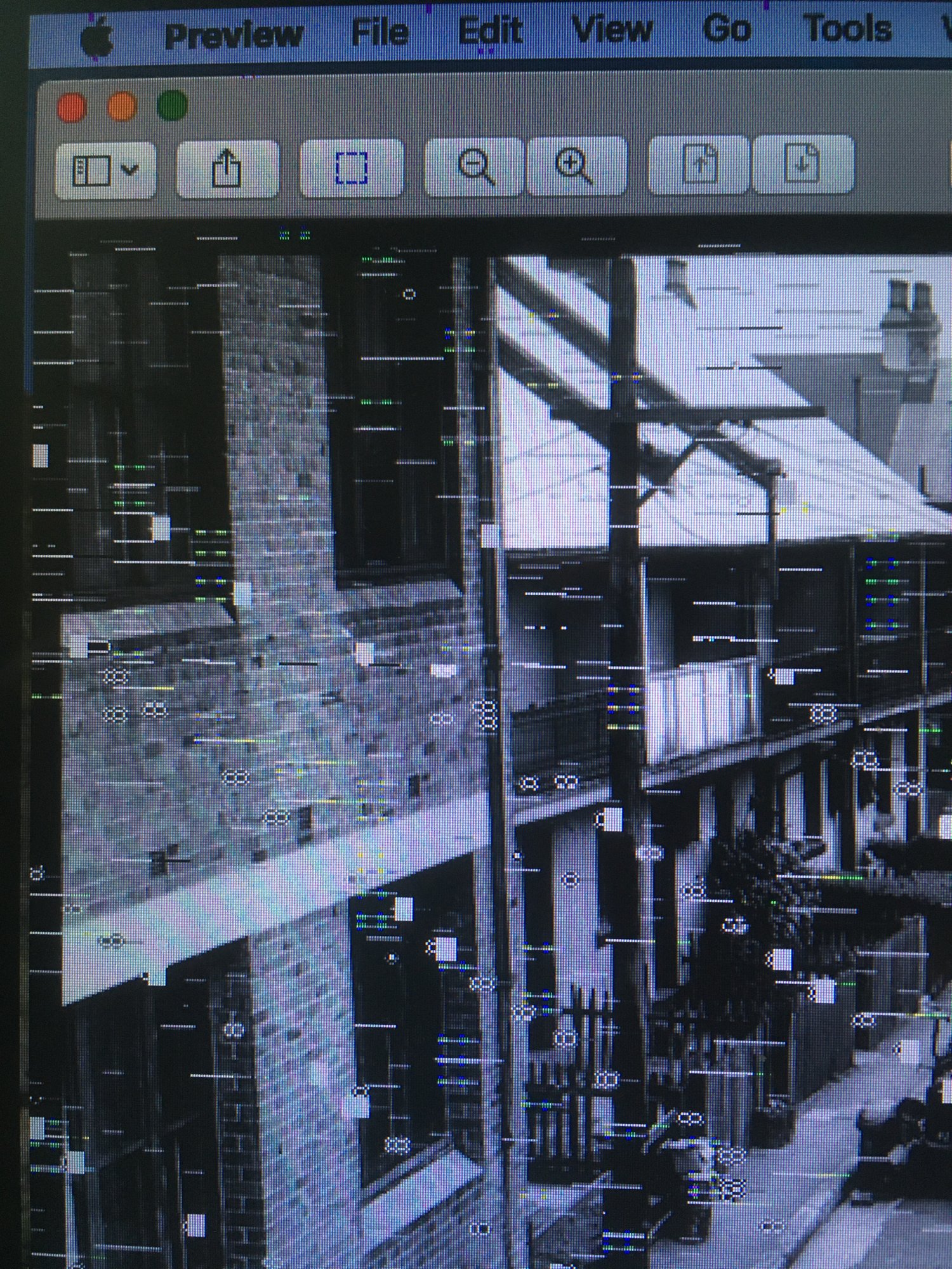

Screenshots/images have dots and small lines when opened with Preview.
Audio and music still plays fine.
PDF's open fine on Adobe reader but have spots in Preview.
Images that have spots/lines on Preview, look normal when opened on Gimp.
