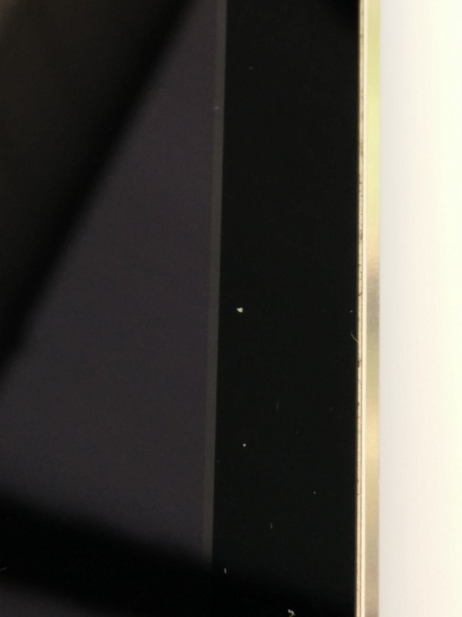

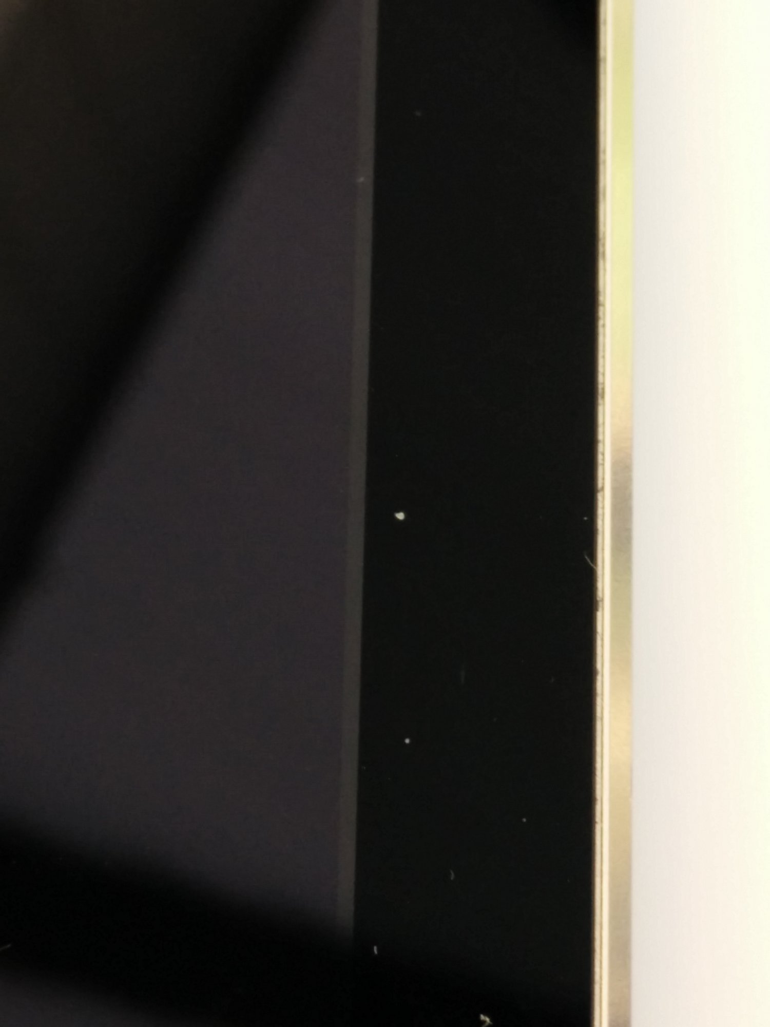

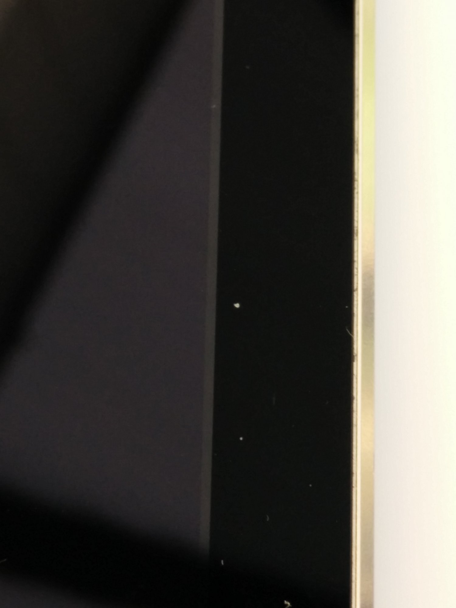

It could be that the screen is not properly adhered (glued) to the chassis. I had a similar problem with an iPad Pro 9.7”. At least that's what I think the issue was caused by.
What you can hear is it sticking down when pressure is applied and then peeling off. You might have to turn the volume up to hear it -
When I looked closely, I could see that the screen was not aligned correctly in the chassis. There was a gap on one edge and this may have contributed to the issue -

I tried putting some books on top of the iPad in the hope that the weight would help the screen stick down, but that only worked for a short time. In the end, I sent it to Apple for repair and they replaced it.
The video and photo above were attached to the repair request - I’d had a previous experience of Apple returning a faulty iPad when they couldn’t see what the problem was and wanted to avoid the same thing happening again. I’d suggest you do the same as it’s not the easiest thing to replicate, especially in a noisy shop.
It’s possible that the misaligned screen was slightly bowed - the glass is very thin - and that’s why it wouldn’t stick down.
