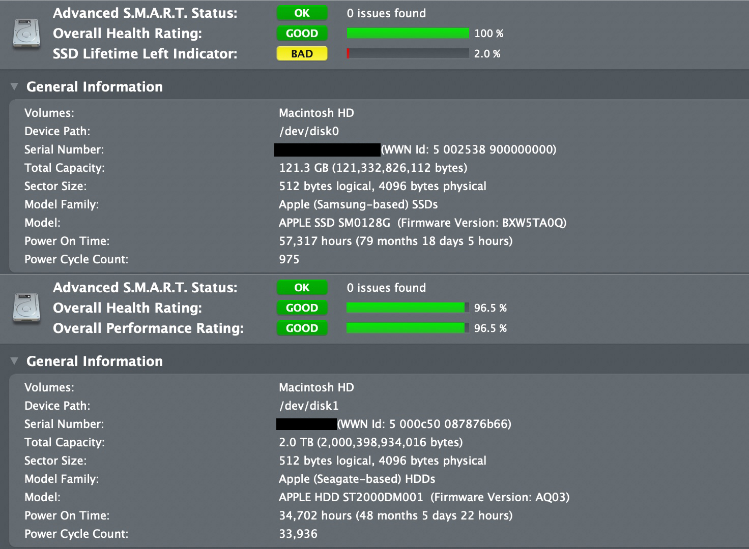

I'm not sure I know how to read a drivedx report on a fusion drive. It looks like the first part is the SSD and the 2nd the HD.
The SSD part shows an overall health rating of 96.5% which is in conflict with the SSD Lifetime Left indicator. Unfortunately the Data Units Written is not shown.
Also interesting is that the power on times are differrent - ~57k vs ~34k hours. Shouldn't they be the same?
What does health indicators show?

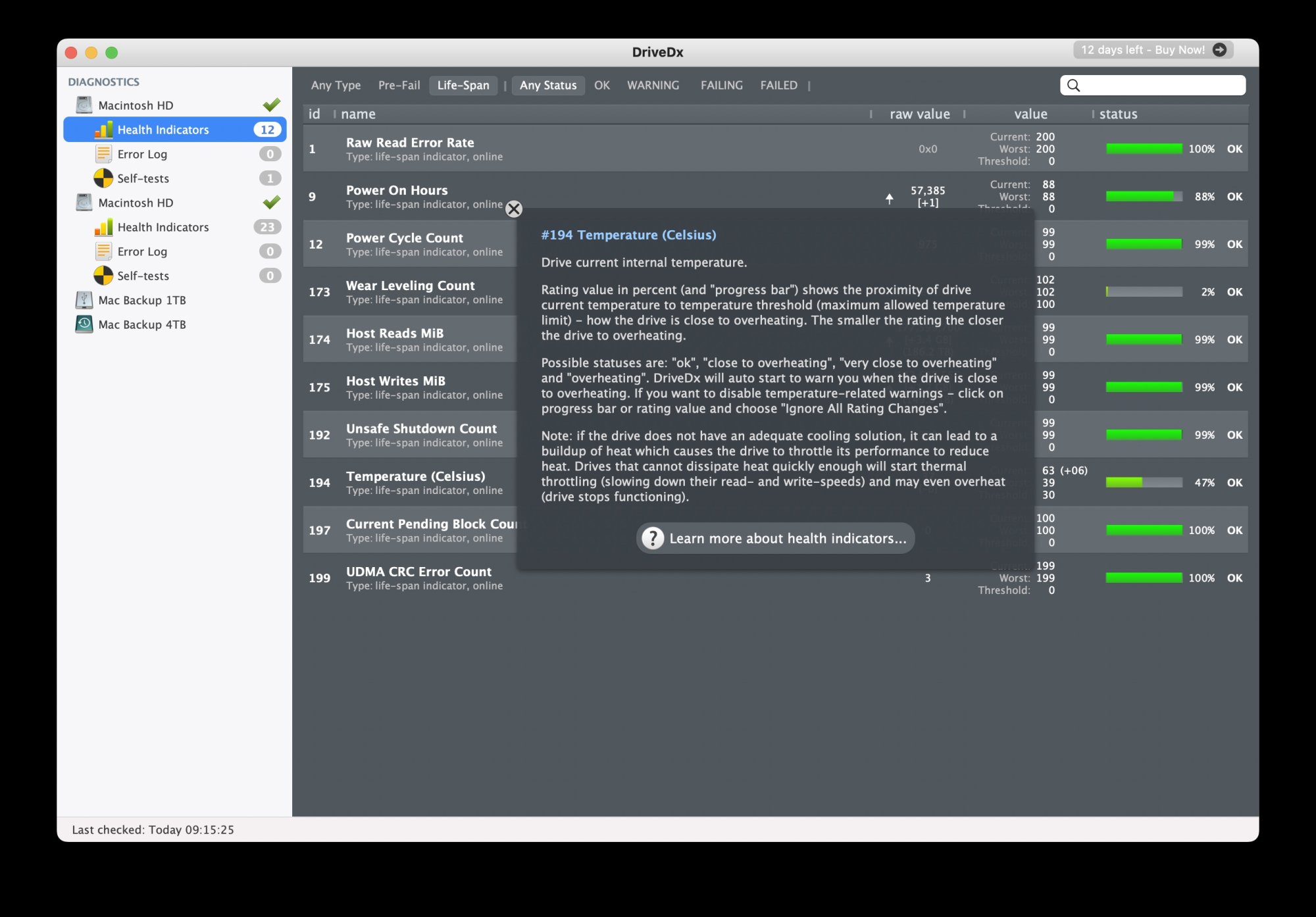

I actually started wondering myself how and what is exactly indicated/tested by DriveDX. As shown in the test image the overall health rating is 100% (good) but the lifetime indicator is bad. There are no errors on the ssd. I'll add some more ss of the test. One thing I did notice in the activity monitor (this is not something I look regularly at) is that there is always around 1.20GB of swap being used. I don't know if this is a good, bad or normal thing but I've seen a lot of discussion around it.
And yes.... in the top in the initial image is the ssd and the bottom the hdd.

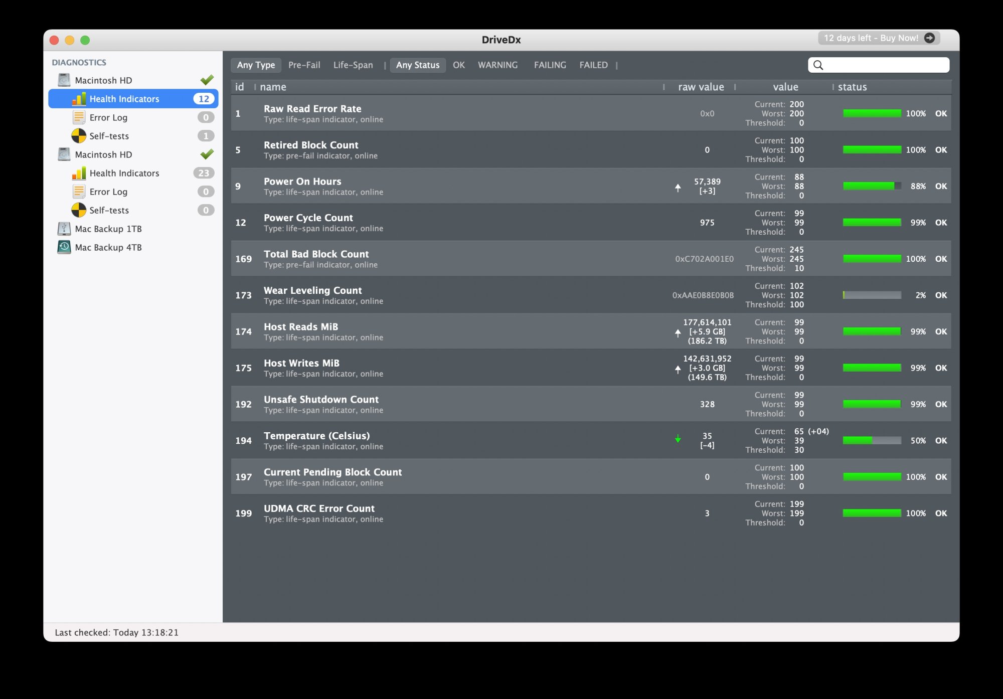

Could you post those without those messages obscuring the wear leveling count numbers? The SSD appears to have more than 6 years of Power On Time and is only 128GB as compared to the 2TB HD. Since the SSD in a Fusion drive acts as a large cache for the HD I'm assuming that there's been a lot of read/writes to get the wear leaving down to almost nothing.
Looks as if the wear leveling table cells are close to being exhausted but the rest of the SSD itself is fine? Not sure how the 2 interact when the former fails.
just get an external SSD to boot from before the internal set up fails.
I would make sure your 3-2-1 backup strategy is in place. Getting an external boot SSD does seem like a good idea since it would likely give you better performance as well.
Not exactly sure how to read the Wear Leveling Count values since they don't appear to be especially bad, but the Host Reads MiB/Host Writes MiB are approximately 150 to 200 TB each. I suspect that that much traffic going through the bottleneck of a 128GB SSD being used as cache are going to wear it out after six years, since the way a Fusion drive works requires the shuffling of a lot of data on the SSD, increasing the write counts on the pages.
