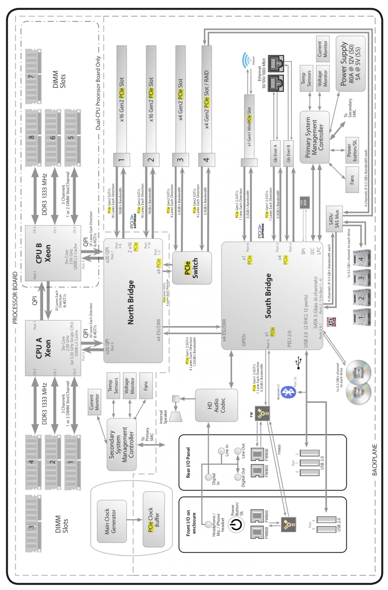

They are not the same, please see Mac Pro 2010 diagram.
I do not know about why RAID-card is marked on the 4th slot, but possibly there might be a hint in the diagram. Follow the arrows to the SAS/SATA Mux.
Reactions: hwojtek
OK, I had to take a look on the mobo itself - I think slot 4 is marked "RAID" simply because the connector for the SATA backplane is nearby and placing a SATA RAID card into any other slot would make physical connection between the card and backplane impossible.
