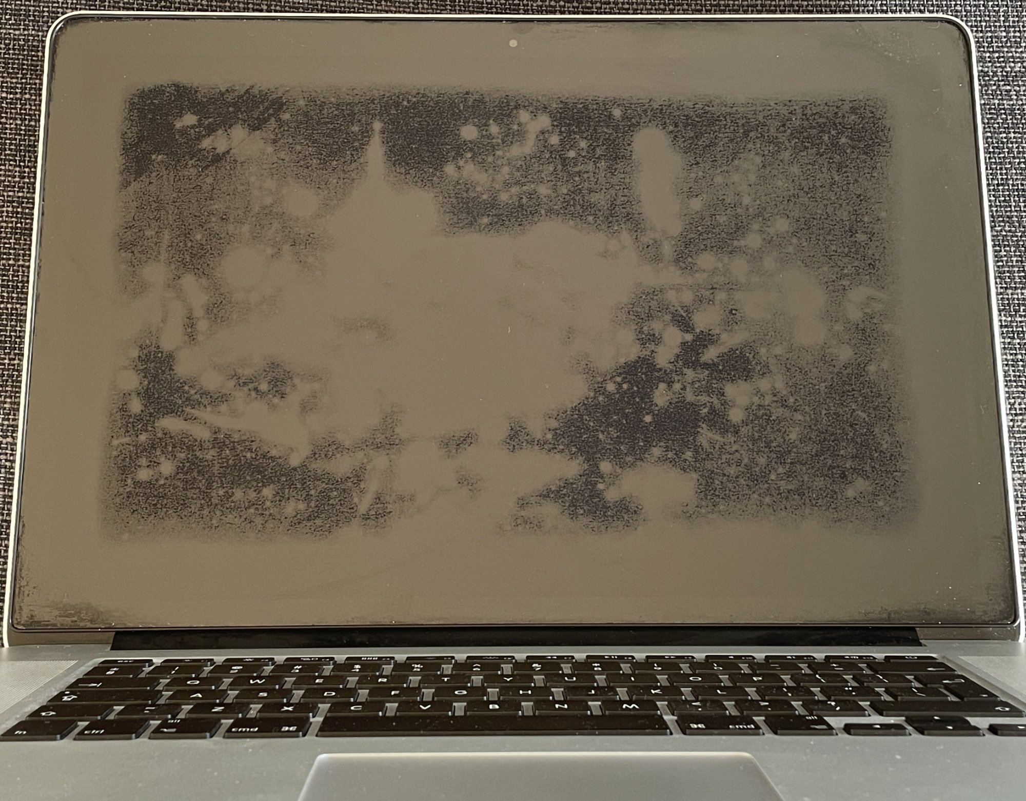

Yes, I have one of those too and I had it replaced under the Apple recall programme and now it happens again. Recall programme no longer in effect.
So now I like to remove it myself as the MBP is still in good working order.
But there is the snag. I tried many things and there is about 1/3 of the screen that refuses to give up the coating. To put you in the picture of what I used and did not work. Hope if did not forget one as I maybe forgot one after all the days that I am at it.
Baby wipes
Baking soda mixture
Carpet-cleaner fluid
Coke (as in the drink 😊)
Deferent kinds of glass/window cleaner
Disinfectant in several forms
Disinfecting wet wipes
Hand soap
Isopropyl alcohol
Listerine
Nail polish remover
Oil
Sticky tape
Toilet cleaner
Toothpaste
Washing-up liquid different brands
All of them I used by rubbing and some I used by letting it soak and next rub. Some I used in combination by mixing them.
As you may guess I am a bit desperate here. And I figure I am not the first on the be here. So, who has a solution that is not available on the internet. Believe me I ploughed the internet for at least 2 hours. But most of it reaps the same solutions, the Listerine or Baby wipes method.
Thanks.

Good morning and thank you for replying. Indeed, Listerine and a microfibre cloth did not do it. See I got the first damage of by simply cleaning it with a cloth and screen cleaner. What was left did come of a little bit with Listerine, but as you can see on the picture there is remains. And that was treated with the stuff I listed above to no avail.
I enclose a pic what the screen looks like.
Further research showed me a product form France that claims to solve it. 4STARSCLEAN KIT - Cleaning Spray. I am suspicious if that would work. I suspect it is no more powerful than any of the things I tried. Has anybody out there tried this?
Do you see any issue when the MBP is actually powered up? I have three 2014/2015 MBPs all suffering Staingate but there is no trace of it on the display once they are powered up.
I used Clorox Disinfecting Wipes, Crisp Lemon Scent and lots of elbow grease, and I removed the laminate schmutz from a Late 2013 13-inch and a 2015 15-inch rMBP.
It also takes a few minutes of strong scrubbing before you see anything disappear, but it eventually does.
Screen seems a tiny bit brighter after I removed all the laminate.
Thanks Earl. Believe me elbow grease was used to no avail. If you look at the psot on the right of the picture it had about 2 hours of treatment.

At this point I'd try some WD40... you said you tried Iso Alcohol? Was that 90%?
I removed mine completely using a paste of baking soda and water. It took probably 2 hours with a good amount of vigorous scrubbing but I got there in the end.
I did try the baking soda and water too. Removed a tiny bit but after working one spot for ± 20 minutes with no result I gave up on that too.
Just be careful in vigorously scrubbing on the screen to remove the anti-glare coating. If you scrub on the screen too hard you will crack it.
