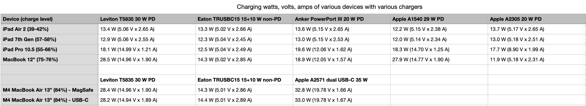

Actually, we usually don't even use the Apple AC charger at home, as we have USB-C electrical outlets. Below are my results for charging Wattage, with the laptop already charged to 84%. They are very similar for USB-C vs MagSafe.
Our Leviton 30 W USB-C outlet with Power Delivery charges the M4 MacBook Air at ~28 W.
Our Eaton 15 W USB-C outlet without Power Delivery charges the M4 MacBook Air at ~14 W.
The Apple dual USB-C 35 W charger charges the M4 MacBook Air at ~33 W.
