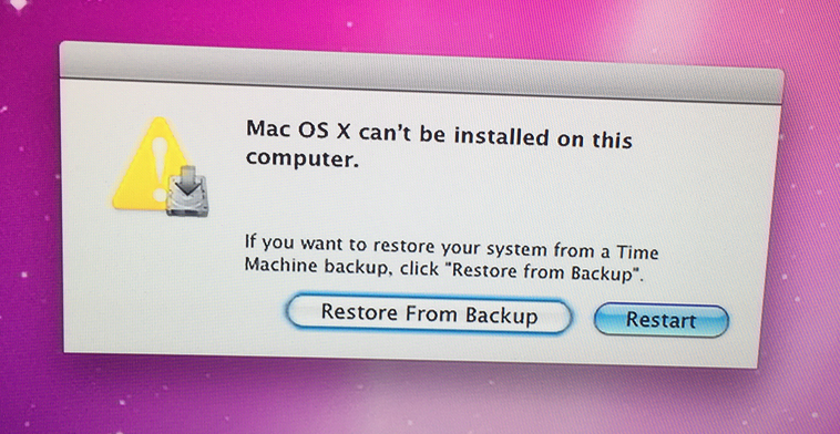

Something else must be wrong cause SnowLeopard can be installed.
When trying to install Snow from the original bootable dvd, i get the following msg :oops:

Is the disc you’re using the original for that specific Mac? I ask because if that machine shipped with, for example, Mac OS X 10.6.2 and the install DVD you’re using is 10.6, even if it’s for a 2009 mini, it won’t work.
In the case of trying an older version, the behaviour would be different. And since the late 2009 mini is almost the same machine (apart from a slightly faster processor) as the early 2009 which shipped with 10.5.6, 10.6 (that is, 10.6.0) does work on it.
Yes it came along with the mini

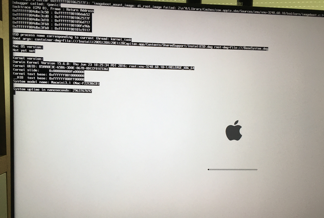

This is what i get when trying to boot with ElCap. The installation bar does begin, i get this msg/error and a reboot that loops.
