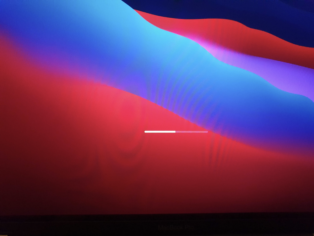

M1 MBP.
This first happened on Monterey Beta 1, repeated on Beta 2, then I downgraded to BS 11.4 just to eliminate Monterey as a cause, but its still there.
Issue:
Mac runs on battery and when battery is depleted to 30-31%, Mac just freezes, screen goes black. Looks dead for several seconds (non responsive to power button), then either:
1. Mac is dead until I plug in the charger. When I plug it - black screen with red, empty battery appears, and after several seconds it starts booting
or
2. Empty screen with wallpaper appears and with progress bar appears.
In any case - when I am back to desktop, battery shows that its back at 31-32% and it goes back to normal.
Battery health is 100% and I use AlDente on all OSes.
Any suggestion is much appreciated. I would hate to return it - but in this state, it its unreliable as it happened during some important work being interrupted.
Header of the error, following system reboot: happy to send more data of someone knows to read
panic(cpu 2 caller 0xfffffe0024387318): DCP PANIC - set_run_mode_safe: 0x8000000f - iomfb_ap_callee_1(18)
RTKit: RTKit-1558.120.1.debug - Client: local-ipad13dcp.release
Time: 0x00000014350185ae
Faulting task 18 Call Stack: 0x00000000000297e0 0x0000000000029294 0x0000000000015068 0x000000000013d050 0x000000000013885c 0x00000000000b4710 0x00000000001059cc 0x00000000000b4c30 0x0000000000108808 0x00000000001101c0 0x00000000000a74a8 0x00000000000a6a6c 0x00000000000a8480 0x0000000000029c68 0x000000000001a414
RTKit Task List:
