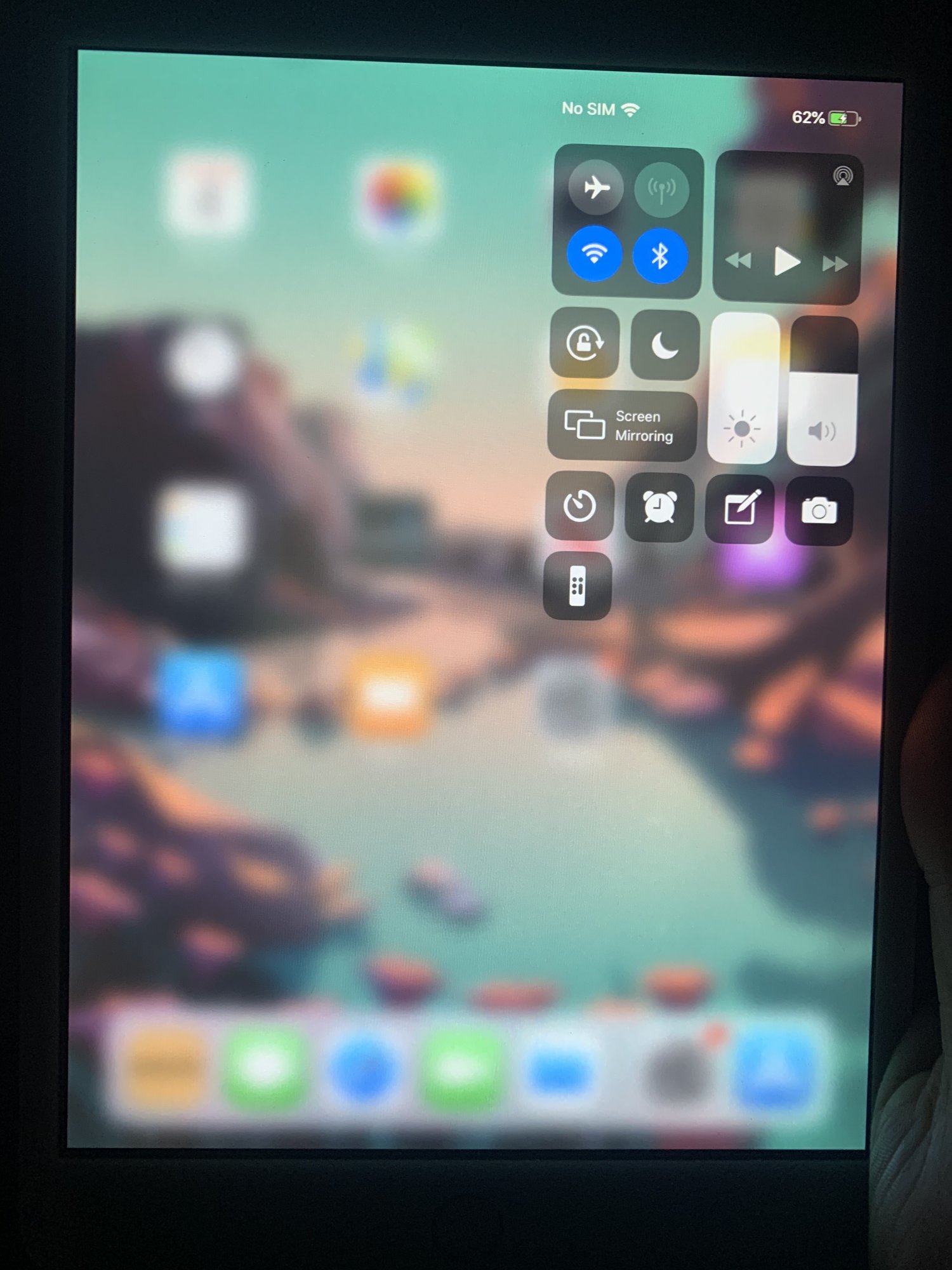

my iPad mini 3 hasn’t been used for a while fired it up today and it had a strange large mark in the Center of the screen. Certainly colours seem to highlight it more where as a colourful cartoon seems to disguise it?
many way to repair this?

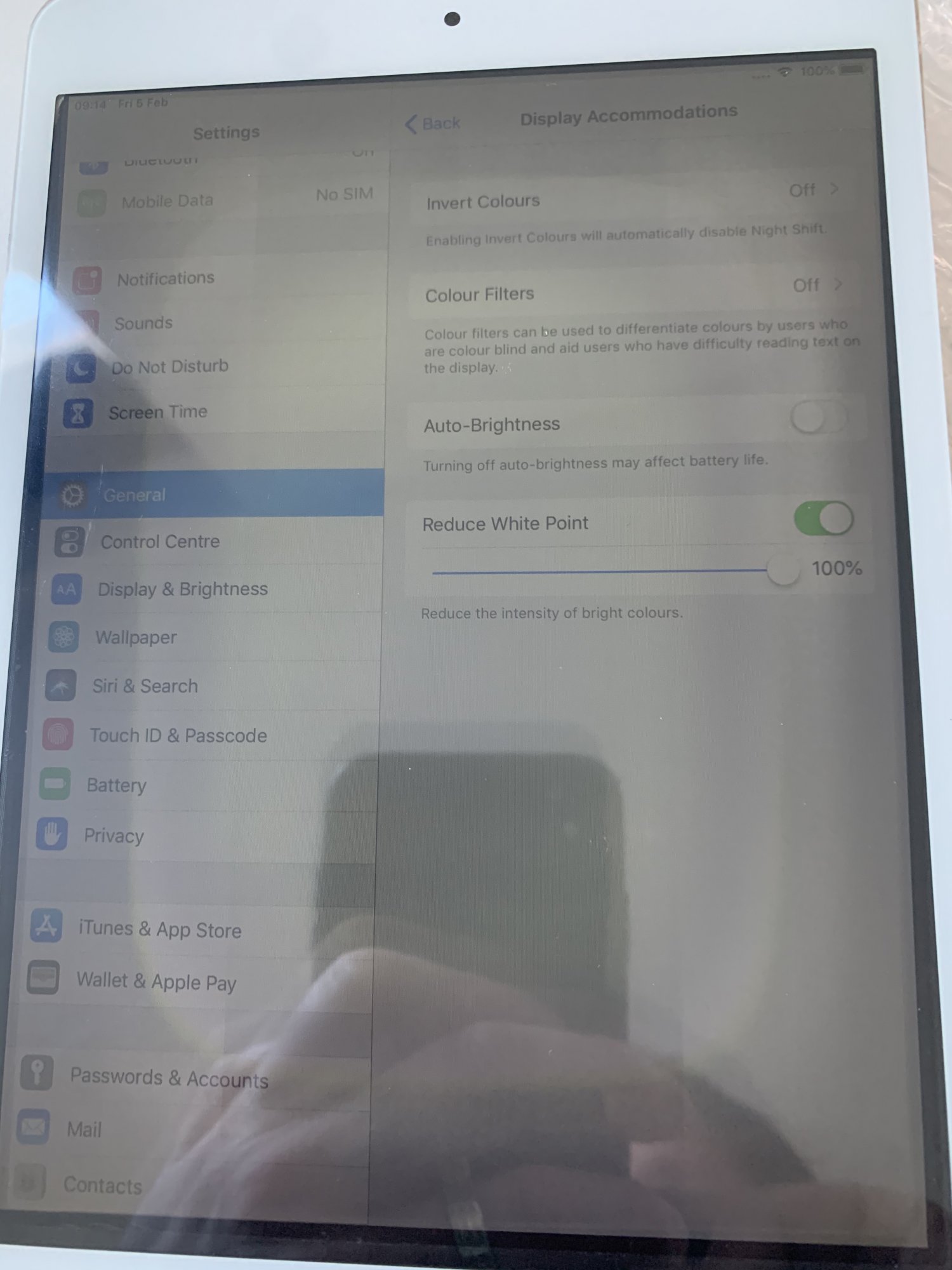

Stupidly I did almost the opposite while waiting for your replies i set it to full brightness on a white background and disabled lock in case it was some kind of screen burn.
The good news is it’s nearly gone now?
I will completely power it down tonight and see if it reappears in the morning.

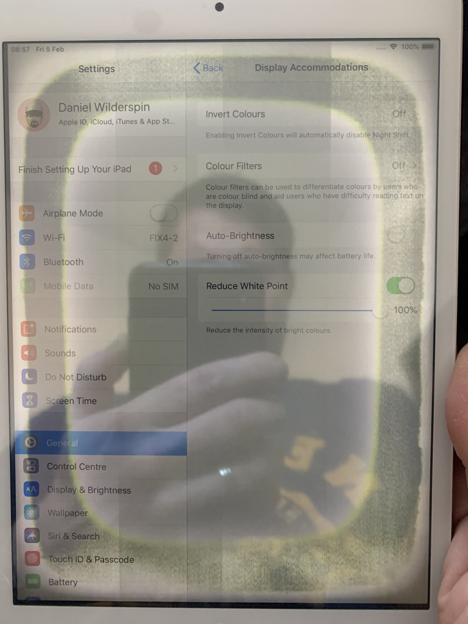

So after nearly 12 hours of screen being on 100% on a white background and not locking the only way I can see this is if I reduce the white b
Point or whatever it’s called. In normal usage it’s absolute fine... iPad is very warm obviously...
Hopefully this fixes it but I fear that as it cools down it will got as it was again...

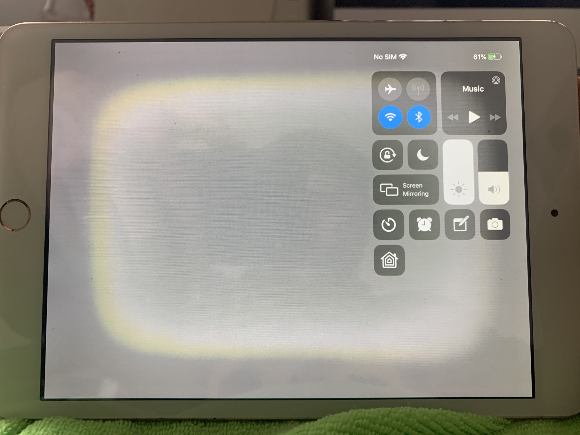

Came down this morning. Turned it on and it was bad again...
Ordered a new lcd and then started getting brutal...
I pulled back the glass and blasted the lcd with a heat gun so hot it went black... when it came back on it was nearly as good as last night it’s weird heat seems to fix it I imagine it will be bad when cool again...

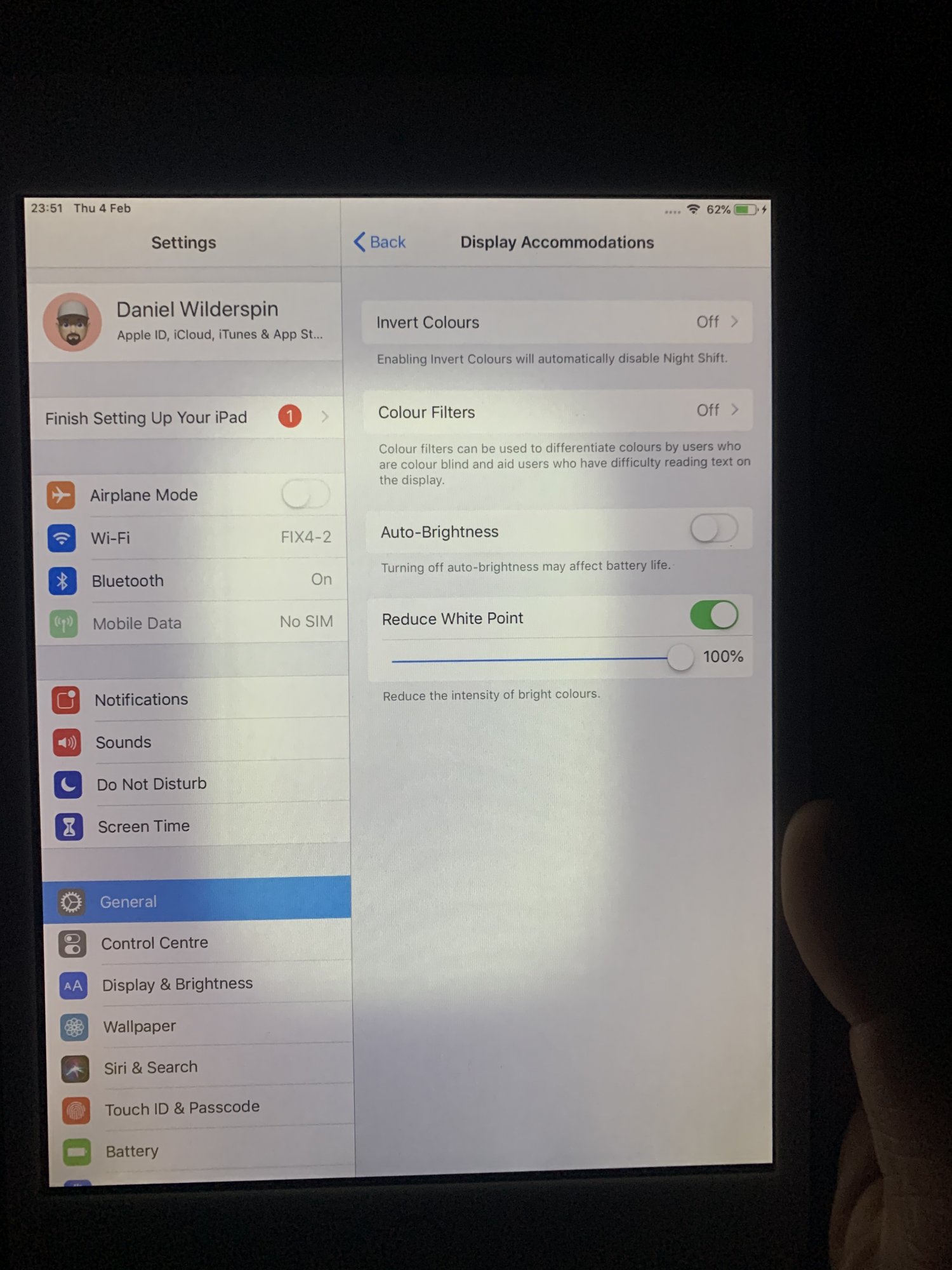

before this morning

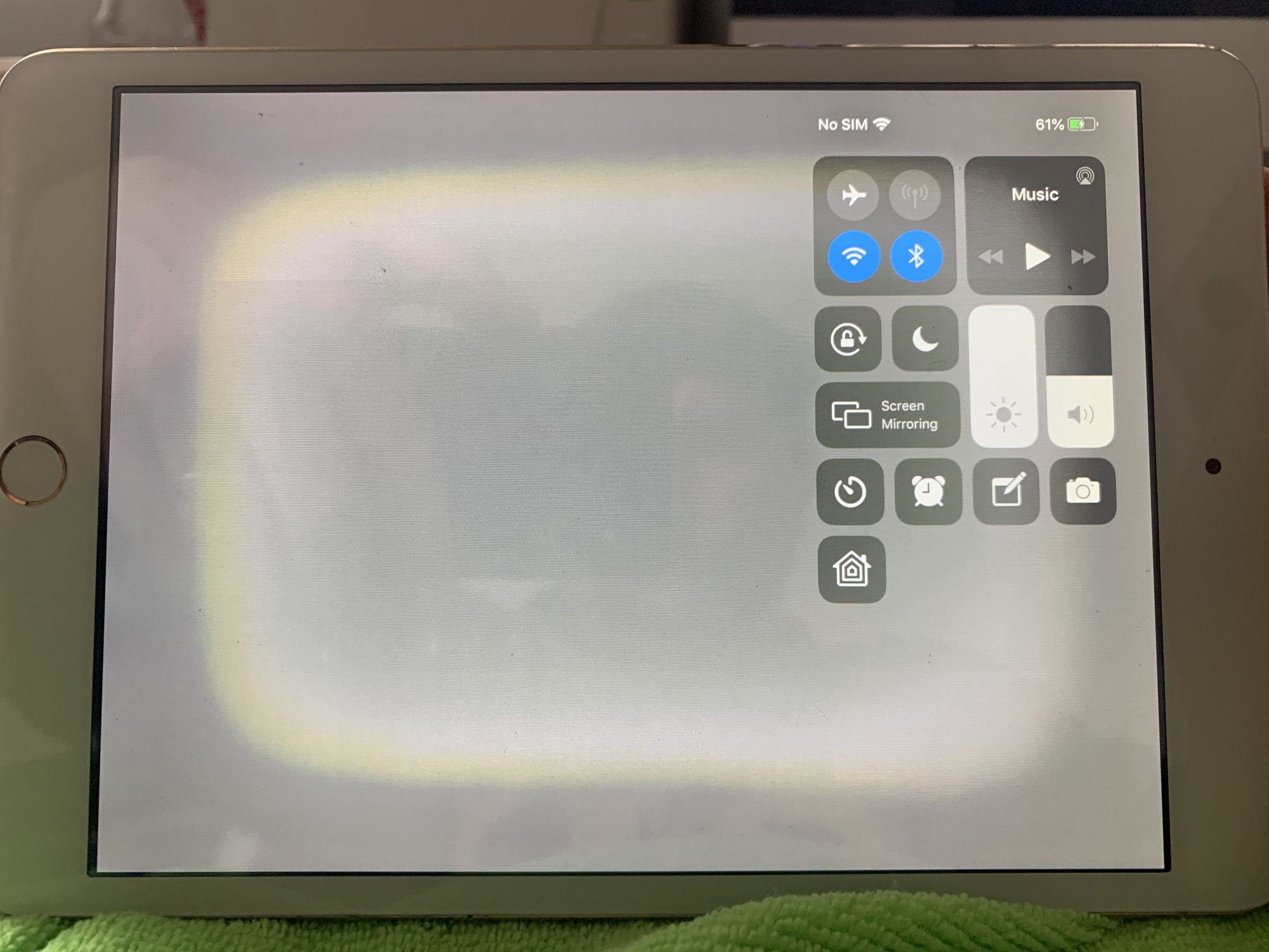

After heatgun
