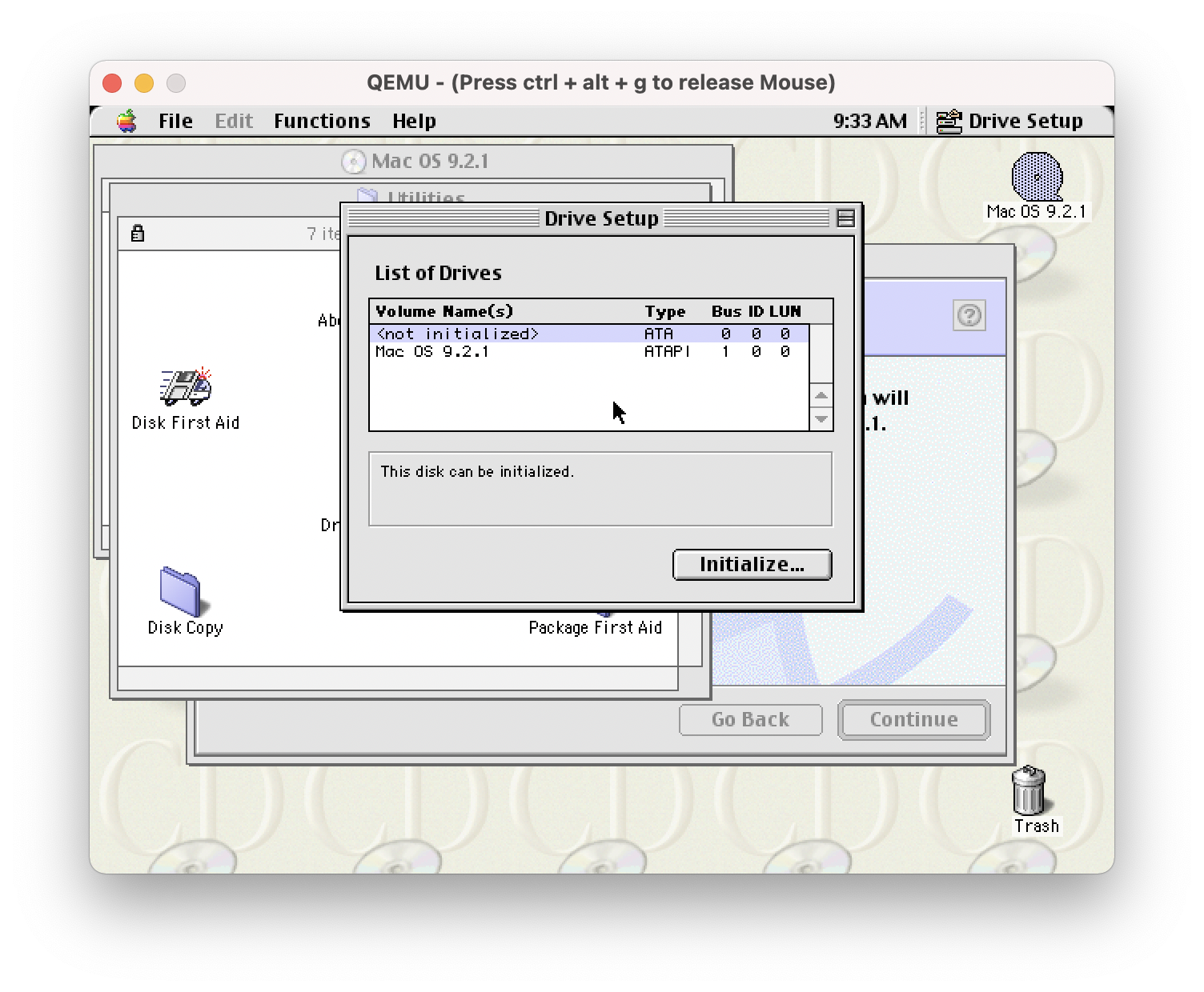

Hey All, I figured this would be of interest, it's pretty frictionless to run PowerPC OSes via QEMU x86. I fully expected more problems. I haven't seen any try this but I would not be surprised if someone here already has.

  3. Run QEMU with newly created image and report as Mac using OpenBIOS, boot of the D drive (Optical), 512 MB of RAM and also include the disk image. You'll need to format the disk. 10.0 doesn't have a disk utility in the installer so you'll need another bootable image that has one.
  4. After installation boot off the C drive where the OS was installed.

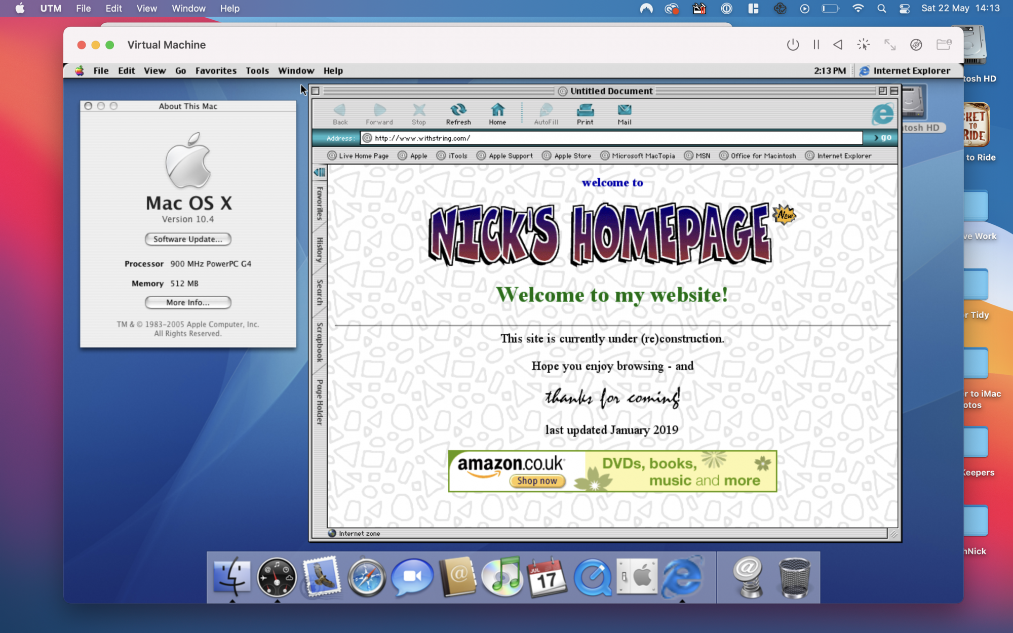

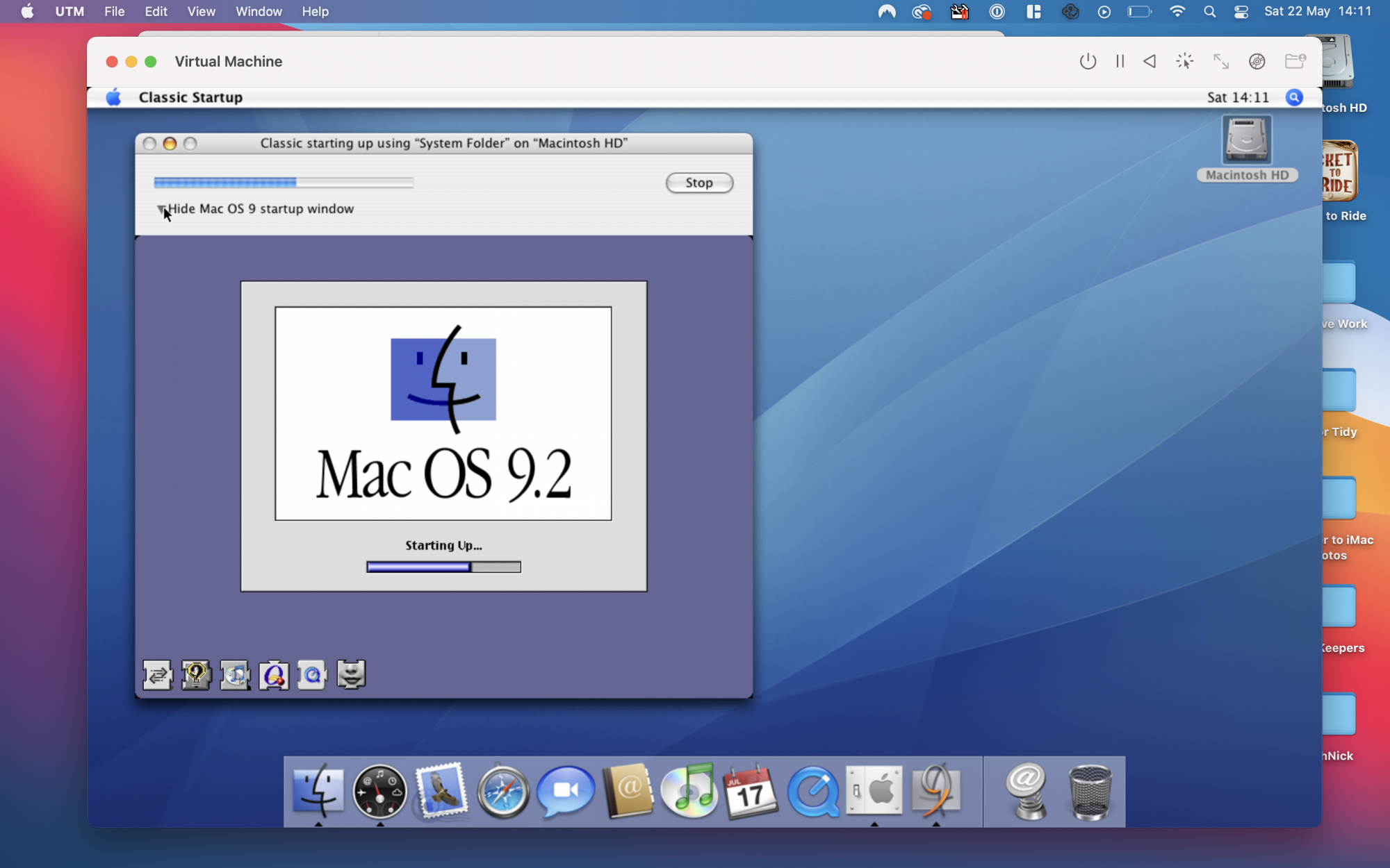

So now I've got:
Mac OS 11 Big Sur...
...running the Intel x86 version of QEMU via Rosetta 2 with the UTM front-end interface...
...emulating a PowerPC G4 PowerMac...
...running MacOS X 10.4 Tiger for PowerPC...
...running classic MacOS 9.2.2 in the Classic Environment compatability layer...
...running Microsoft Internet Explorer 5 for Mac, still able to load my aged website from 1997!
This was quite pointless but it made me very happy!
