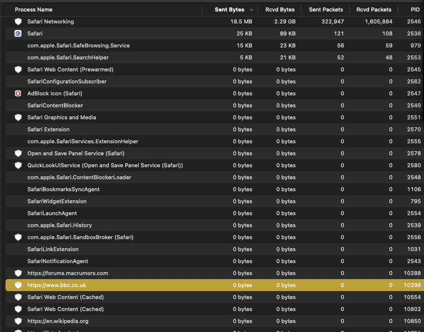

It looks like the websites are listed in the Process Name column of the Network tab of the Activity Monitor
By inspecting the the open file and ports of the process "https://www.bbc.co.uk" (from where I'm streaming a video), via the Activity Monitor interface, I can see in the last line a Unix socket:
->0x226e9a17091057d8
This appears many times on the right hand side of the output of sudo lsof -U
I'm not an expert of Unix domain sockets, but I wonder if all these web connections are channelled through this socket.
Also notice that the actual process which is transferring a lot of data, according to Activity Monitor, is "Safari Networking". I have lsofed its pid
sudo lsof -p 2546
I see the same socket in the output, but still don't understand why this internet connection is so obfuscated (if compared for example to a Firefox process).

Now, it is true that the main process, the one in the top row of my screenshot which is responsible for all the network traffic, seems associated to the command com.apple.WebKit.Networking.
However, what the OP is observing, is that all these Safari processes are not showing any TCP connection, no matter how you run lsof, even without flags. Try:
sudo lsof | grep TCP
no Safari processes.
Now try with Firefox and you will see loads of them.

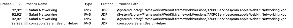

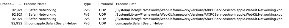

When I look, I see Safari making use of UDP and not TCP. So what you are seeing may be a reflection of the browsers working in different ways. Also that I am using Private Relay.
Here is snippet from PortsMonitor filtered by the term "Safari":
Note the "Process Name" above is the same as given by Activity Monitor, not lsof.
I see the same connections using lsof -i with the process names shown as com.apple. As I see it, lsof is showing the connections - it needs more interpretation/guesswork to understand them.
I really do recommend PortsMonitor.
