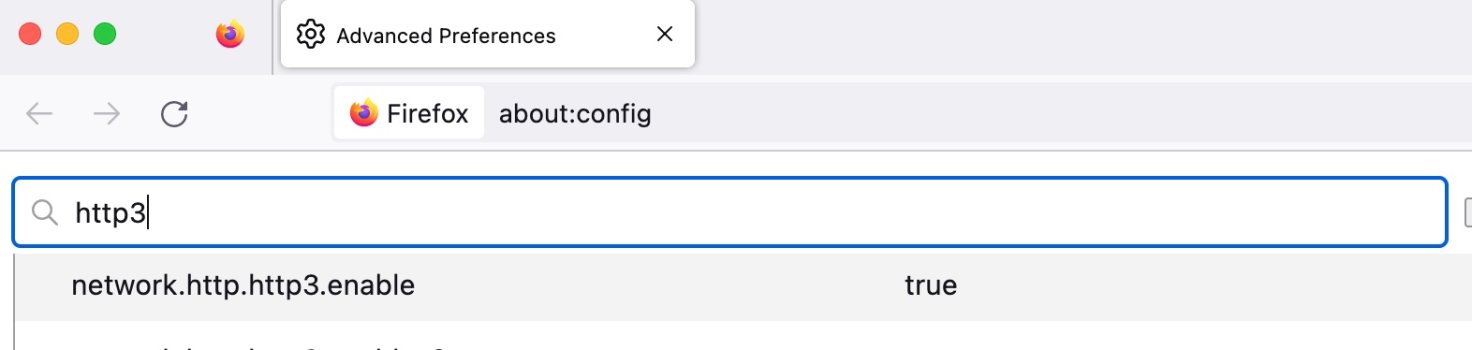

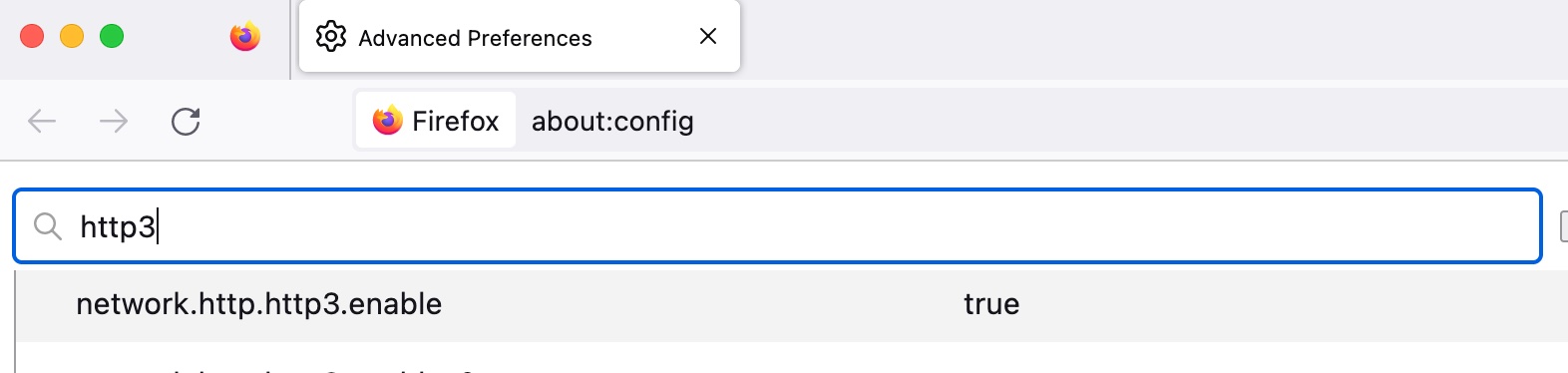

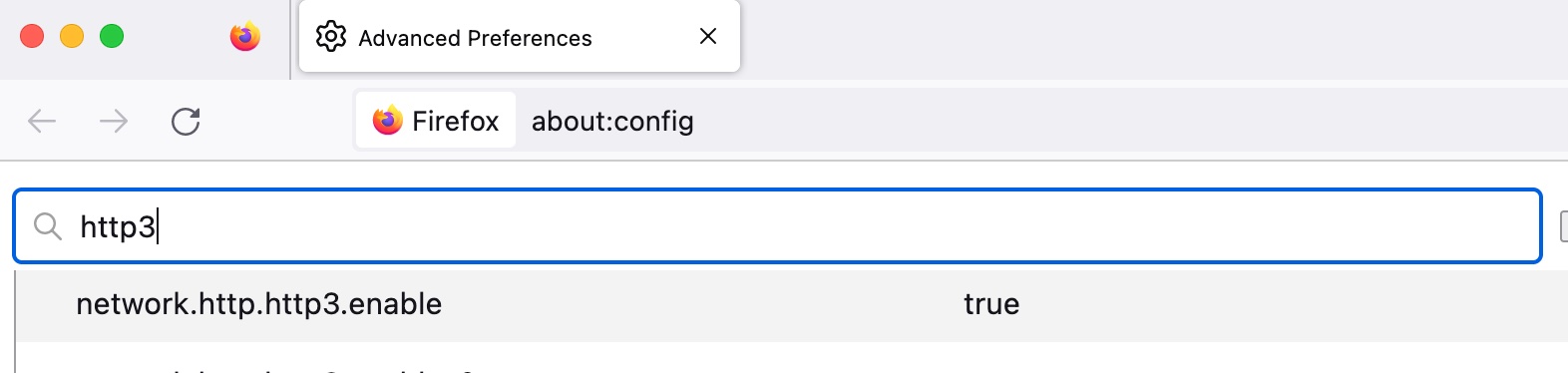

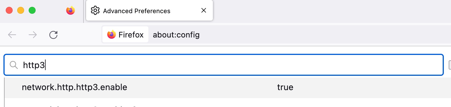

Firefox has an advanced option to disable HTTP/3, but it's enabled by default (on my machine running 118.0.2). Here is the setting.
