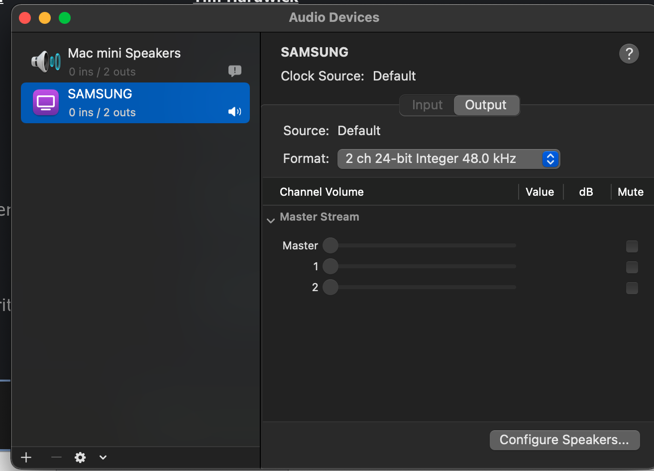

I just bought an M1 Mac Mini. I am trying to plug it into my Samsung 4k display Un55NU7100 via HDMI into the third HDMI port (with ARC). So far all good, image is crisp.
Now I am struggling to figure out how to get surround sound coming out. My surround sound is an old DVD surround sound combo that I mainly use as surround sound through a digital optical cable. It worked great with my only windows computer, but I really wanted to try the M1 mac mini out.
Basically, I imagine that I am trying to take the sound from the mac mini hdmi output and send it to my surround sound. But i seem to fail at getting surround sound. It seems all I can get is a stereo signal sent to my 5.1 speakers.
Audio Midi Setup shows two devices, the mac mini speakers, and Samsung. The samsung device only has two channels, and I can seem to change that.

1. Mac mini HDMI to TV 3rd port, with the TV's optical out to the Surround Sound in.
Result: Stereo sound in the 5.1, Mac Mini reads output as 2 channels
2. Bought a HDMI converter (Auvipal HDMI to HDMI+Audio+ARC). I plugged the mac mini into the converter via HDMI, then another HDMI from the converter to the TV, and from the converter to the surround sound via optical cable.
Result: Stereo sound in the 5.1, Mac Mini still only reads two audio devices, Mac mini speakers and Samsung, with two channels.
In both cases, I've fiddled the samsung setting to Bitstream and PCM, it changed nothing.
I've also tried using the thunderbolt (or is it usd-c) outpuit, plugging the hdmi cable into a usbc/hdmi dongle. No change.

Yes... it had arrived and it took 2 weeks before I was able to try it out...
So, Mac mini M1 16 GB.
Goal: have 4K display on SamsungTV, and surround sound via Sony AVR audio set.
Mac mini via HDMI to TV, and TV via optical cable to surround AVR, this did not work: Stereo sound was no issue, but no 5.1 surround possible. Audio MIDI setup only recognises 2 channels.
The surround AVR does not support 4K (only up to 1080p), so display through AVR won't show 4K.
Only 1 solution worked for my setup:
  • Mac mini M1 hooked up to Samsung TV for the 4K display (with HDR) via HDMI directly.
  • Mac mini M1 hooked up to Sony Surround AVR through Thunderbolt 3-> HDMI adapter (Apple's one).
  • Audio MIDI setup recognises all the channels, was able to setup 5.1 audio fine.
  • Needed the nightly build of VLC 4.xx for native support of M1.
So, I am happy. It works for me.
