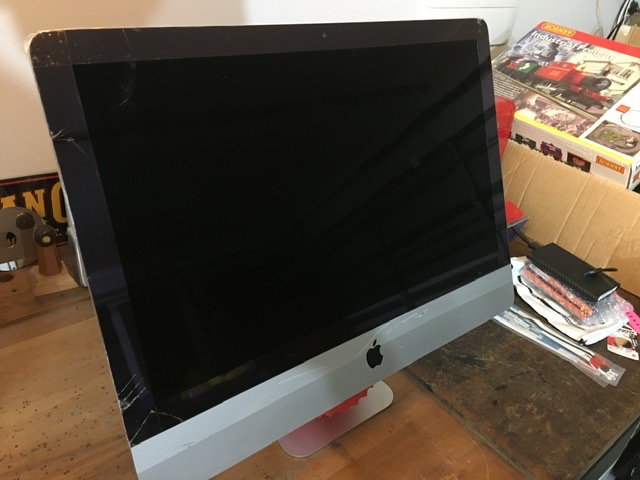

I picked up a late 2015 iMac (1080p non-retina i5-5575R @ 2.80GHz) cheap as the display glass had cracked and the screen had been taped onto the aluminium chassis. My hope was to swap the screen out with the one which was flawless on my late 2013 iMac (1080p i5 4570S @ 2.9GHz).

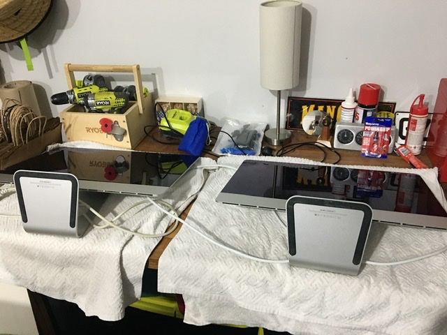

So I bought the replacement adhesive strips and got to work removing the screens. Thankfully the cracked screen didn’t totally fall apart when I removed the tape and most of the damage was contained to near the border.

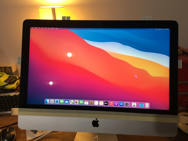

I worked out that I needed to swap the internal LCD display cable (LVDS cable) as the connector on the late 2013 iMac logic board was a different width (and possibly different number of pins? I didn’t count) to the connector on the late 2015 iMac. Thankfully the connector on the LCD panel itself was the same.
I plugged in the swapped LCD display cable and LCD power cable and they both booted and worked perfectly. So yes, I was able to swap out the damaged screen on my late 2015 (non-retina) iMac with my late 2013 iMac.

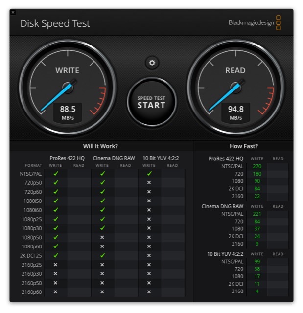

Original HGST 1TB SATA HDD 5400RPM - Internal

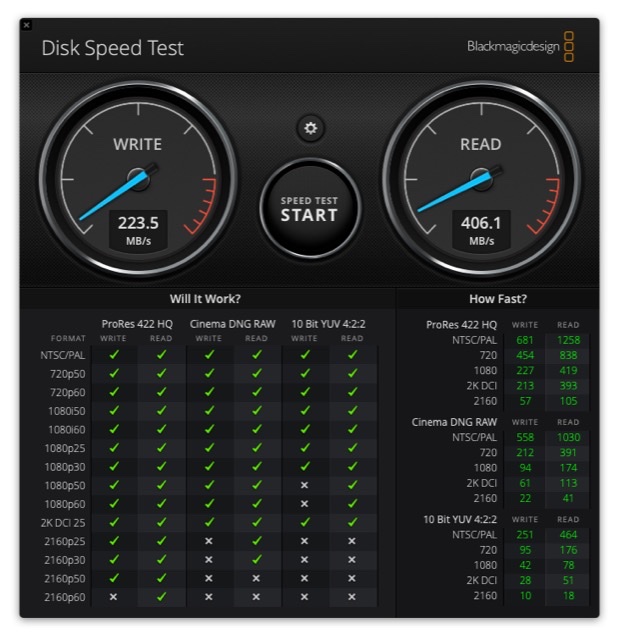

Samsung 128Gb SATA (6.0GHz) SSD - Internal
So you can see the SSD has a substantial speed increase from the spinning hard drive whether internally or externally connected. There is a slight increase in speed by connecting the SSD internally but only in my case by a small percentage - +3% write and +7% read.
