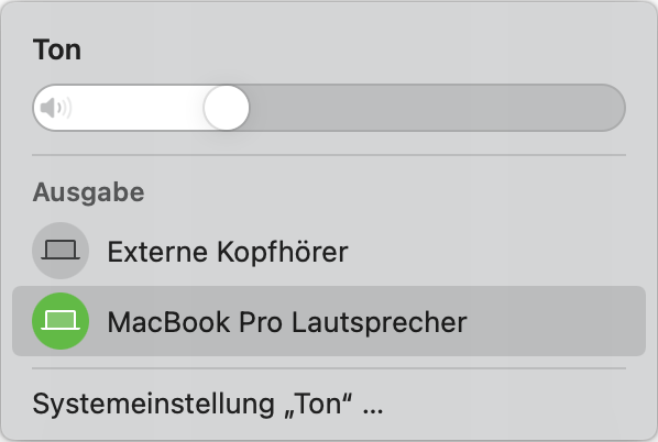

Simply select the internal speakers by clicking the menu bar icon or the sound section in the control center.
Not even a right-click is necessary nowadays.
I'd be really surprised if the internal speakers would be physically disconnected on an iMac as it works for all of my MacBooks and Mac Pros.
What I cannot do is, select the headphone port *unless* something is plugged in.
When I plug in headphones, then headphones replace the internal speakers in the list, and the internal speakers do not exist until I unplug the headphones. This is a Mac mini.
