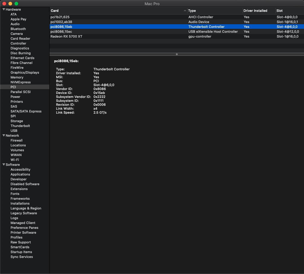

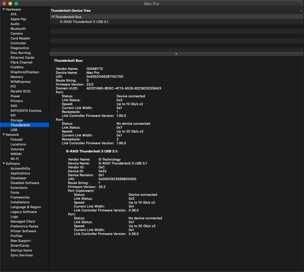

Well the guy who sold it to me is advertising teh card to be working and used in a MacPro 5.1.
The cards work as you’ll see in the picture, it is pretty much plug and play.
I’m just wondering given it is in a PCI-e Slot 2.0 how much speed sacrifice I should have.

I'm not sure why you expect more than 360 MB/s. The specs say 440 MB/s max.
Show us the info for the AHCI controller pci1b21,625. It's probably some low bandwidth raid controller PCIe 2.0 x1 or something like that.
Then show us the info for the drives you have installed in the RAID. The RAID only supports two drives. If you have two 7200 RPM HDs, then 360 MB/s seems reasonable.

@joevt The external drive i got was borrowed from a friend for testing the card and i just realize it is indeed a 2x HDD Raid 0 so as you stated 360MB/s is most likely ok. I will borrow a Promise Pegasus 4x HDD Raid 0 and test again.
