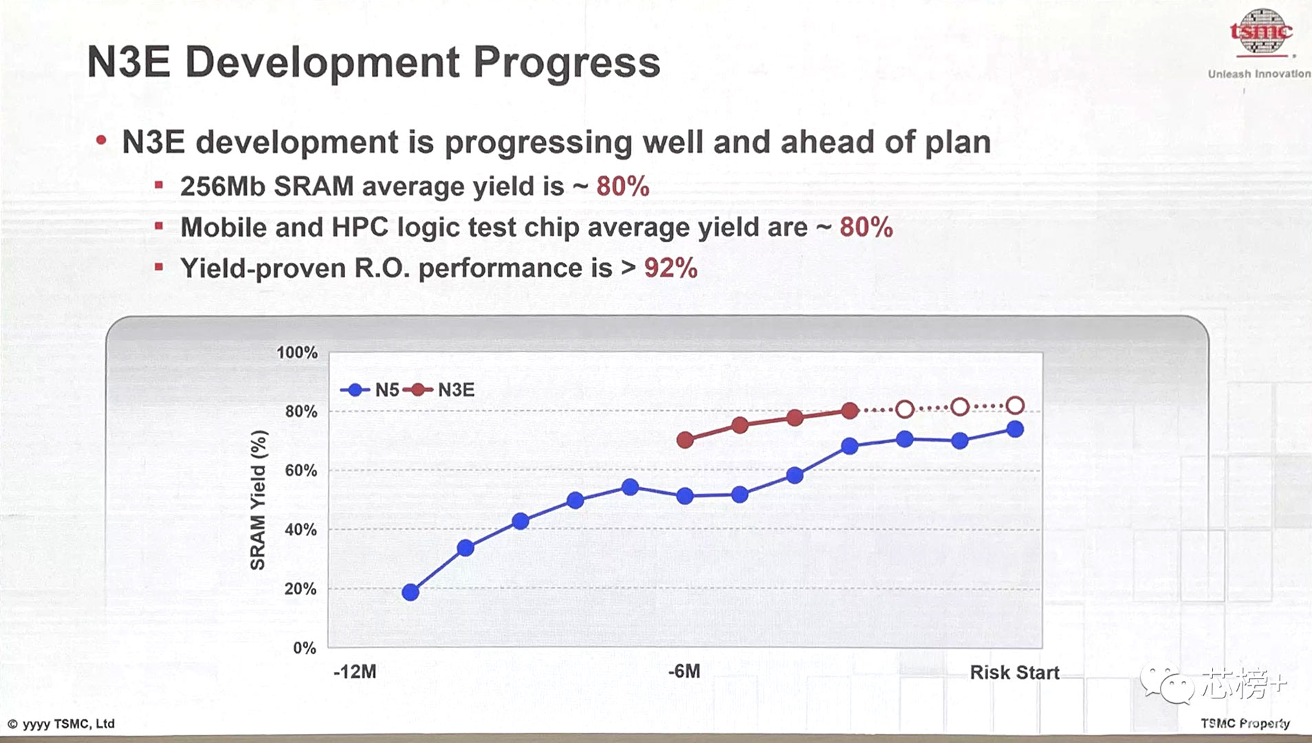

How does N3E improve on N3?
This process node will introduce an improved process window with performance, power, and yield enhancements. It is unclear whether N3 meets TSMC's expectations for PPA and yield, but the very fact that the foundry is talking about improving yields indicates that there is a way to improve it beyond traditional yield boosting methods.
"We also introduced N3E as an extension of our N3 family," said Wei. "N3E will feature improved manufacturing process window with better performance, power and yield. Volume production of N3E is scheduled for one year after N3." ..."
Not sure if that means reducing FlexFin variability ( trading off flexibility to boost yields) or just more EUV layers and process tweaks/optimizations. N3E has better performance , power , and yield but not area. There is an implication that they may back off the density a bit. If the manufacturing is a bit less complex, then the number of defects can go down a bit. Also may have slightly shorter "bake" times.
What is being measured in the chart above is the defects for SRAM. The best FinFet SRAM isn't necessarily the best one for computational core logic. The "Enhanced" aspect is likely for a specific subset of folks; not generally a better for everybody than N3 upgrade.
Regardless it won't be surprising to see a fair number of customers just skip N3 altogether. Especially, if they just relatively recently arrived on N5/5P/4/4P. Waiting on N3E means better yields (depending upon logic/SRAM/analog mix of chip design) and potentially lower costs. N3 and N3E likely have substantively higher wafer costs , so drops in yield is a bigger 'penalty' costs than with more affordable wafers. ( unless can charge above average prices for your chips, waiting likely pays better. . )
Likely to be a N3X , N3P , and if N2 has a short stall some other N3 alphabet suffix.
Reactions: altaic

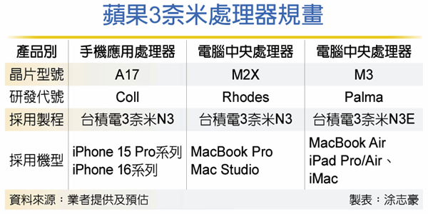

Commercial Times reports that the M2 Pro/Max will use N3 and the M3, N3E.
deconstruct60
macrumors G5
Mar 10, 2009
12,493
4,053
Apple just started core design work on M3 and launches in 10 months later. Errrr. either is there is a different "design work" definition there or that is just likely wrong. The pipeline on doing a new processor is not that short. Whatever is coming in 2023 has been in design effort mode well before now.
If there is a new architecture update for the A17 then there is pretty good chance the M3 is coupled to that. N3E schedule didn't move up until relatively recently. Given the long term planning that needs to be done N3E wouldn't have been timeline compatible with A17 anymore more than N3 was compatible with A16( and likely hence M3 ). N3E was suppose to be a year after N3. Target was 2H 2023 which is too late. That it may start ealier than that is likely too late for A17.
If during development A17/M3 turned out to be a very bad fit for TSMC N3 then switching to N3E would cause a small slide out in timeline which again would make it tough to be 2023. ( In fact once into the wcc article even they says "stick with 2024" for the M3. )
I wouldn't beat the farm on this articles. They appear to be structured to make impatient people looking for M-series updates to click on them.
Reactions: Xiao_Xi
Could A17 use N3E if volume production of N3E were to start in Q2 2023? Morgan Stanley reported that:
Our recent checks with equipment vendors suggest that TSMC may freeze the N3E process flow sooner — by the end of this March. This means that volume production of N3E may start in in Q2 2023, around a quarter ahead of the original schedule of Q3 2023.
Morgan Stanley also reported that:
The test production yield is much higher for N3E than N3B. Our checks suggest that the logic density of N3E is only ~8% less than that of the original N3 by cutting four EUV layers, yet it is still 60% denser than 5nm.
I couldn't find the Morgan Stanley report, so quotes are from:
Likely not if Apple didn't plan for that 1-2 years ago. Don't "change horses" in last 6-8 months of the development cycle. (or if you do you get substantive delays .... e.g, Intel Ponte Vechicco which swapped out an Intel Tile for a TSMC tile about half way through. )
Screw up the iPhone and Apple stock would drop significantly. That is a somewhat risky move for a product that is a make or break product for the companies financials. iPhones come out every year but it doesn't take less than a year to develop a new iPhone. The iPhone development efforts are on overlapping pipelines that span more than 12 months. There are tons of external certifications to do and several significant parts beside the SoC to coordinate supply chain with.
In contrast, if Apple take a winger on the Mac Pro Apple Silicon model and it missed for 1-3 quarters , that would have about zero impact on Apple's overall financials. There they can afford to gamble a bit. If the larger , far higher priced (to the consumer) Mac Pro die served as a 'pipe cleaner' for the N3 process then A17 would likely be in good shape yield wise.
The N3E high volume date moving forward primarily only helps those designs that were targeting N3E in the first place all along. (but for many of those systems the design was going into.. perhaps not as much if the logistic train of the rest of the parts cannot also move back in HVM time. ) It also probably helps some folks who waiting for more information to get started. Unlikely Apple was in either of those states.
.. density of N3E is only ~8% less than that of the original N3 by cutting four EUV layers, ...
If those four layers are cut and no other DUV or layer is needed then the "bake" time for these is going to be shorter. I don't think Apple is likely highly pressed about the bake times as long as they can queue up wafers far enough in advance and get enough volume of wafers going. It is expensive, but in the aggregate Apple is charging the customers lots of money to cover it.
The FlexFin gaps are about 20% wide so I suspect that feature would be on shaky ground in N3E (at least with 3 target options). If trim off the most dense one then still would have two target options. The least dense FlexFin option wasn't that far away from N4P. So it isn't all the surprising that N3E went very smoothly after getting N3 to work. There is already a less dense FinFet in N3 as an option.
