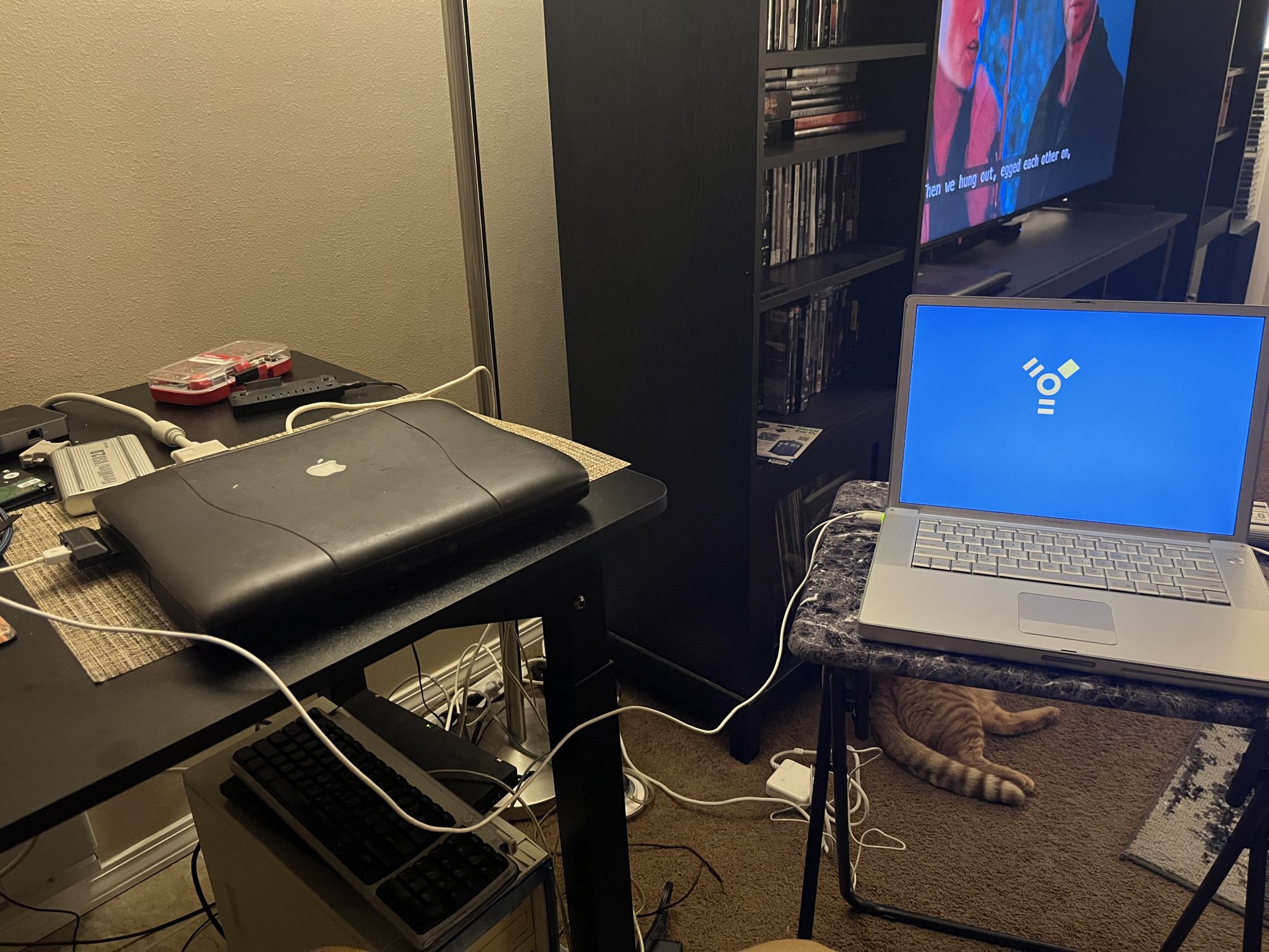

I forgot I had a FireWire PCMCIA card laying around. I booted up Jaguar and stuck it in there, having no idea if it worked or if it was even compatible.
Turns out it’s compatible and works.
To explain what’s going on here..
I knew there was no way it would boot off that FireWire card, but I thought I’d try anyway because what else am I doing with my Saturday night. Xpostfacto supports using a “helper” drive which, as far as I can gather boots the system from that drive, and then bootstraps over to the one with the actual OS X installation. Well that worked using this FireWire card. So here we are booted from Tiger on the internal SSD on my PowerBook G4 over FireWire on a Lombard.

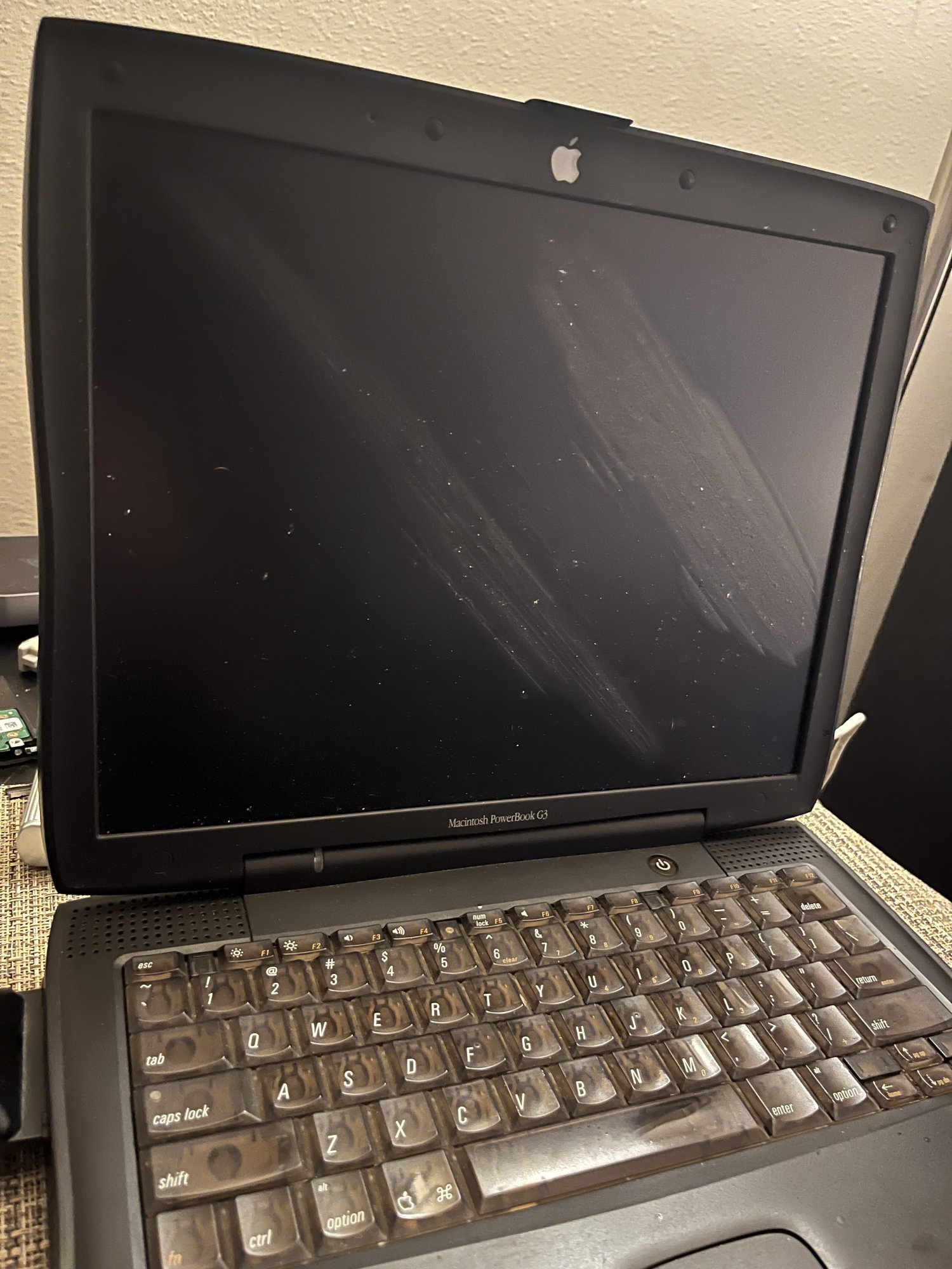

The internal display works, but it’s got this terrible scratch/tearing all over it, plus a solid line of dead pixels on the left side. Hence why it’s hooked up to this monitor.
The internal fan doesn’t work, so I’m trying to limit my usage of it til I find a replacement. The battery on the other hand does work, though I haven’t tested for how long.

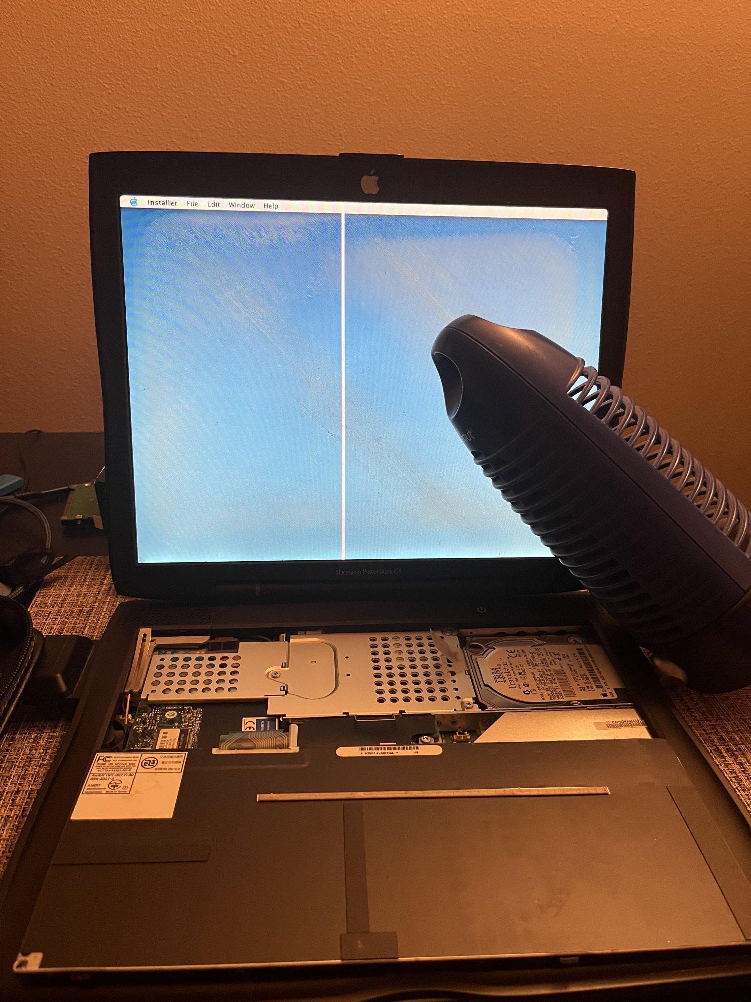

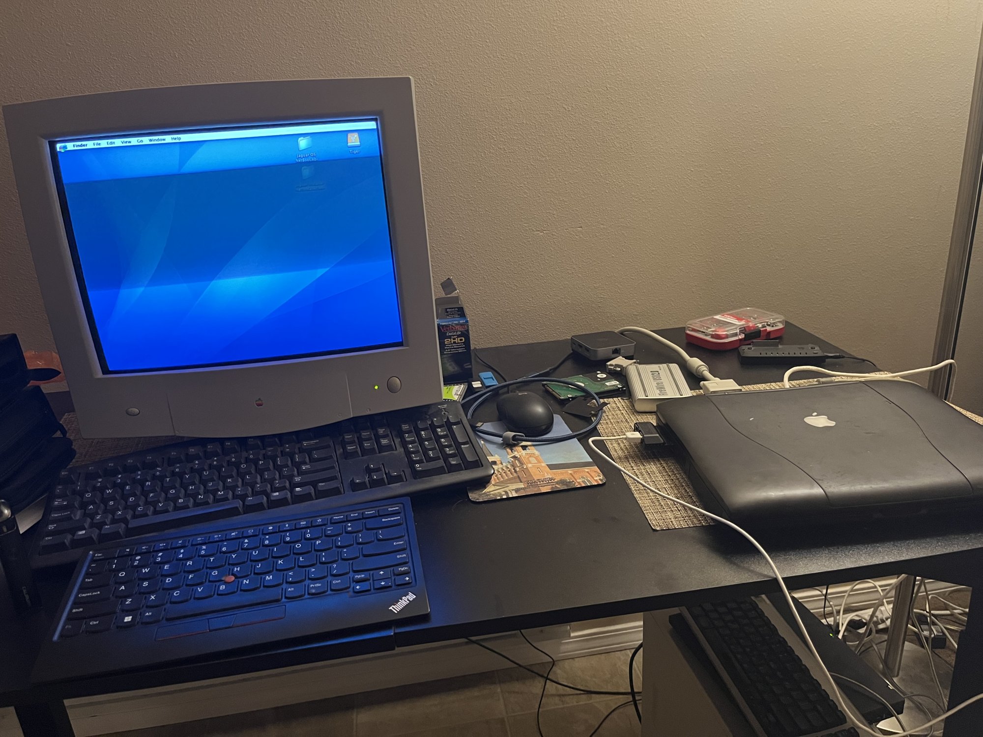

Now that I’ve got the drive imaged and erased, I’m having a hell of a time getting Tiger installed.
Congrats on getting XPostFacto to cooperate with the card drive. Sometimes it's like SCSI Voodoo in what it chooses to play with and when, and I've wasted many an hour in just getting it to do basic supported stuff.
it’s got a DVD drive (actually I stuck the one from my Pismo in it because the one it had was intermittent)
And, with a fresh install of OS 9, using XPF to boot the Tiger DVD is resulting in the prohibitory symbol.
I’ve just installed Panther and am going to try using XPF from within it instead. But if all else fails I’ll just grab a bigger HDD than the 6GB factory one it has and pre-install it with Tiger and put it in since Lombards don’t actually need patched to run it if it’s installed.
