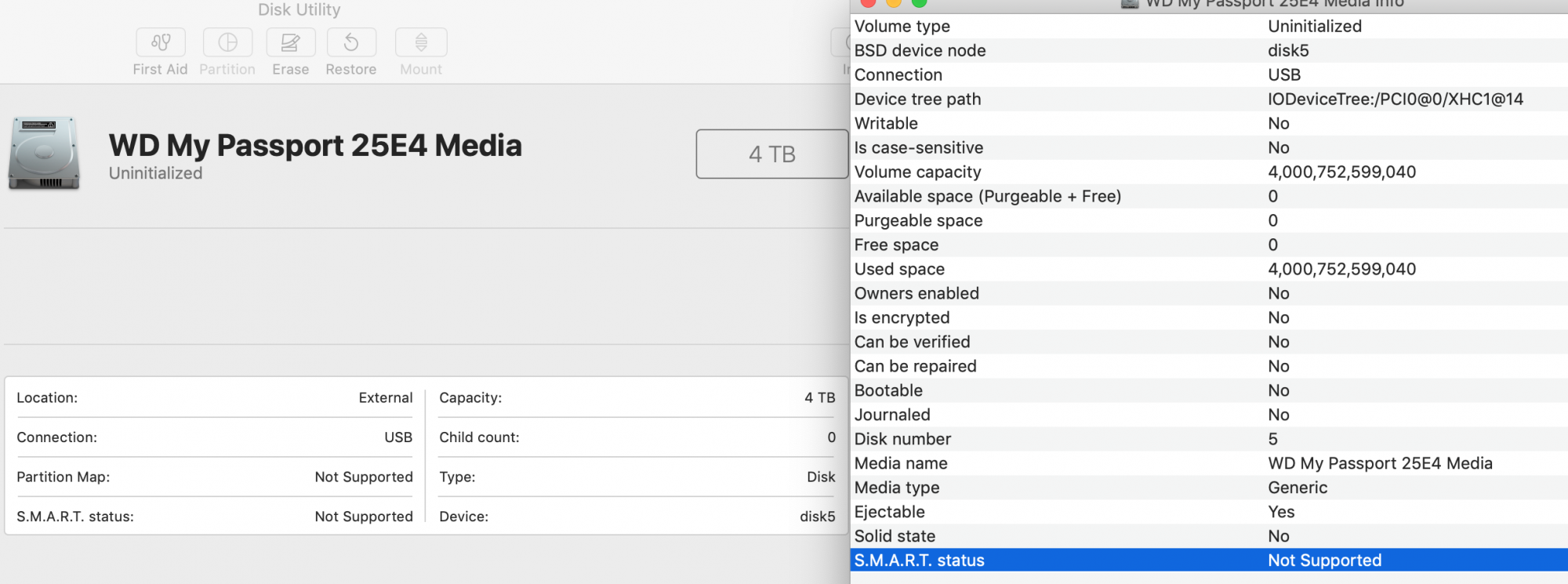

Hello all,
I have a 4TB drive that I have been using for about one year and half. It worked fine until this morning, when I unplugged it after selecting Force Eject and plugged it in again, it shows "The dish you inserted was not readable by this computer". Both my macbook and iMac indicated same message, and my other hard drive was read just fine. So I think this is a hard drive issue.
Now my Disk Utility indicates that this disk is now "uninitialized", and there is no partition map. What I tried:
1. First Aid repair on Disk Utility - said the operation was successful within 1 second of the repair, but it still shows as uninitialized.
2. Recover with Disk Drill - Disk Drill Recover could not get any files from the drive.

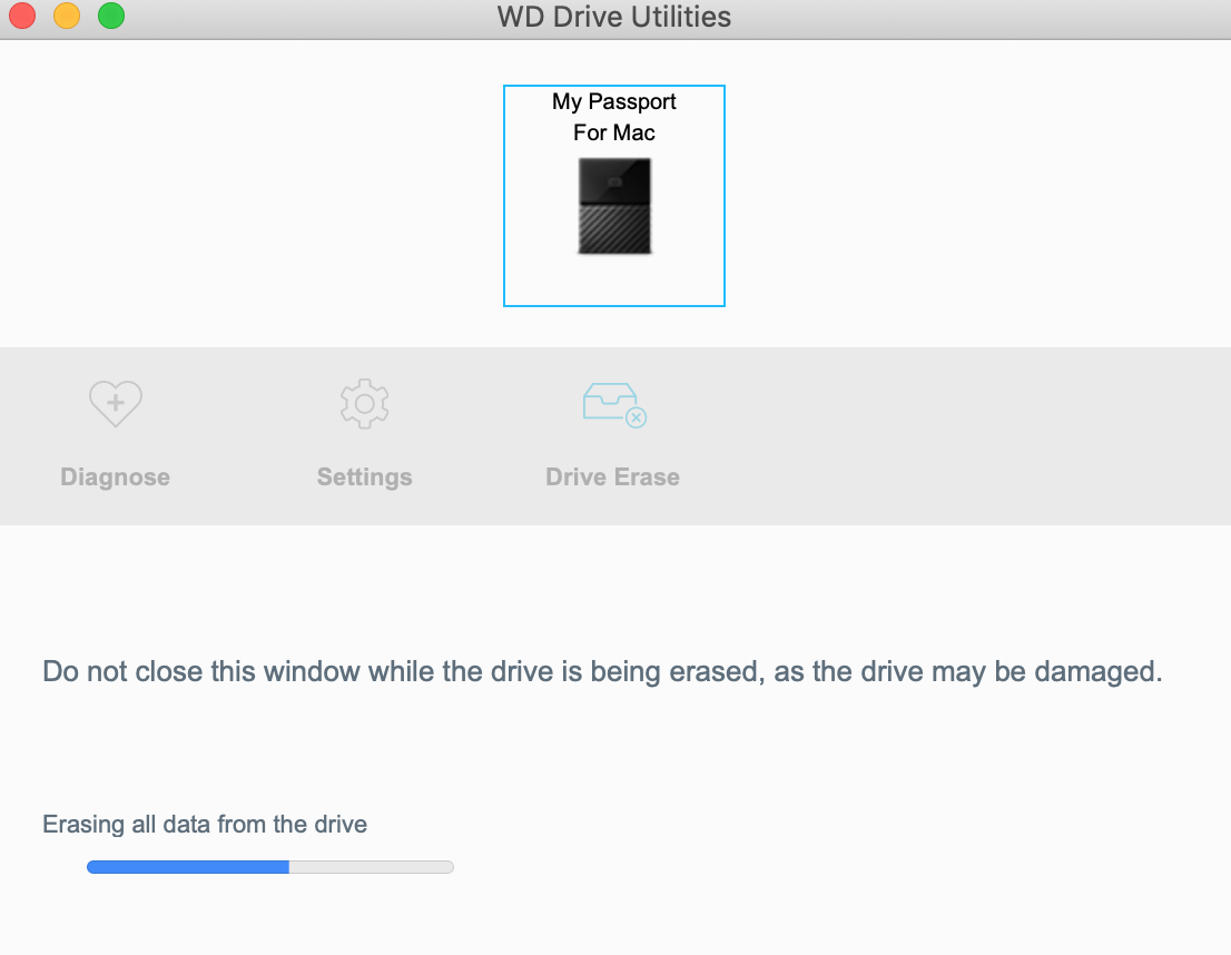

Thanks for the suggestion. I turned macbook off, unplugged my drive, and turned macbook back on.Then I plugged in and waited for 30mins, but now the drive is not shown up. Here is what I tried when I could still see the drive on Disk Utility:
1. I tried to erase data, but it shows that "Unable to write to the last block of the device" and could not erase the disk.
2. This is a WD drive, so I went to www.wd.com and download "WD Drive Utilities" software. The software gives me an option to erase the drive. I selected Drive Erase option and it is shown to be erasing files.
But the entire time (when performing Drive Erase, as well as earlier actions with Disk Utility), I did not hear any sound from the hard drive. Is that considered normal for a functioning hard drive? I have seen some said that if it is not spinning, it might have underwent a voltage spike and need to change PCB (Link to the suggested issue: https://www.cleverfiles.com/help/external-hard-drive-recovery.html).
